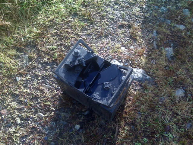

Thursday late evening I had gone to bed and was drifting off to sleep when there was an enormous explosion at the front of the house
So I lay there thinking about it - remembered the battery I'd put on charge on the Sunday - calculated that the battery would now be 'open circuit'
and therefore not taking any current... so I didn't need to get up and do anything about it
Following day I flipped the bonnet on the Maxi - I found the battery posts still connected to the wiring - and nothing else - a few bits of black battery casing in powder form - nothing bigger than a couple of millimetres
All that lead - where the hell did it go

Angle grinders eh - what are they likeThis is what was left of the battery,
