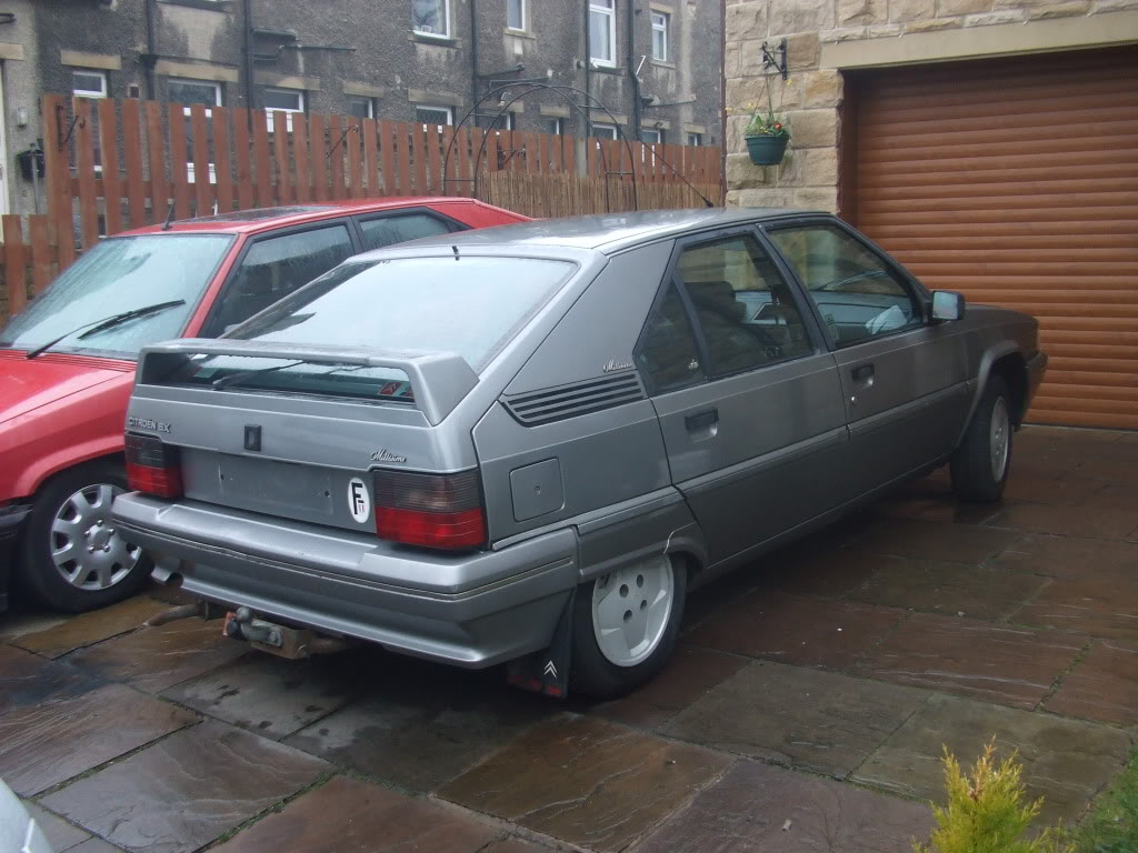

Well its home safe and sound and on the drive. Ive pressure washed it down but it was starting to get dark so gave it up till the morning. Wont start and theres no clutch (pedal to the floor) so im hoping its just the cable.

Bought some battery terminals this morning,put a battery on and she fired straight up,pumped up and sounds lovely.
Downside is i thought i could get away with a clutch cable as the pedal is on the floor but closer inspection i think the clutch may have collapsed.

Dont know for sure.How can i tell if the fork has failed without yanking the gearbox out anyway ?Clutch "arm" can be freely moved back and forth with no apparent clutch pressure by hand.Cable hasnt failed which was my 1st idea.

That sounds like the release bearing has gone through the fingers on the clutch pressure plate.
If it has, or hasn't it still means pulling the gearbox out.
Get yourself a complete clutch kit, as if you are going to this much trouble, you don't want to repeat it again in a hurry!
