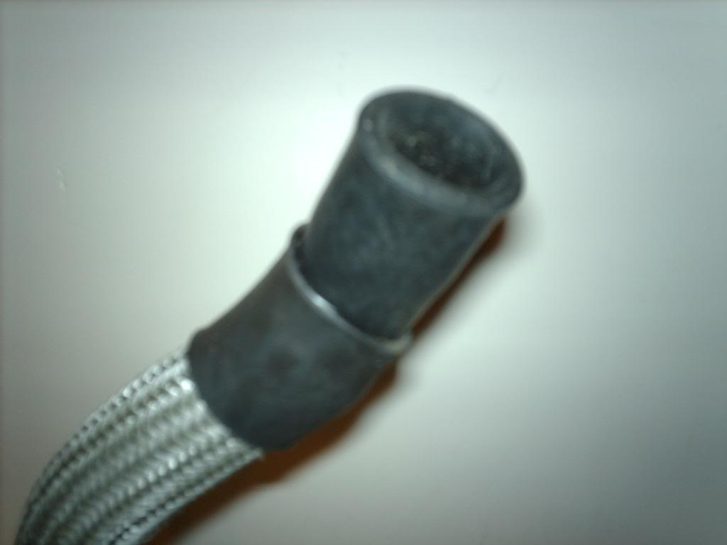

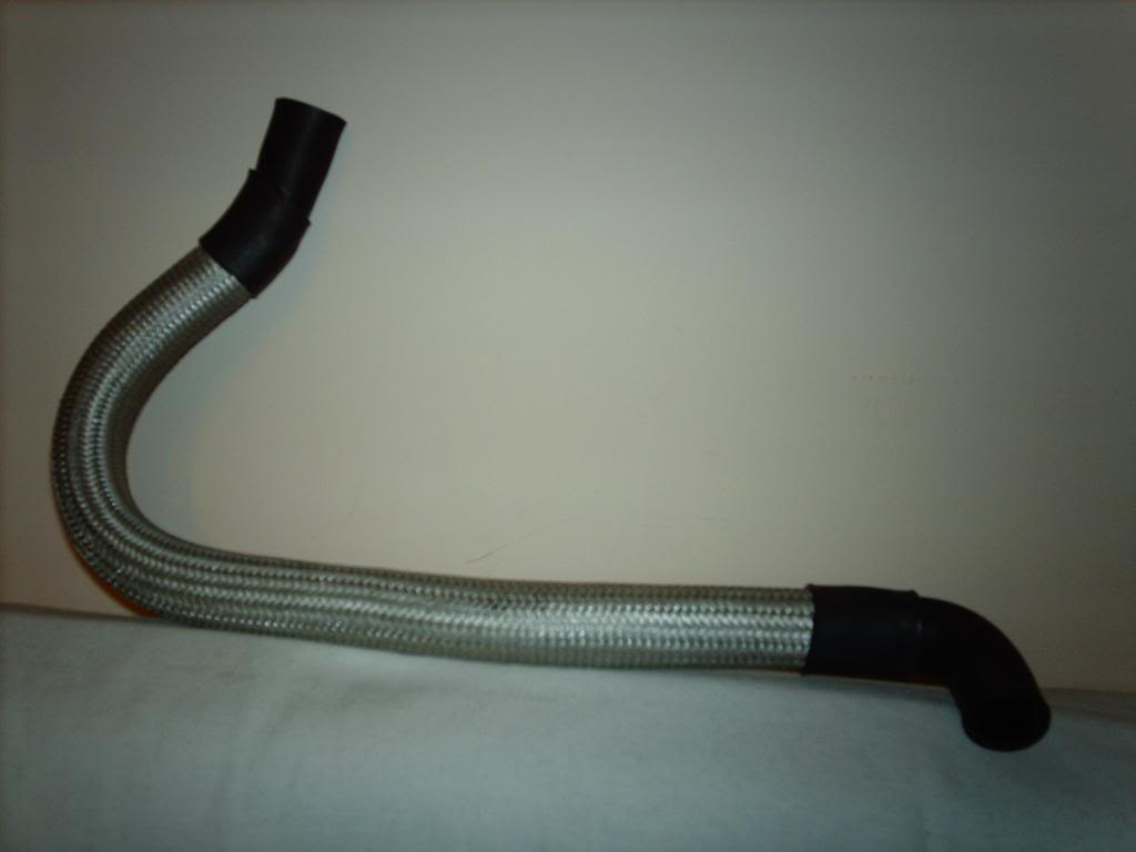

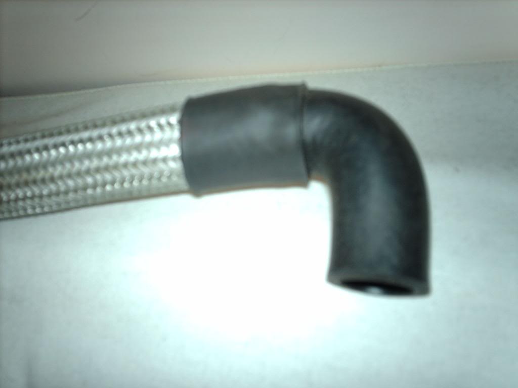

But I do have a new braided water hose for a BX/TD available if you need it, I'm not sure what the part No. is (It's Possibly #7 /\ ) but IIRC its the one which goes from the back of the block and across to the feed into the heater/matrix!
