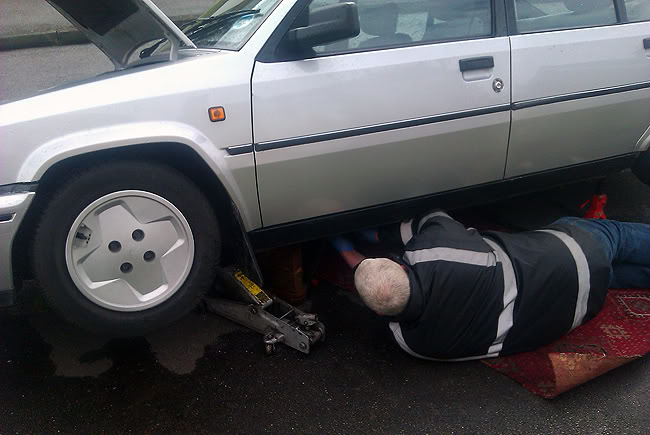

I managed to get the TGD sorted out today, many thanks to Shaun. There was just one tiny hole around the plastic bracket that keeps the pipes in place (obviously a moisture trap). The rest of the pipework all looked in pretty good order as it had been carefully greased by the previous owner. We thought we'ed have a look though, just in case I did happen to be sitting on a ticking time bomb of nuclear proportions (you never know!). I'm not though.
There is another length just behind the repair that's looking a bit crispy in a couple of places (it hadn't been greased for some reason) so I've arranged to get that replaced over the summer.
We had a bit of laugh about the 'chisel near the gearbox' saga; 'what kind of an idiot would leave their tools in the engine bay again?' etc. etc. Anyway, after Shaun had gone I decided to check the oil level ready for the X rally tomorrow . . . he's also missing a junior hacksaw now as well as a chisel!! :D :D

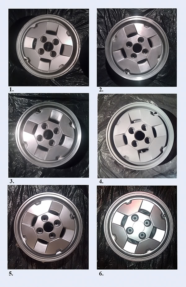

I've just about finished refurbing a couple of speedlines for my Hurricane (a couple were a bit blistery and 'dinked') and thought I'd post up how I went about it in case anyone else wants to have a bash.
It's a fairly lengthy process and probably not for the faint hearted but it's cost me about 50 quid in materials to refurb two, with enough 'stuff' left over to refurb two more. I imagine a bodyshop would charge 300 - 400 quid or thereabouts for a full refurb so it does save a few bob (well, it didn't save me any - I didn't have it in the first place!). There's also the added pleasure of saying 'I did that', just like in that crappy B&Q advert.
The first pic is the original wheel (except it isn't - I forgot to photograph the one I refurbed. That's a 6J I just gave to Mulley for his TXD that I bought by mistake before I realised speedlines come in different sizes [whoops :shock: ]. I posted it for the sake of 'completeness'; the one I refurbed was a bit more knackered than that).
The first job (pic.2) was to strip the old paint off. I did this with Nitromors, which should more correctly be called the Devils bile, as it's filthy stuff. It took me about an evening to strip the paint, taking a bit more off with each application until I was back to bare alloy.
The kerb dinks were taken off with a diamond tipped file then sanded - any other dinks and pits that couldn't be filed away were filled with Isopon 'new metal'. The whole thing was then finished and polished with wire wool to give a good priming surface (pic.3)
The whole upper surface was then primed (I masked off a couple of inches below the rim) with an etch primer (pic.4). If you use an ordinary primer it will just slide off alloy - not good! I applied about 6 or 7 light coats then prepped the surface for painting with 1200 grit wet and dry (being very careful not to expose any metal on the leading edges). I allowed 24hrs at least for the primer to dry before painting.
Next came the base/paint coat. I used Lechler 2K base coat; 'silver 61092' which is a perfect match for the silver paint used on Citroen alloys. Again, this was applied in 6 or 7 light coats drying off with a hair dryer and allowing 15 minutes or so between coats (infact it's a good idea to keep the whole paint surface warm and warm the paint in hot [ish] water as it flows far better I've found).
When the base coat was complete and allowed to dry for 48hrs it was matted back with 800 then 1200 wet & dry. This was easy enough on the flat surfaces but I left some of the nooks and crannies as I couldn't afford to risk taking it back to primer or metal; any residual 'roughness' can be polished out anyway.
For the lacquer coat I used Halfords 'PU' polyurethane lacquer for alloy wheels, which is much harder than a normal acrylic lacquer. I did buy some 2pack lacquer which is perhaps better, but once its activated it goes off in the tin in 7 hours; that would have meant wasting nearly 15 quids worth of good lacquer so that's saved for the 'factory' alloys I'm refurbing for the TGD.
The lacquer was applied with a light 'flash coat' then 2 full coats (with a couple of hours between each coat as PU dries much more slowly than acrylic). The whole thng just needs polishing now (for that, babys bum/freshly buttered banister/ just left the factory/ silky smoothness!! yum! 8) (pics of wheel on car to follow when it stops bloody raining!)
I also managed to buy a brand new centre cap off Robert 'XM' Smart which saved me the job of refurbing the old one.
Like I said, it is a bit what you might call 'labour intensive' (!), but VERY satisfying once they're finished.

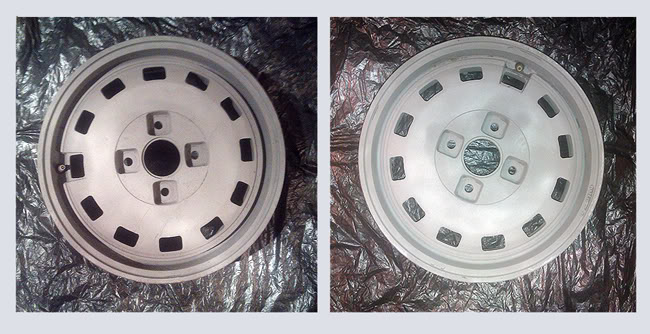

I got my 'factory' alloys back from the sand blasting man today (I'm not quite sure why they're called factory alloys; they were made in a factory, so it's reasonable enough I suppose). They originally came from the blue TZD that Patrick Rugg was selling a while back and to be honest they were in a bit of a state (as Tim will testify). Anyway, I couldn't face interminable evenings and God knows how many family size tins of Nitromors, so managed to negotiate a cheap sand blasting deal with a mate of mine. They've come up really well. One has a big kerb mark across it (first pic), but this can easily be filed out or filled, while the other three are really tidy. I'm not sure that they can be polished back to their original condition, but should look good with a nice paint/ lacquer job.
They did look like this . . .
And the plan is to get them looking like this . . .

I had a good session on the factory alloys last night (Miles Davis, cup o' tea and the heady tang of cellulose - luvly!). Once I got all the sand blasting gunk ground back it revealed just how badly pitted they are. Consequently, quite a bit of remedial filling needed doing.
I managed to get a 'revealer' coat of etch primer on so I could see where there were still a few faults. There's still one or two but nothing that can't be sorted. I'm going to be SO all 'wheeled out' by the time this lot is finished! :shock:

Just one quick question about etch primer? I note you allowed 24hrs at least for the primer to dry before painting, I was once told that for etch to do its job properly it was best to apply the top coat before the etch had fully dried, is there any bant in this theory?
EDIT: just found this: It always used to be the case that self etch should be oversprayed with primer as soon as it's dry. If the paint is left overnight it can absorb moisture which weakens the bond to the steel panel. I believe this is the case with chromate based self etch but not phosphate based
Defender110 wrote: Just one quick question about etch primer? I note you allowed 24hrs at least for the primer to dry before painting, I was once told that for etch to do its job properly it was best to apply the top coat before the etch had fully dried, is there any bant in this theory?
I honestly don't know Kevan. I just did what it said on the tin and any stuff I could find in 'paint your car' type blogs and books. I put an initial coat of primer on - which I allow to dry for 24hrs - then sand back removing any faults, before the final coat that recieves the paint. It always seems to have very good adhesion. I had a look on the tin but there didn't seem to be any mention of whether it was phosphate or chromate based - I assume that most commercially available products are made as user - or idiot! - friendly as possible; which suits me fine! :D
