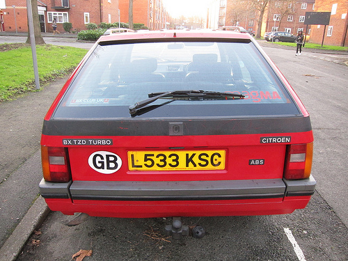

This is what my aerial looks like:

Do you want to talk about MAGMA , the french famous music group
I daren't believe it : somebody else than me knows this wonderfull group
But maybe magma is just something else …a trade-mark or so……

Ha ha. Magma is the company I work for. It's a visual arts and graphic design book shop. We use a lot of red in everything, and so the BX became
the "Magma mobile" as it ends up carrying stuff around quite a lot.
