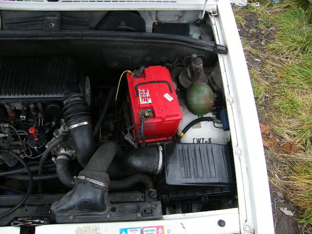

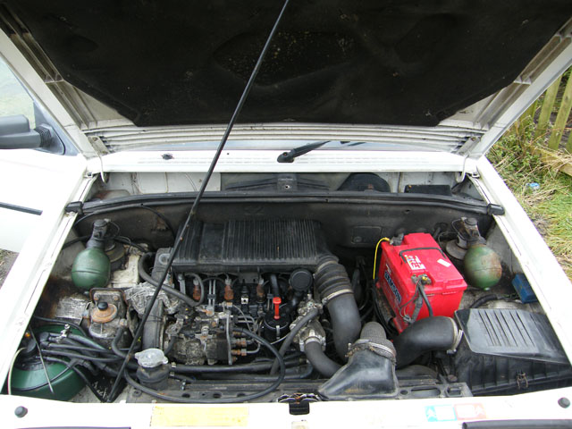

I was going to crack on cleaning the engine bay today. I like a clean engine bay, it makes leaks easier to find and maintenance is more pleasant when there isn't gopping globs of oily greb everywhere. The bitterly cold weather meant it wasn't to be, but today was not without some work at least. I started with this.
Most of the dirt is road muck and some oil, there seems to be little in the way of stubborn grime and what I have cleaned came off mostly with very hot very soapy water, some rags and a toothbrush. The airbox got cleaned up, as did most of the inner arch on the same side, but by this point I was losing feeling in my nose and fingers so I called it quits.

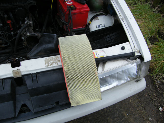

I did still take the opportunity to do more investigating. Starting in the engine bay, I know the oil and filter need changing from checking the oil and finding it was as black as black thing but I hadn't checked the air filter. Happily, the air filter seems good so that's one thing off the list.

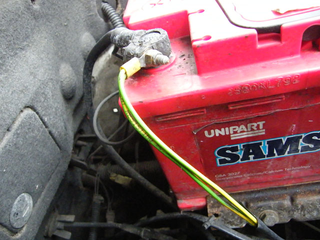

I was perplexed by the battery earth strap which, rather than the braided strap I'm used to seeing, appears to be household electric cabling wrapped in electrical tape. Surely this can't be right?

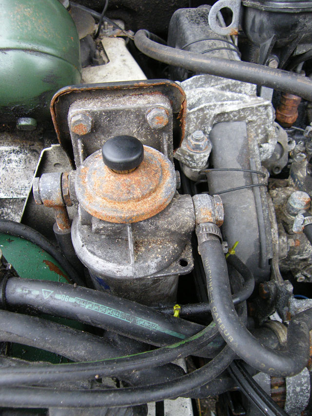

Diesel pump next. The pipes connected to this are rock hard so they will want replacing, I haven't removed them as I don't have replacements to hand but I wouldn't be surprised if they break when removed. If possible, I might end up taking the pump apart to clean it out too.

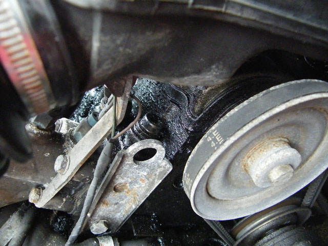

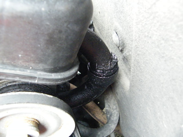

There's quite a bit of oil about the place, I wanted to try and find out where it was coming from. Some of it is getting sprayed up behind the back of the engine by the looks of things, the rest is running down the block and collecting all manner of detritus to make a sticky, clumpy mess.
A quick examination seems to point to the top gasket, particularly this corner where there's some very wet oil. There's not much oil to speak of above this point, but lots further down, as though it's run from the gasket down over the block.

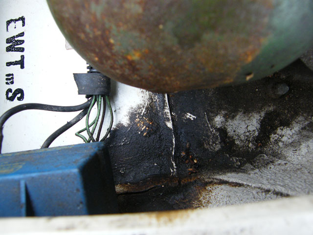

Uncovered another little rust blister that will want dealing with too, on the inner wing.

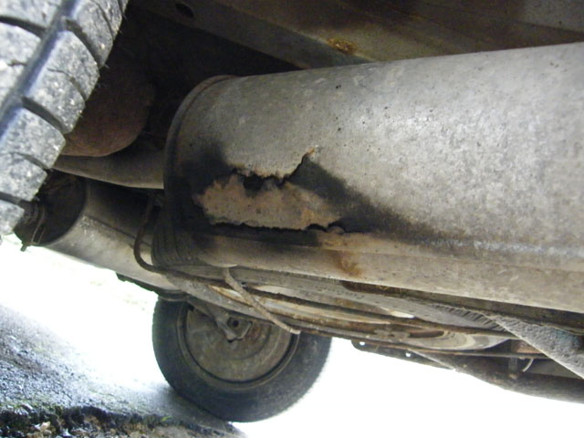

Checked the exhaust and found the source of the blow easily enough. Looks like the backbox has exploded.
While I was checking the exhaust, I had a good look at the rear hanger which is, amazingly, still attached.

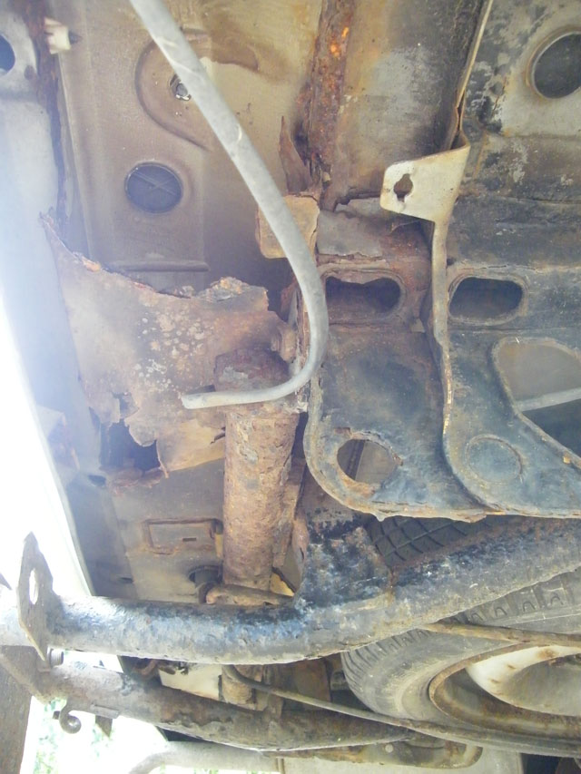

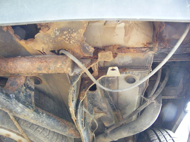

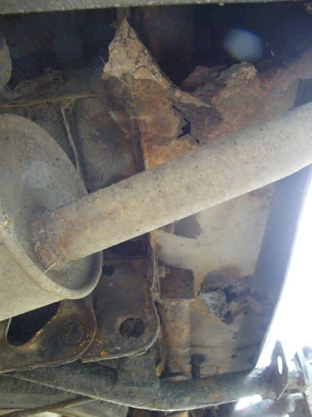

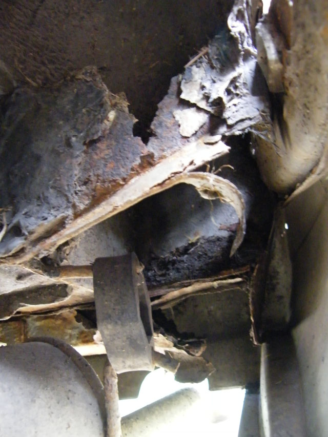

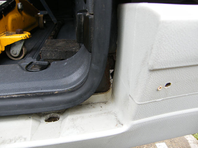

This gave me chance to use the camera as a second pair of eyes to have a proper look underneath. The flat metal sheet that joins the wings and bumper to the structural elements mostly has the consistency of wet cornflakes, what's left of it, but it does at least look easy to replace. All the structural bits look scruffy but solid and certainly don't seem that willing to bend or drop off when handled. Have some pictures of some rust.
And now you see why I daren't take the back bumper off to investigate further; I doubt it would go back on. You can just make out two little holes where the seal, light cluster and bumper meet in each corner.

I've seen green and yellow battery earth to bodywork cable on a few 205s of that era, and it looked to be factory fitted rather than a bodge. My BX has two black earth cables, but assuming it's got a reasonably small individual strand size (for vibration resistance) the sheath isn't that important.

Not sure if it will count for the whole width of the rear box section, and it's a dodge to get through the MOT at best, but some of that rust in the rear box section is classed as non structural with the tow bar removed (guess how I know, & no I didn't).
Totally agree about trims etc. Although I need plenty of bits for mine, I'm concentrating on improving the structure and mechanics at the moment, although when a hen's tooth turns up (like a NOS Mk1 bumper for example) I try to grab it.

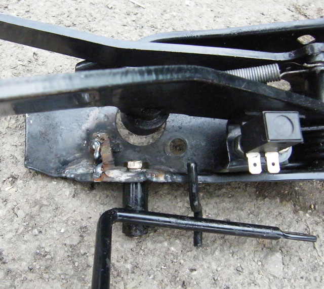

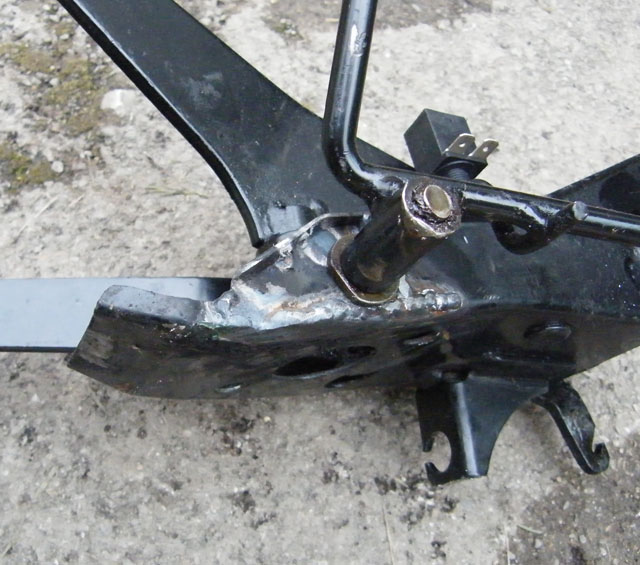

Great success! Yesterday, my pedal box returned all lovely and repaired. The accelerator pedal moves a lot more freely, probably because it's not trying to move parts of the pedal box with it. As Mr Cobblers put it "It's no Boyd Coddington, but it is solid." and he's quite correct. Many thanks to Mr Cobblers for stepping in and being a gent with the welding to get me mobile again.
It was a bit of a battle to get the clutch cable connected properly, that's a job I hope I don't have to do again, there was a strong risk of me hurling it across the fields when it played the game of one part clipping off just as the other part clipped on, repeatedly. Happily, I had support in the form of people that hadn't being squished into the footwell in the cold trying to make it all fit properly and we got it loosely fitted. Today, I got everything tightened up and we reconnected the clutch cable in the engine bay which my Dad had disconnected to try and give me more play in the cable, which didn't work. Also plugged the throttle cable back in and it seems to be fine, it didn't break, but I suspect I'll have to replace it anyway.

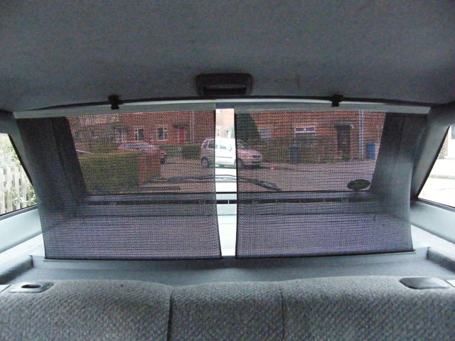

These, I like a lot. I don't know if I'll ever use them, but I like that they're there.
