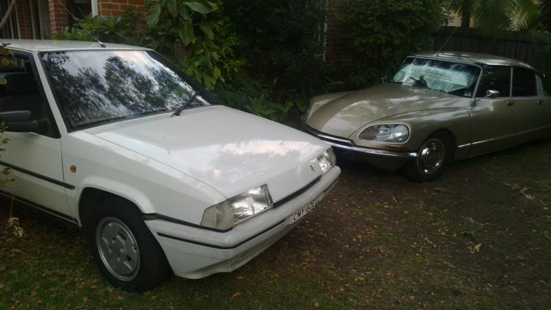

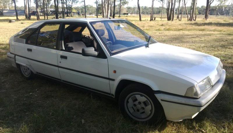

As I announced a few weeks ago, I acquired a 1989 BX19 TRI sedan which had broken down and in need of a rescue. I am hoping to get the car running well enough to be used as a daily driver.
It has been a "Canberra Car", meaning it has spent it's life in a dry inland city and so has no rust that I can find. The flip side of that is that it has had plenty of sun and so the plastics have suffered, but that is normal with most Australian cars. A bonus is that it has only travelled 130,000 km (81,000 miles) which is very low as the Australian average is 15,000km pa for private use and more like 40,000km for a business use car. This has averaged just 5,500!
I have been around Citroens for a while, and have a 1974 DS23, but knew little or nothing about the BX. If i have a DS a BX has to be easy, right? OK, I admit a bit of further research, and the wonderful pool of expert knowledge here in BXClub, thank you, has shown me that it is still a real Citroen. Why do they make so many maintenance and repair jobs so hard?

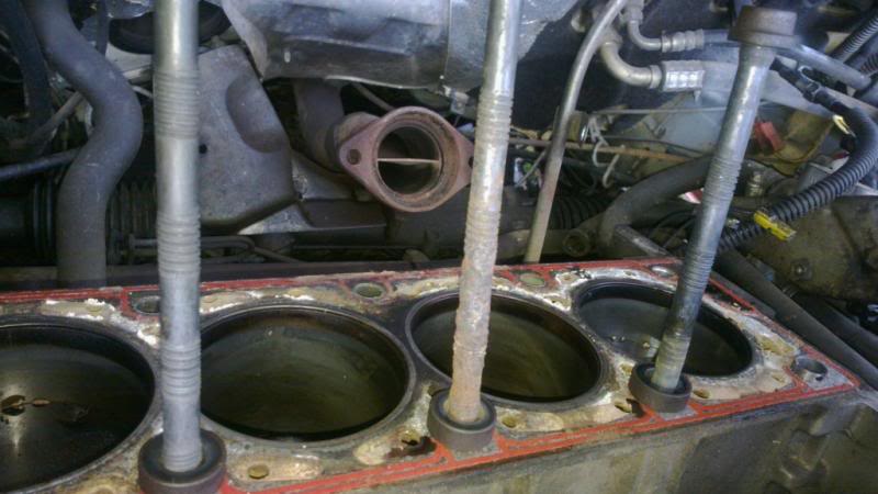

I have to say that although it took a bit of contortion and some patience with a rattle gun to get the crankshaft pulley loose it all came apart with no broken studs. There was of course a broken engine mount but I was told to expect that.

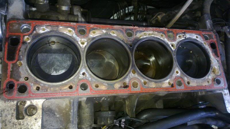

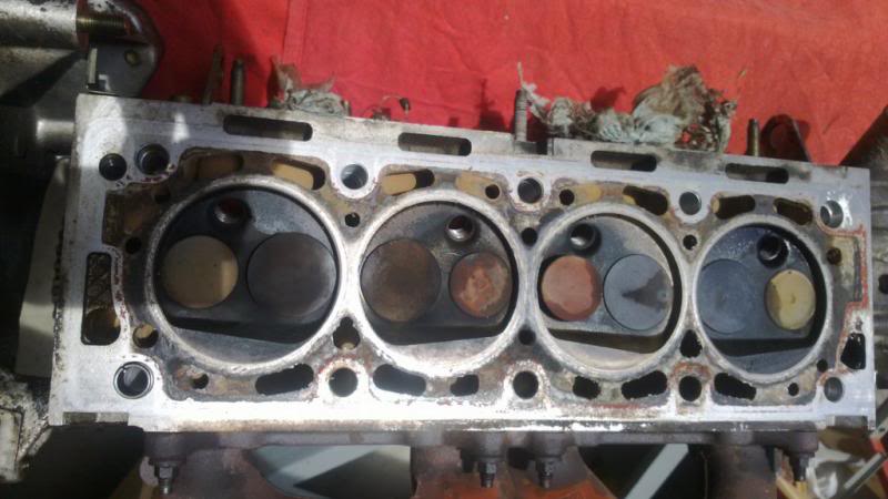

The head looks OK with little corrosion and the bores are good. Compressions before I stripped it down was 170/135/140/170. But the gasket looks a bit sus between centre cyls and water has been getting into two head bolds. One is very badly corroded.
I need to track down a set of bolts and I will take the head a local engineer to check for flat and to lap the valves.

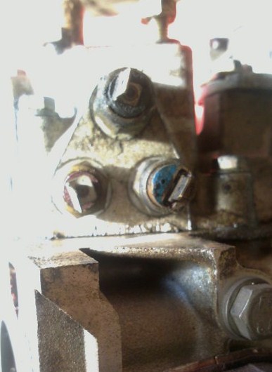

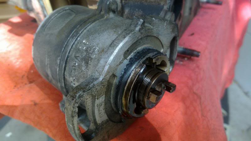

Two questions at the thermostat housing end of the head: Firstly the back of the housing hold three sensors but only two were connected. I cannot find any loose wires and the unused spade terminal has been vacant a long time.
Secondly the O ring seal around the distributor has turned to mush. There is not a replacement in the head gasket kit, just two seals for the thermostat and a "paper" gasket for the head/housing joint. Anyone know the correct seal for this one?

I'm assuming you have two warning lights on the dash (orange and red) rather than a gauge and a red lamp? If so, that accounts for two of the senders/switches. The sender for the gauge is shorter than the switches for the warning lamps. I'm also assuming you have AC? All the information I've read suggests that the AC system is linked to the engine temperature to cut it off in the event of overheating, but my system doesn't have any link and the systems that others have got that I know of have a temperature switch with two terminals!
Regarding the distributor seal - when I've worked on this engine in the past (in 205s) I've just used a standard O ring from my stock. I would have thought it would be easy to match it up from an engineering suppliers.

Thanks Mat, yes, it should be easy to find a O ring if that is what is required... it is just that the one I removed was so degraded I could not see quite what shape it used to be!mat_fenwick wrote:I'm assuming you have two warning lights on the dash (orange and red) rather than a gauge and a red lamp? If so, that accounts for two of the senders/switches. The sender for the gauge is shorter than the switches for the warning lamps. I'm also assuming you have AC? All the information I've read suggests that the AC system is linked to the engine temperature to cut it off in the event of overheating, but my system doesn't have any link and the systems that others have got that I know of have a temperature switch with two terminals!
The car has A/C plus the full GTi type dash with a coolant temp gauge. It seems to me that there are far too many sensors on this engine

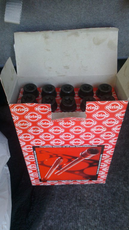

I realised the parts book shows the size of that distributor O ring, not just a part number. 36.5 x 3. My local bearing place had it. I also had a win, picking up new set of torque to yield head bolts for A$50. (34 GBP).

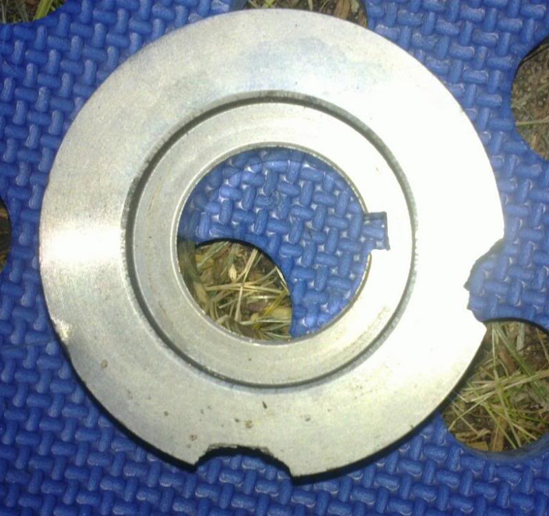

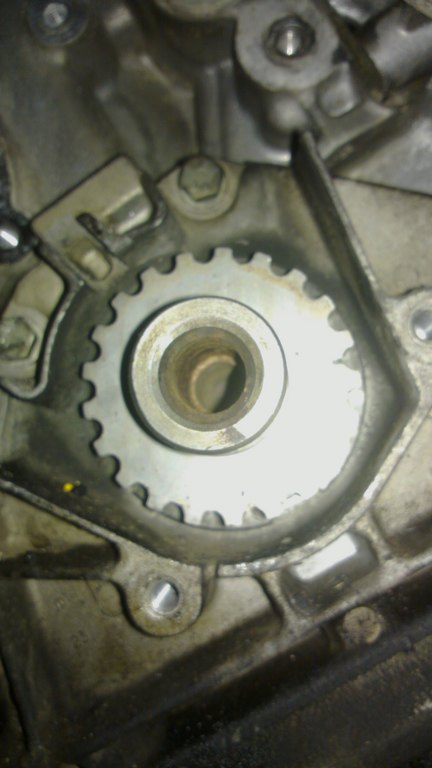

I got the head back, flat and with valves lapped so the plan was to put it back together today. Alas my stupidity has slowed me down. With the crank pulley off the timing belt sprocket was a loose fit on the shaft. I thought I could easily slide it off to look at the seal behind it. It almost came off but then stuck, so I put a screw driver behind it to gently lever it off. Result? Broken flange on the inside of the sprocket! It is so thin and brittle that flange! I just don't know where I am going to find one of these. I am thinking not many people manage to break them!

Did you find a timing belt sprocket or chance it with the broken one?
Re: BX19 TRI Automatic in Sydney
Hi Mat, yes, a local Citroen mechanic found me a crankshaft sprocket off a knackered engine and it all went together easily.mat_fenwick wrote:Did you find a timing belt sprocket or chance it with the broken one?

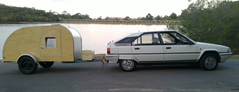

Thought you might like to see the little Teardrop Camper I built. Not finished yet but I took it for a run. The BX is a great tow car, just a shame there are no diesels here but the 1.9 injected motor is pretty capable.
How big are those wheels on the caravan!
