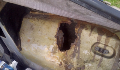

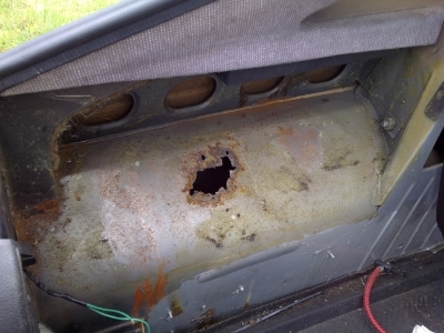

:( I think I have just found a new rust location, the top of the rear inner wings!
Has anyone seen this before?
Neil

no not seen it there can only guess that the tailgate leaking would be suspect, i had a rather rusty rear n/s pillar caused by leaking tailgate? but that should patch ok would investigate the rust further tho paying attention to the boot floor seams and underside chassis rails as these are rust hotspots too.
Re: New rust location
Yes Neil,
Many times sadly, that panel gets bombarded with water/salt etc all the time, my Mk1 16TRS auto which was solid on the inner wings etc was tottaly shot there and ended up being broken, also the red 19TZD which I sold to George also had a patch there too.
I thought that was a well known spot for BX rust. Whenever I've bought a car I always give it a thorough prodding in the cubby holes for the ominous sound of crispy crunchiness! :shock:

This was the first time I had known about this.
The boot floor and exhaust hanger in the N/S rear rear where dealt with 5-6 years ago.
My heart sank yesterday when I was fitting new foam into the the air vents, rested on the inner arch and heard the scrunching noise.
I have ground back the locations and will repair them in the next few days.
Neil

I had the same problem too, but assumed that the two pinholes I found were where someone had screwed in a couple of self tapping screws previously.

Ideally a waterproof but 'spray-absorbant' material fitted within an inch or so under the rotten areas shown in photos above /\ This, if fitted correctly, should protect the areas robe to rust, but also allow full suspension travel.

most of the rust i have seen on BX's ( most cars really ), starts were two or more layers of metal are touching or are welded together,

The estate i'm currently repairing/rebuilding was gone on the rear inner wings, on one side the repair plate is about 15 inches long.
The 14 I had needed a repair in this area. There was some part of the fuel breather system attached to this area and I guess it had trapped dirt against the panel, rather like the extra fuel tank fitted to some models seems to do, resunlting in the rusty fuel filler surround.
