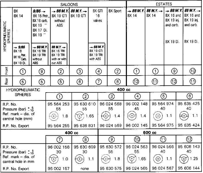

How do you tell differant spheres apart? One the questions I have never asked until now

Kiwi: pressure, volume, and damping orifice. Or ideally part number
To be pedantic all the front spheres have the same pressure apart from the 16v, which is a lower pressure. The lower the pressure the smaller the spring volume and hence the harder the ride...
Pre '88 spheres will give the softest ride as they progressively decreased the size of the damping hole over the years.
Numbers 9 and 12 will give the softest ride. Front spheres for a TD are number 3; the rear ones aren't listed in that picture.
