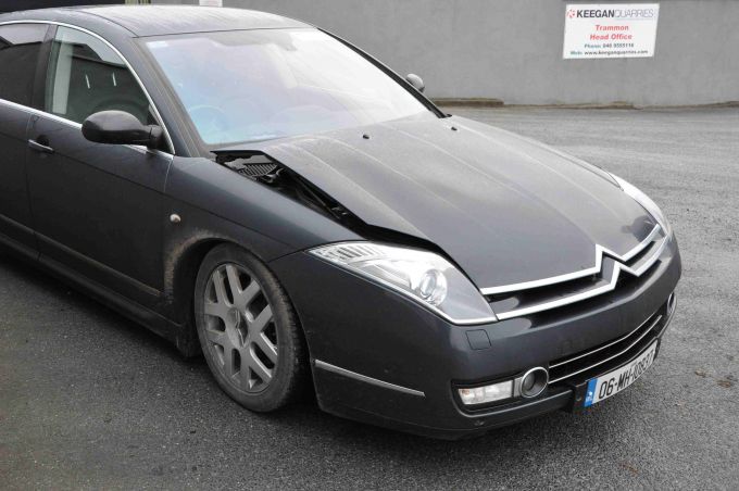

Crap your country is severe on cars!!!
Dollywobbler wrote: Image
Haha yeah what does that say about the Irish weather! And that C6 is Irish too! :shock:
