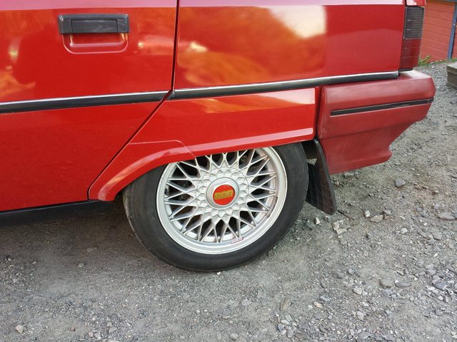

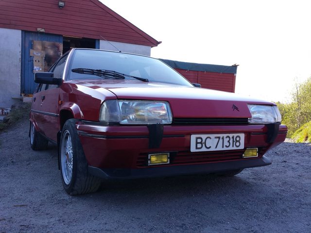

Hi. Trowing some pics of my Red 87 Gti.
I have changed the engine to an 1.7td becouse im running on free "diesel"

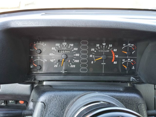

Bought the car for almost a year ago now. It had only been used for sunday driving for an older man. When i bought it, it had rollet 115.000km.
I use it as daily driver, and a track car. Her is a movie from the track day

Nice car!

Nice wheels, not a fan of the steering wheel but she looks lovely!

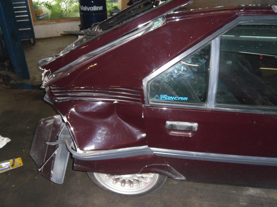

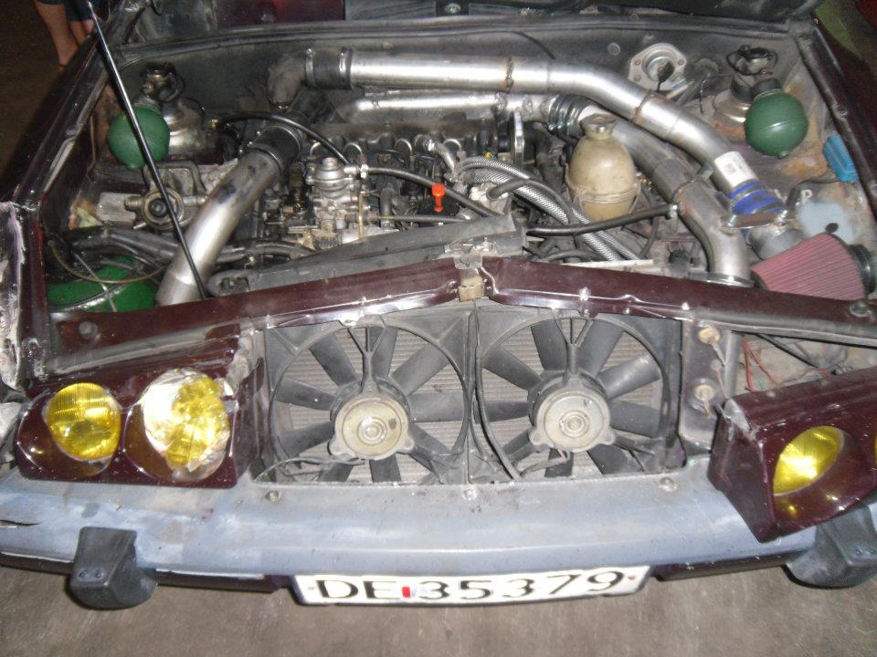

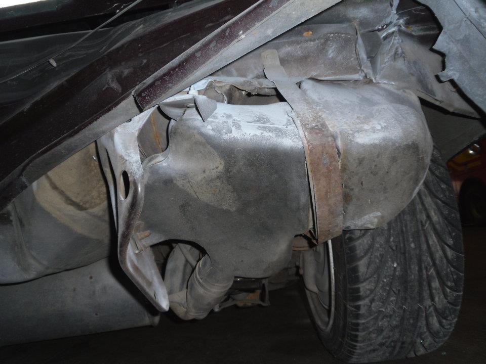

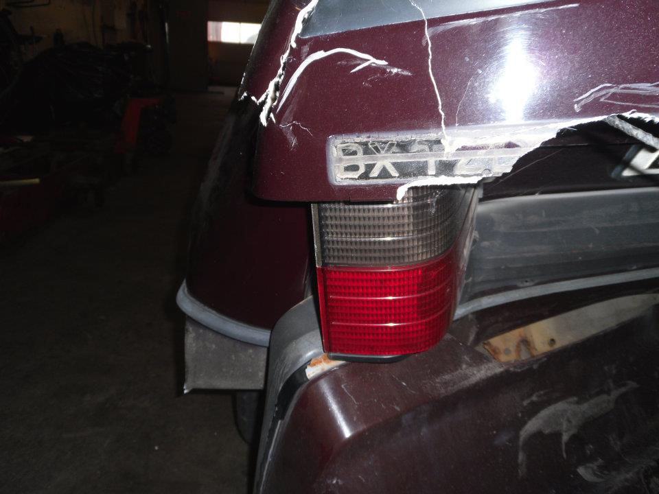

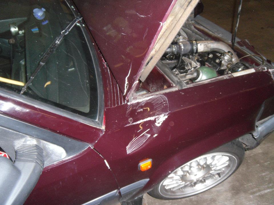

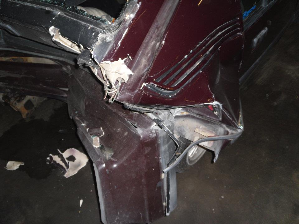

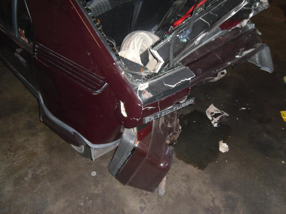

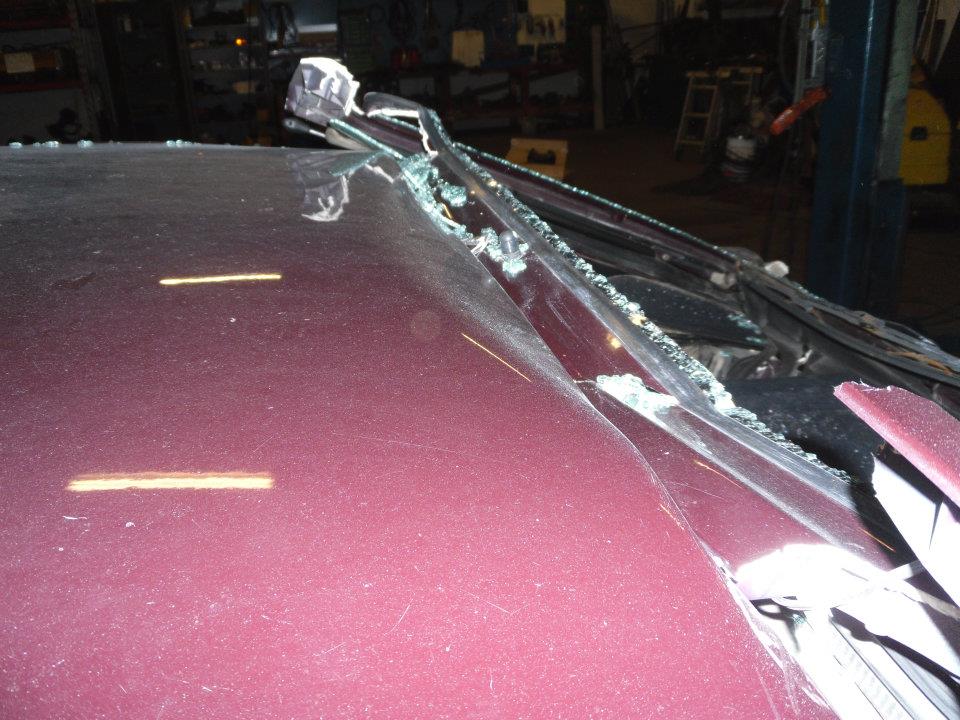

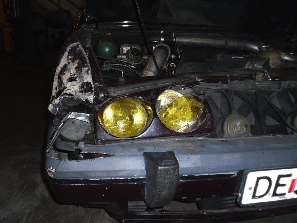

The engine is from my old Bx. I was rear ended by a suv. The engine should produce around 100 hp. The is no problem with heat of the lacking intercooler. It's very quick at the bottom end, about 2000 I have full boost, that's one benefits of not having intercooler. The diesel pump is Bosch, so theres no problem adjusting the dieselpressure and the boost. On full boost is about 1.3-1.4 bar. It's very responsive at low rpms. The engines life will not be shortned with no intercoolerJayW wrote:How is it on power when it's hot with the lack of intercooler?
And (of course) Why no intercooler?
Here are some pictures of my old Bx 84 Diesel.

Did you come away from the one with a sore neck? Poor morettes.

Ah, Transformer oil. Indeed a great resource, if available. I know a guy who made a lot of money out of that. Is the oil you get slightly lighter than standard Diesel? I am thinking of Norway winters and oil waxing.
Nasty mess of one of my favoured colours of car, with yellow headlights too, as mentioned.

frog wrote:Did you come away from the one with a sore neck? Poor morettes.
I didn't have a scratch on me. The back of seat braked when he hit me. So the seat took all the shock from the impackt. If you look at the one picture with the seat, it almost lays in the back seat.
The oil is very thick, i have used petrol and parafin to get it a little bit thinner. But i need to change diesel filter often :/ It is hard to get to start when it cold outside, the oil gets thicker and thicker as it gets colder.
I have a spare pair of Morrete lights left, got two kits when i bought the Diesel Bx

Shame about the TZD, glad you walked away ok from it though, same colour as my car
