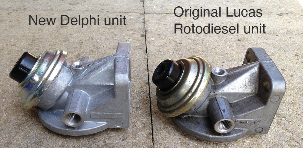

Hi all,
As per the title, I've had the fuel system apart on my car and it won't start now everything has been re-assembled. Hopefully someone can point me in the right direction or let me know what crucial bit I've overlooked.
The back story:
I disconnected the hard fuel lines between the fuel pump and the injectors so I could carry out a compression test. I also disconnected the power feed to the fuel pump stop solenoid to stop the fuel while I carried out the compression test. While I had the spanners out I also changed the diesel filter. I reconnected everything back up and now the engine cranks but just won't fire.
Things I've checked so far:
1. I'm getting power to the glow plugs when the ignition is on.
2. I'm getting power to the stop solenoid when the ignition is on.
3. I loosened off the hard lines at the injectors again in case there was air in the lines. How much diesel should I expect to see coming out of the lines if everything is working correctly?
4. I've pumped the Rotodiesel primer button A LOT. I always expect a bit of hard starting for the first time after the diesel filter has been changed but I've tried pumping the primer a lot and the button doesn't seem to go hard like I remember it used to. I seem to get a hissing / whooshing noise both when the button is depressed as well as when it is on the return stroke. After a lot of pumping I also get diesel leaking out past the priming button (see photo below).
After I've cranked the engine I can also hear a hissing / whooshing noise as if air is being pulled in past the primer button. Does this point to a knackered diaphragm or seal on the fuel primer?
Are there any further tests I can carry out on the stop solenoid?
Any advice or suggestions would be much appreciated.

i think you have answered your own question as it will almost certainly be the leaking primmer causing your uissue,
i can repair these if the innards are the same as the Purflux unit, as i have the relevant genuine Purflux parts,
if you are interested please contact me, i will pm. you my contact number

As malc says, its not getting any fuel/there's air in the system

Did read on here once about someone doing a temporary repair to one of these using a rubber glove, makes sense, just to get an airtight seal.

Both my original Purflux filter head and the Bosch one pictured above have leaked and caused starting and air ingress problems on both our diesels. Using Bio Diesel has speed the process up but the rubber will degrade given the age of the cars now anyway.
I've had good results with using the standard Bosch type screw fitting filter heads available from most diesel suppliers and using a priming bulb in the feed line before the filter:
http://www.ssldieselparts.co.uk/single-filter-head-screw-filter-type-12quot-p-703.html
Worth fitting some clear line between the filter and pump too to give you an idea of any air getting in and an early warning to problems with the steel fuel pipes / rubber lines behind the engine and from pipes to tank.

Why dont you just bypass the purflux unit for now This will eliminate the fault, just use a simple in-line filter.

In the end, I opted for a new filter head unit from Delphi. At £30 it was roughly similar to the cost of getting the original filter unit refurbed and it's identical to the original Lucas Rotodiesel that came off the car with the correct 14mm ports for the banjo bolts. This meant I could do a straight swap using the existing bottom plate and long bolt for the filter with no further mods required.
Bleeding the hard lines to the injectors took some doing and in the end the method that seemed to work best was to just loosen off one line at a time and turn the engine over until I got fuel flowing through. I then nipped all the connections back up and it started up like a good 'un.
