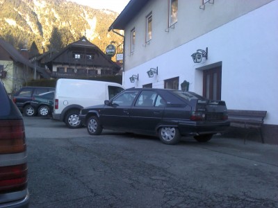

And here's the pic of her on the day she arrived home. Just testing the new pic upload feature.
Own Copyright xjs36uk BX16IE IMAGE Austria

Looks good from here!

xantia_v6 wrote:Looks good from here!
From 1000 miles away I'm sure she does !
Actually she looks pretty good close up too.
