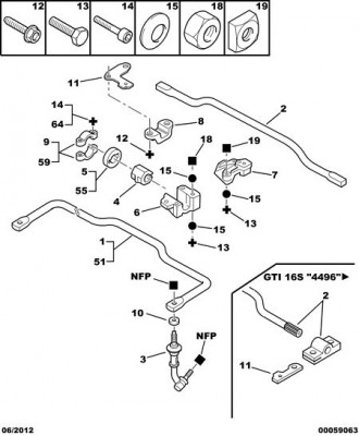

Tinkley wrote:I'm going to assume a one side split rubber item that can be installed pretty easily, just clamped by the ARB mount blocks. I've only ever had MK2 BX and the parts list where I found the part No was for late ie '90 onwards cars.
It's the same part for all BXs after May 1987 (up to ORGA number 03856). It is indeed a split bush so shouldn't be a problem to change in situ. It's part number 4 in this diagram from Citroen Service - worth signing up if you haven't already as it makes sourcing bits much easier. You can check the original part number, makse sure its is actually right for your particular car, then check prices and availability. Sometimes you'll find it's actually cheaper to order stuff from a dealer if still available than from Ebay or a factor. For example I need a set of rear arm bearing seals, part no. 515414. Straight from main dealer, 5.72 euros each. From Ebay £6.48 each...

Thanks for the parts diagram. I may have something missing!. There's nothing to stop the ARB from moving sideways on this car and it has.... it looks like the two pillow block clamp parts are missing. BTW replacing the bush is not in itself that hard just fiddly and you have to let the rear bolt of the front sub frame slack a few mm to get the upper part of the bush clamp to locate correctly.
The Haynes only shows the early version - both Brown and Blue manuals but mentions the bush change in one of them. I'm going to check the 'donor' to see if I can liberate any pillow block clamps if they are on that one.

The top alloy clamps have a nasty habit of seizing onto the steel studs from the subframe usually the forward ones are worse, before removal i would advise soaking in penetrating oil or heating the alloy up can free them off.

Thanks rutter. As it happens I had no problem with the top alloy block - even drove it off with a hamer and jemmy against the geometry!!!. The lower I realised was polarised by the extended tube piece for the 16mm AF bolt with captive nut. On reassembly I realised I had to lower the subframe to get it to go back... so I did. You are right these bolts can get pretty scabby with corrosion but they were pretty good on this car. I did clean and lightly grease the threads on reassmbly.
