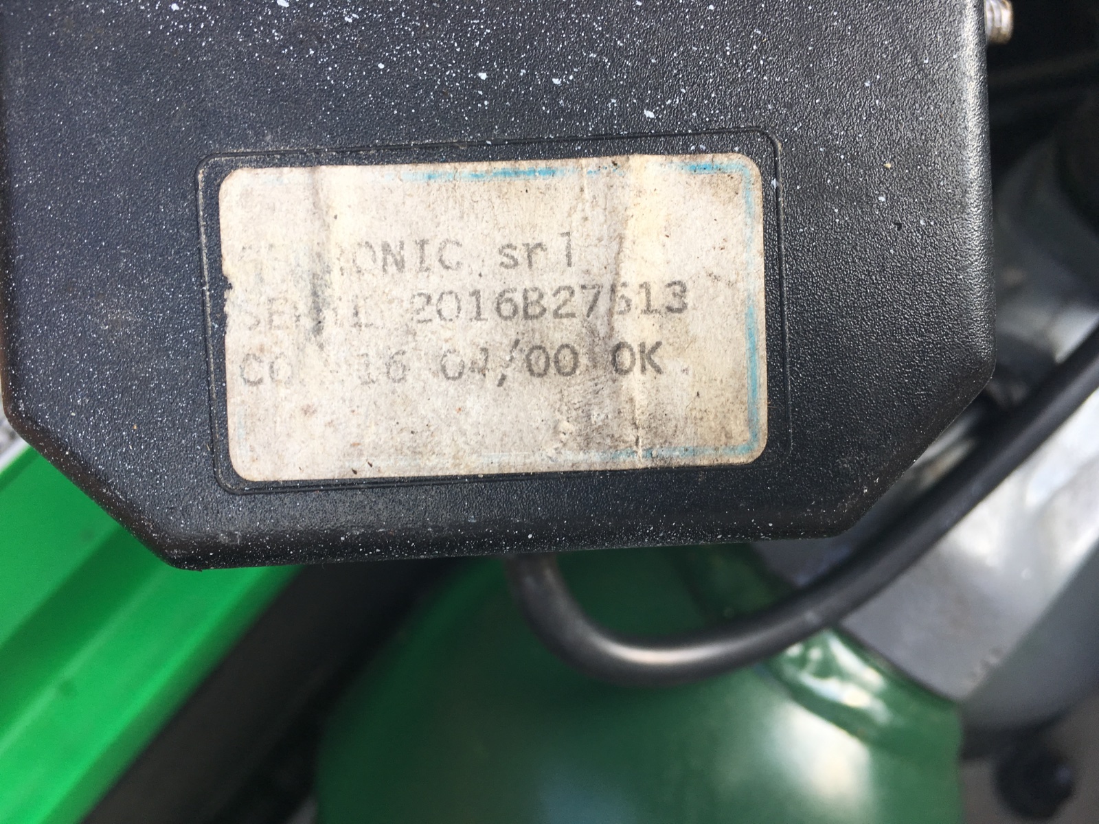

Next photos show the siren, located in the cowl, and the only labeling - almost readable, brand appears to end in “…tronic.” Anyone have something similar? Its cable through the firewall splits into several small wires around the steering column - with a higher gauge white wire leading to the junction box, Column 4, Stage 2, a + source shown with four wires (disconnected in photo, from second position behind the black direction indicator relay). One of these two white wires apparently powers the ignition switch, the other probably powers the alarm system.

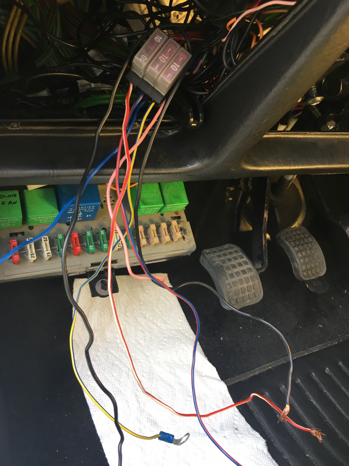

Glad to convey the good news that the cantankerous alarm system plaguing my BX GTI has been exorcised. As an example of aftermarket slipshod work, note that the alarm power came directly off the junction box white-wire 12v feed to the ignition switch (Column IV, Stage 2 on the junction box diagram), with a jury-rigged splice made by insulation removal and a wire wrapped around the bare area, then taped over.
These two white wires merge into one red wire near the ignition switch, as is the case with two green wires merging into one green. Is this standard?
Removing the alarm involved, first, cutting the siren cable in the engine compartment and pulling it through the firewall, then tracing several small gauge wires inside it.
The yellow and orange ignition wires (Column III, Stage 4) had both been cut and seven black wires spliced into them, apparently to power parts of the alarm system.
Thanks to Higher Forces, I realized I could kill the alarm by cutting all the black wires and simply splicing the two ignition wires back together. An electrician friend had metal butt connectors with holes in the center to allow inflow of solder, which he used for the splices. I asked him where he got those - “a nuclear power plant.” I now have the only nuclear-hybrid BX in the world.
While tracing the black wires up into the darkness above the steering column, I saw that they entered a harness sleeve, along with many other small-gauge wires, then lurking way up high was a sinister black box with all those wires connected to it, another system brain. I yanked it out and dragged all the wiring with it, cutting many of them to make removal easier. A label identified the make as “Getronic.”
Then I stomped on it in the driveway until it was surely dead.
A few stray wires remain, a couple seeming to enter the instrument cluster from behind, and several routed out to the left front door, probably to operate the power locks.
I learned how to remove the cassette box for better access behind the dash - only open it a bit, then pull it off the hinge.
