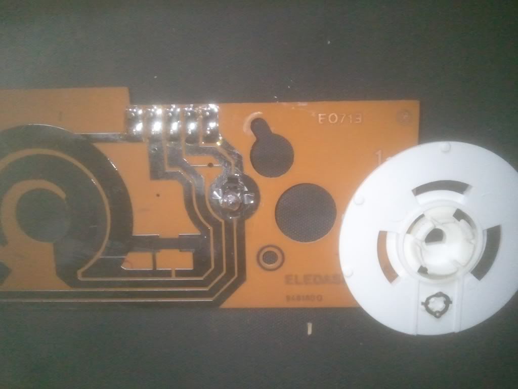

the one from my TZD Estate (with aircon) looks differant than the ones i have seen on here.. my one does not work in the full speed position (turned right up).. wonder if its a relay that has gone?
the scratched off track was already like it. its not a track though, its more like conductive paint between the tracks.- JohnDragonMan

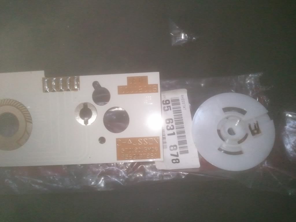

No that is a standard one, there were a choice of 2 different types fitted the Chausson and the Eledas but both do the same thing, note the different contactors though.

Dragon Man wrote: ↑Fri Aug 04, 2017 3:19 pm the one from my TZD Estate (with aircon) looks differant than the ones i have seen on here.. my one does not work in the full speed position (turned right up).. wonder if its a relay that has gone?
AndersDK wrote: ↑Tue Aug 21, 2007 10:54 pmThe plot is if the high speed relay is cutting in or not.ed4ferrets wrote:I've seen no reference to the other type of circuit board, brand named CHAUSSON as opposed to the ELEDASA (Valeo) as pictured. Just wondering if it also has the same shortcoming as I've never heard the relay click when turning it to max? The pcb is in front of me but the circuits are not very clear, being covered by a protective white film of sorts .... hence unable provide a pic! This is off a K reg BX. Hope I haven't missed a previous posting asking the same thing
If you lean down to the steering column and hear a characteristic faint relay click while turning the fan blower control up, then there is nothing to modify.
If you dont hear that relay clicking and the fan does not kick into "hurricane" mode when the control is turned fully cw, then you need to modify.

I've (now) got an unmodified Chausson one, and that does indeed operate the relay at full chat (on this car, anyway). The Eledasa ones don't, unless you carry out this modification.

It does, and I'm not quite sure where those comments came from. My understanding was that the Chausson ones are wired correctly, and the Eledasa ones - for whatever reason - weren't. I've got an unmodified Chausson one (typically from the earlier mk2 cars) and it clicks the relay in and out. It's the only Chausson one I've ever had.
