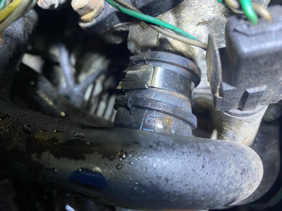

Hi guys I have a pinhole in my hose looking for a replacement
It’s a 1.9 auto and it goes from engine to oil cooler on top of gearbox

Your close-up photos make it difficult to identify the parts; try a shot or two from further back, with an arrow/marker added.

If that is a hose for an autobox oil cooler it will be tricky to find a replacement. You might have to consider repairing the hose by inserting a piece of copper pipe or even bandaging it with some self annealing silicone tape or making up a new one from silicon hose with suitable bends added.

I have boxes of hoses, if u can remove the offending item then photo it and post it i may have something.
