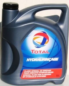

Post by white exec »
If the LHM looks clean, and the rise'n'fall of the suspension is without jerks, then a change of fluid is probably all that is needed.
Where H'rincage comes in is where the fluid is dirty. It is LHM + several gentle cleaning solvents, and will remove the black sediments that form on the hydraulic internal surfaces.
Total UK are coming back to me to confirm the supply situation.
white exec
Posts: 681
Location: Sayalonga, Malaga
My Cars: 1992 BX19D Millesime
- LHD, NA, AC, RP_5800
1996 XM 2.5TD Exclusive
x 70
Re: Hydraurincage wanted
Total Hydraurinçage
Hydraurincage 5L.jpg (15.55 KiB) Viewed 1006 times
With this product now unavailable almost everywhere, I have had this today from Total UK:
" Thank you for your enquiry into the above product. I have done some investigation and this product was withdrawn from the UK market in 2012, as a company we did continue to manufacture this for other markets for several years more, but this was withdrawn globally in 2018. I have been advised by our UK technical manager this was a product used to flush the system before toping up with a LHM fluid, I have been advised the product to use for the flushing now would be the LHM fluid itself. "
The previous Citroen part no. was 1135001 (1 × 5-litre) , but this has now been deleted.

That settles that then
Many thanks
Pretty sure many people will be interested in this.
