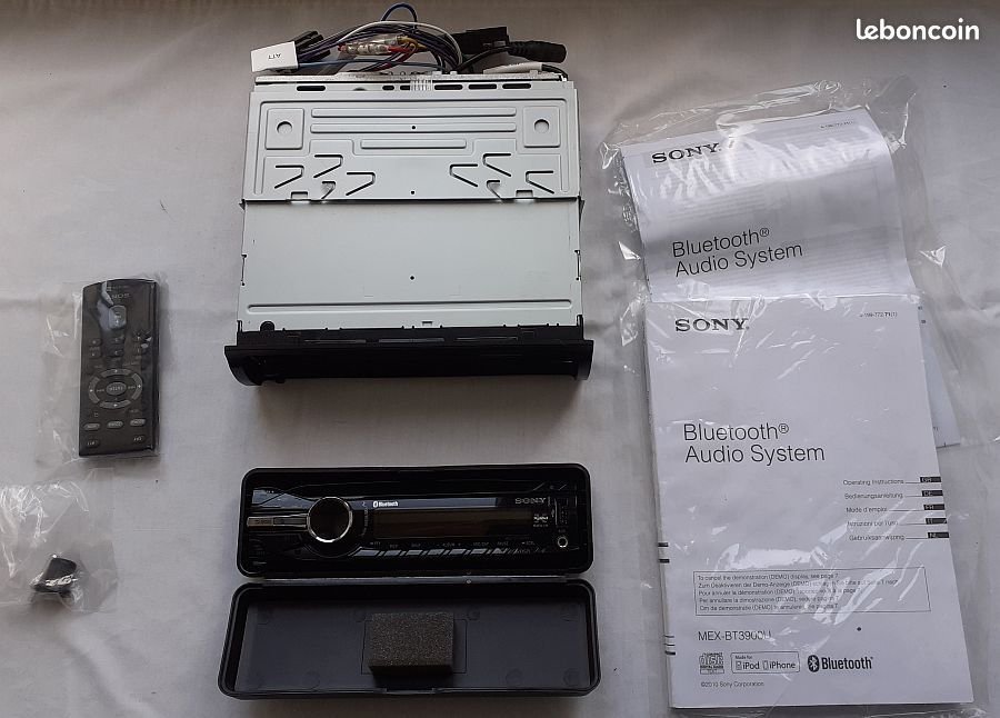

I'm retired in France and recently bought a 1991 Citroen BX 'Image' 1.6 as a second car 'pour les week-ends'. Doesn't have a radio/cd player so I looked at a few second-hand items out of curiosity on the French 'Leboncoin' site (it's France's equivalent of eBay, sort of). Spotted what looks like a good 'un for €65 (about 60 quids) - a Sony MEX-BT3900 - being sold locally (I'll try loading a photo). Would this modern radio thing be ok to fit in a relatively oldish car such as the BX (sorry if it's a stupid question)? Merci d'avance. Bonne journée.Image

it should fit perfectly, however most modern radios use a ISO universal connection system, the BX does not have this so you need a BX to ISO adapter cable. Basically the cables and the plugs inside the BX are none standard. Typically on ebay for around 12GBP

something like this : https://www.ebay.co.uk/itm/CITROEN-2CV- ... 3940509313
All above assuming the SONY uses an ISO standard connector - google suggests it does.
If not. Then its time for some cable connectors to be added to make it connect.
