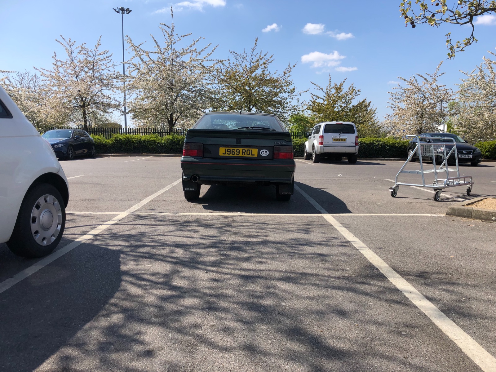

Turns out I was mistaken sorry: there is also sag in the lowest position: 5cm difference again.
There is an approx 1cm difference in tyre height (they’re both 60s, but the offside one is running slightly lower pressure it seems, plus it’s more worn) but that’s not enough to make the rest of the 4cm difference.
@Kitch it’s measured at the wheel arch, and while that’s bodywork it’s also obvious when you look from the rear, as per this pic: Not the best shot due to the shadow soz but you can still tell it’s clearly wonky!
Front struts and spheres are brand new- it’s perfect from the front. No noises from rear suspension, which is soft and smooth as it should be.
I don’t have access to a lift or garage at the moment, just the street, but once I do I’ll be able to make some more accurate measurements.
Weird.
Weird.

Is it sagging on the o/s or is the n/s too high. It looks pretty high off the ground when you look at the mud flap.
Is that normal height?
- Posts: 582
- Location: East London
- x 26
Re: Saggy offside rear
Yes that’s “normal” height. Might be running slightly high but even if so both sides should be level!
Yes, should be level, I just wondered if something was making it go higher on the left although I can't imagine what. It's just that the o/s looks about right. I don't have flaps and perhaps the angle is deceiving. I suppose there is more chance of something keeping the right down than lifting the left in isolation but you never know.
