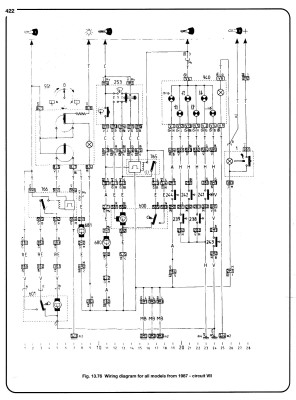

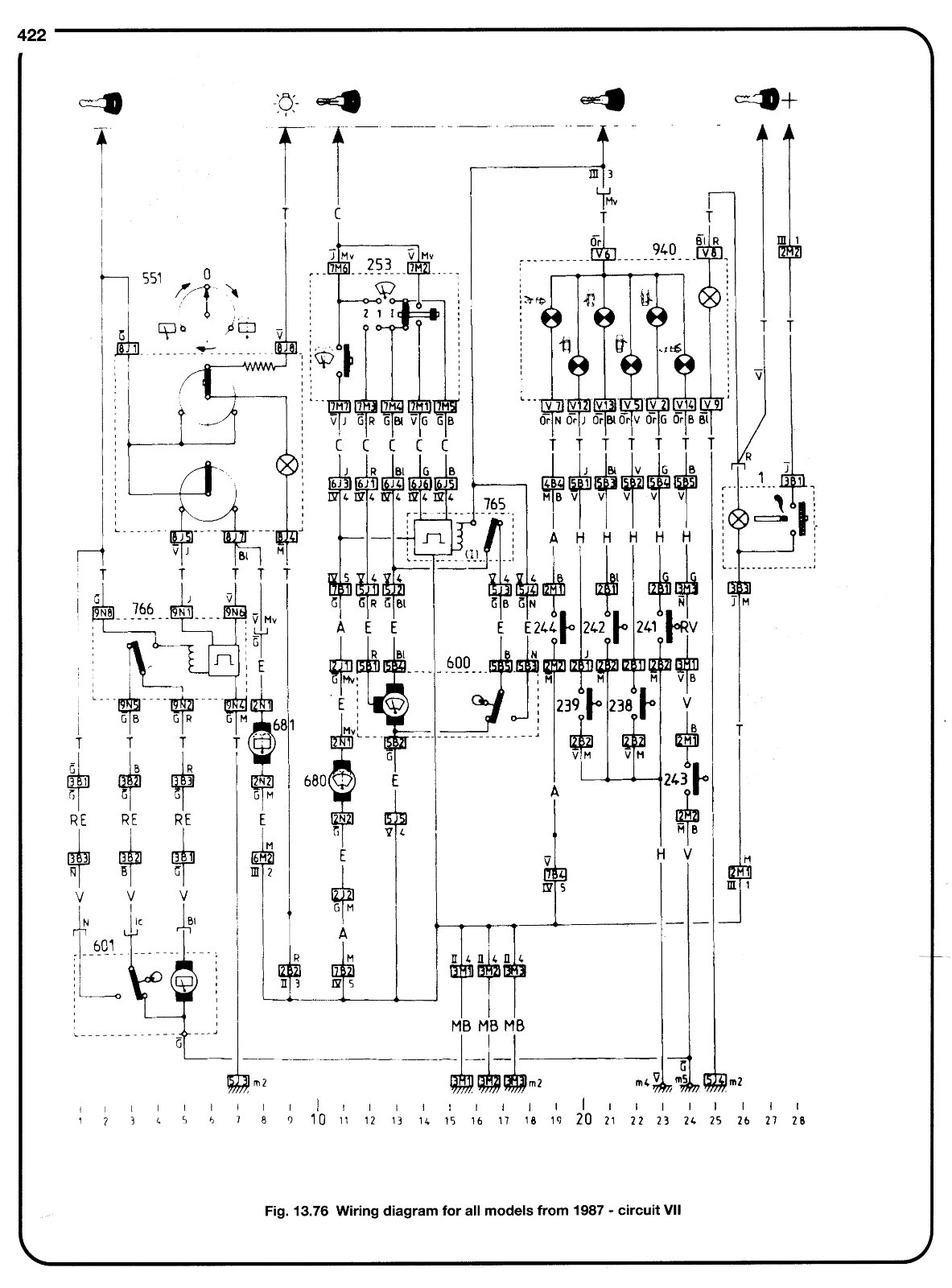

So, I have been tinkering with the door open display, and I am currently stuck in a diagnostics mess. I have determined that the board itself is fine (along with all the bulbs), but unfortunately, it only ever displays the rear right door as open. It is quite puzzling since it's also meant to indicate when the lights are on. So yeah, I am quite stuck. I don't know how to diagnose the issue. If anyone has previously dealt with this, any input would be greatly appreciated

You should be able to bench-test it off the car. Pin numbers on the diagram.
I don't think it displays "Lights on", although the circuit shows it does have instrument panel illumination.
"Lights on" warning on BX is usually the audible buzzer (in the steering column shroud).
If the display checks out, and the door switches operate the interior lights properly, the intermediate connectors (between display and door etc switches) may be misbehaving.
EDIT: Ignore this last paragraph, it's not correct. See below...

I think you will find that these indicators are illuminated by a switch on each door handle. The door pillar switches are for the interior lights only.
It seems unlikely that 3 out of 4 door indicators would fail concurrently so the problem must be in the board, but I see you have checked that out, or if the bonnet indicator works the 5 way white connector and I don't know where that connector is exactly. If you can locate that in the harness somewhere then it would be a good testing point.

John is right. The switches in the diagram above are "door lock switches".
The interior lights are brought on by the separate door-pillar switches, #230, 231, 232, 233.
Have you powered up the indicator unit on the bench, and tested each channel?

On the bench, do all the channels (4 doors, bonnet, and boot) on the indicator board work, when each one is grounded ?
