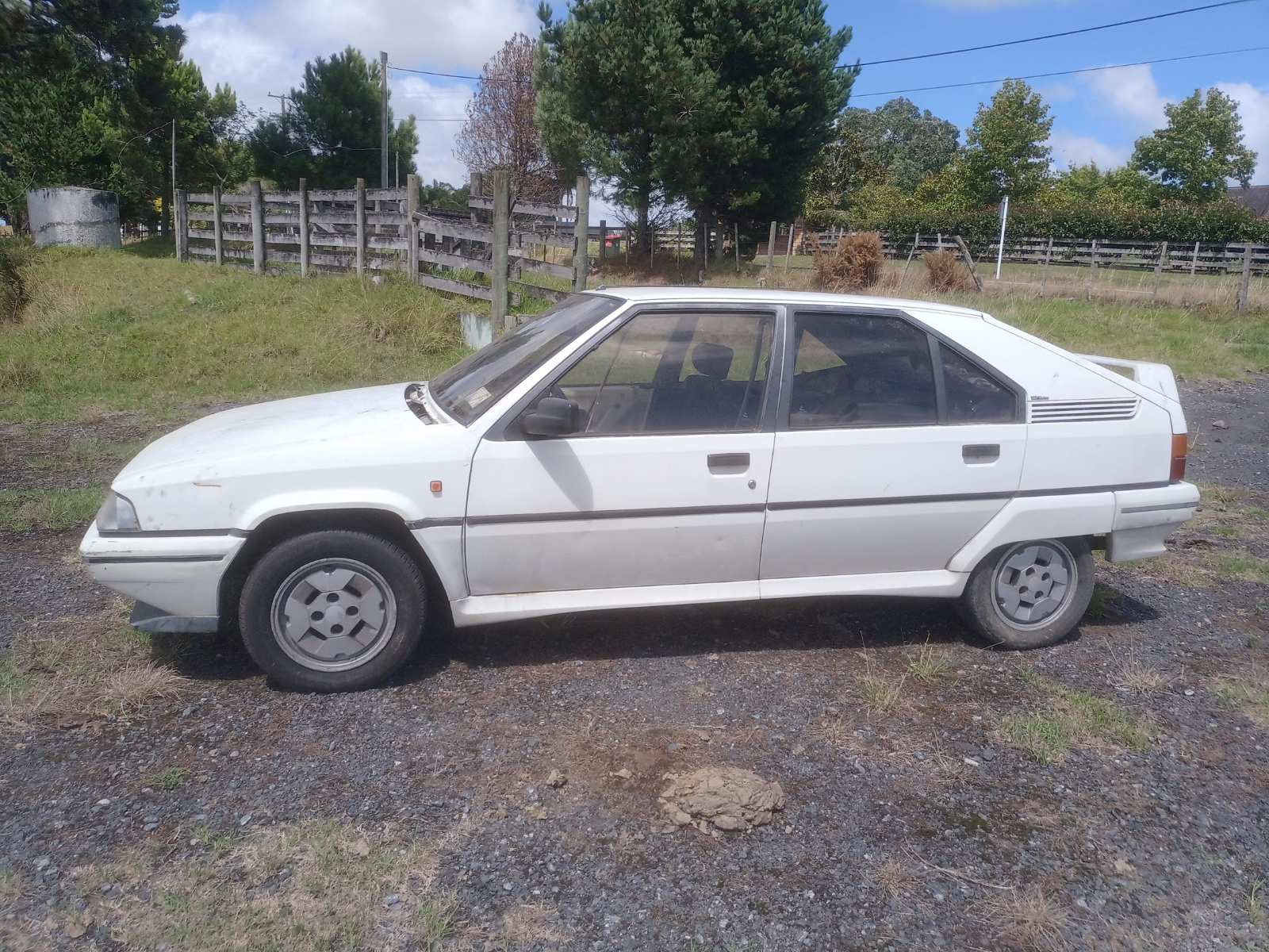

Today I had a better look at the 16v in question. It’s a project, that’s for sure!
One of the areas of concern is that I can see some signs of rust forming around the window frame A-pillars when I peel the rubber seal away. The seals across the roof and base of the windscreen were glued down so I couldn’t see under those, however there is no obvious signs of bubbles emerging in those areas. The dashboard is out, and so I can confirm that the frame on the inside up the pillars and across the firewall all look very sound.
My question is: is it more common for rust in the pillars to emerge from the inside of the hollow pillar and by the time it is visible under the rubber seal we are only seeing the tip of the iceberg, or do they tend to rust on the outside / under the seal first, and therefore could possibly be cleaned up and repainted? The windscreen is cracked, so it would need to come out anyway.
Photo shows visible rust up driver A pillar.
It has had both front door hinges repaired, and there is minor rust under both washer bottles which would need to be sorted.

Yeah that's fairly common rust around the windscreen, you'll prob find more once the rubber is out, it's a tricky repair as you will have to fabricate some new sections or cut some good ones from a doner, usually goes hand in hand with rusty a-pillars and bulkhead which again is a tricky repair as it's triple skinned along the lower bulkhead seam and will need to be repaired in sections.
At least the dash is out which makes things a lot easier there.
The a-pillars tend to rust from the inside out, this can also be caused from rusty inner wings esp under the splash guards that you can't see, have a good poke all along the inner/outer sills and the underside of the sill at the rear, and if it has a sunroof check the frame as they rust quite nicely too.
Hopefully your not opening a whole can of worms. I'd guess rust was a major contribution the the demise of many a bx in the uk Inc my own which was very rusty when I saved it from certain death 15yr ago.
There's two things you need with a bx. A lot of patience and a welder.
And the strips on the roof don't come off easily as they're bonded on I managed to cut the first couple of inches off with a dremel and bonded it back on after repair.

Thanks Rutter. So tip-of-the-iceberg you reckon? I’m in the process of having the body restored on my CX Turbo, and so I know how rust repairs can snowball! I’m not a welder (or at least not confident enough to do my own panel repairs), nor do I have my own equipment for such, so I would be out sourcing. I do know that the panel beater who is working on my CX would be more than capable of carrying out any required repair work on the BX……at a price.
I’m in New Zealand, and so the 16V is an even rarer site here than in the UK, and therefore parts / doner cars scarce.
I see this model as a potential future classic, and so I would be prepared to invest a little bit to at least save it and get it road worthy, if not restore it immediately. The question to myself is: how much can I justify spending on something which currently still doesn’t command that ‘classic car’ price tag?

Potential money pit?
Buy yourself a welder teach yourself to weld, save yourself a fortune.
Justification on spending depends on how deep your pockets are as body repairs need to be done properly to stop the spread, but once you have a solid shell half the battle is won.
