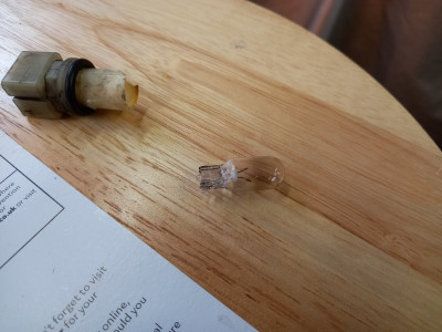

As part of the ongoing effort to improve my BX St Tropez I've been looking at the headlights. Two things,

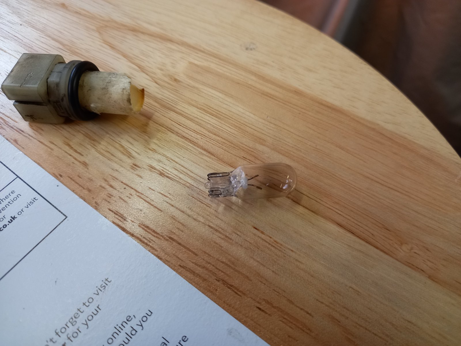

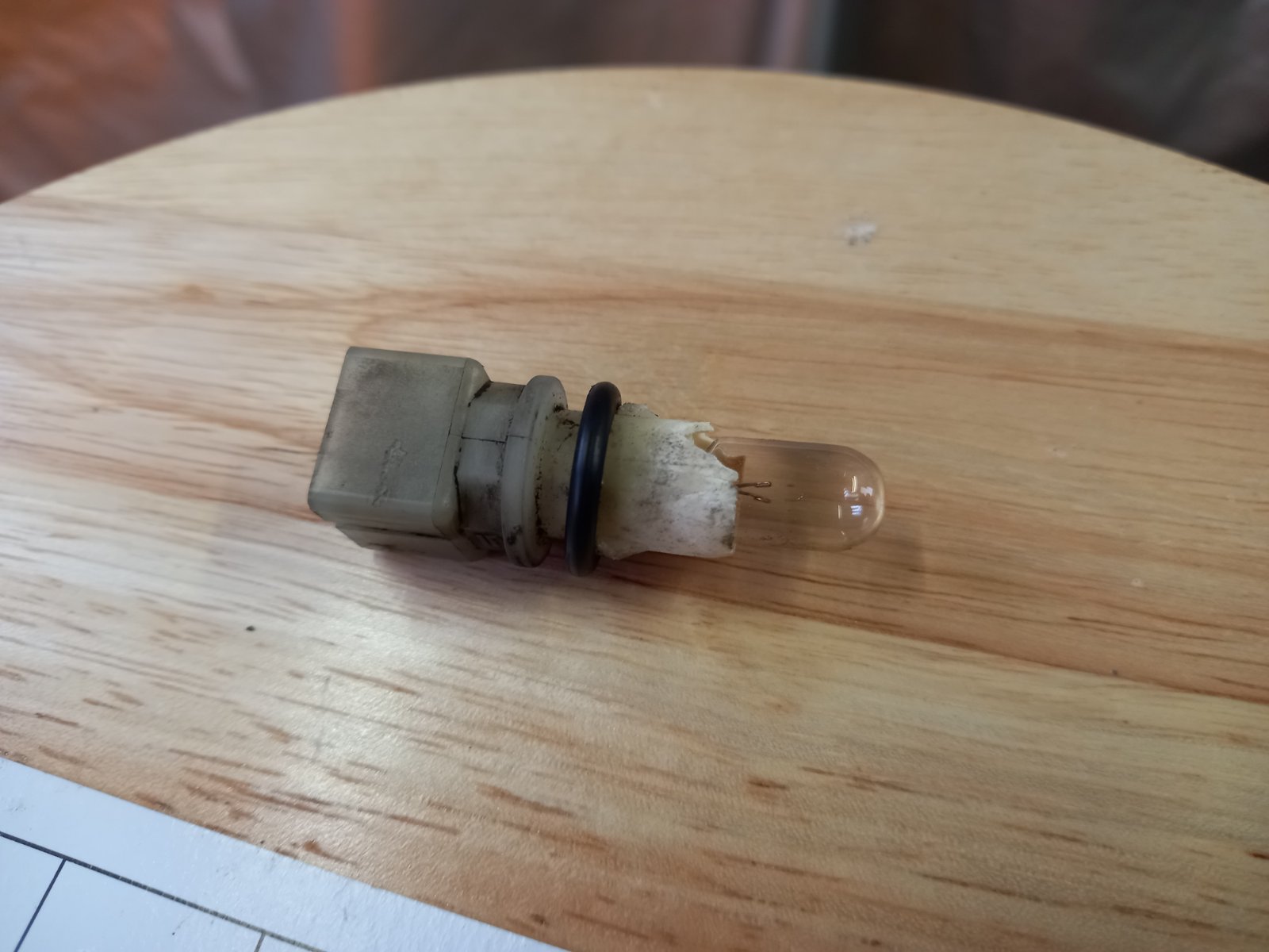

1, on the offside the smaller bulb in the headlamp had blown, it was a bit of a struggle to remove it...now I am puzzled as to where to find a replacement. Any ideas please? It is an odd bulb as shown in the photos, I've tried obvious sources like my local place that sells car stuff and Halfords. I did find a similar bulb but it was red.
2, for some reason I have yet to figure out the drivers side headlight is much brighter than the offside which isnt good for night driving. Puzzled as to why although it appears that the two headlights are different, maybe one was changed in the past.

Hi,it's just a normal "501"bulb -ring part number R501

Yep, fairly standard sidelight bulb, and yes one of headlights may have been changed but the bulb should be the same, again fairly standard bulb, upgrades are available check the reflector isn't peeling off and wiring as corroded wires can affect brightness.

Thanks Gents, useful info on the bulb and I'll have a look at the relay idea, just checked the glass and, happily, that appears firmly in place! One of the reflectors is a bit iffy.
