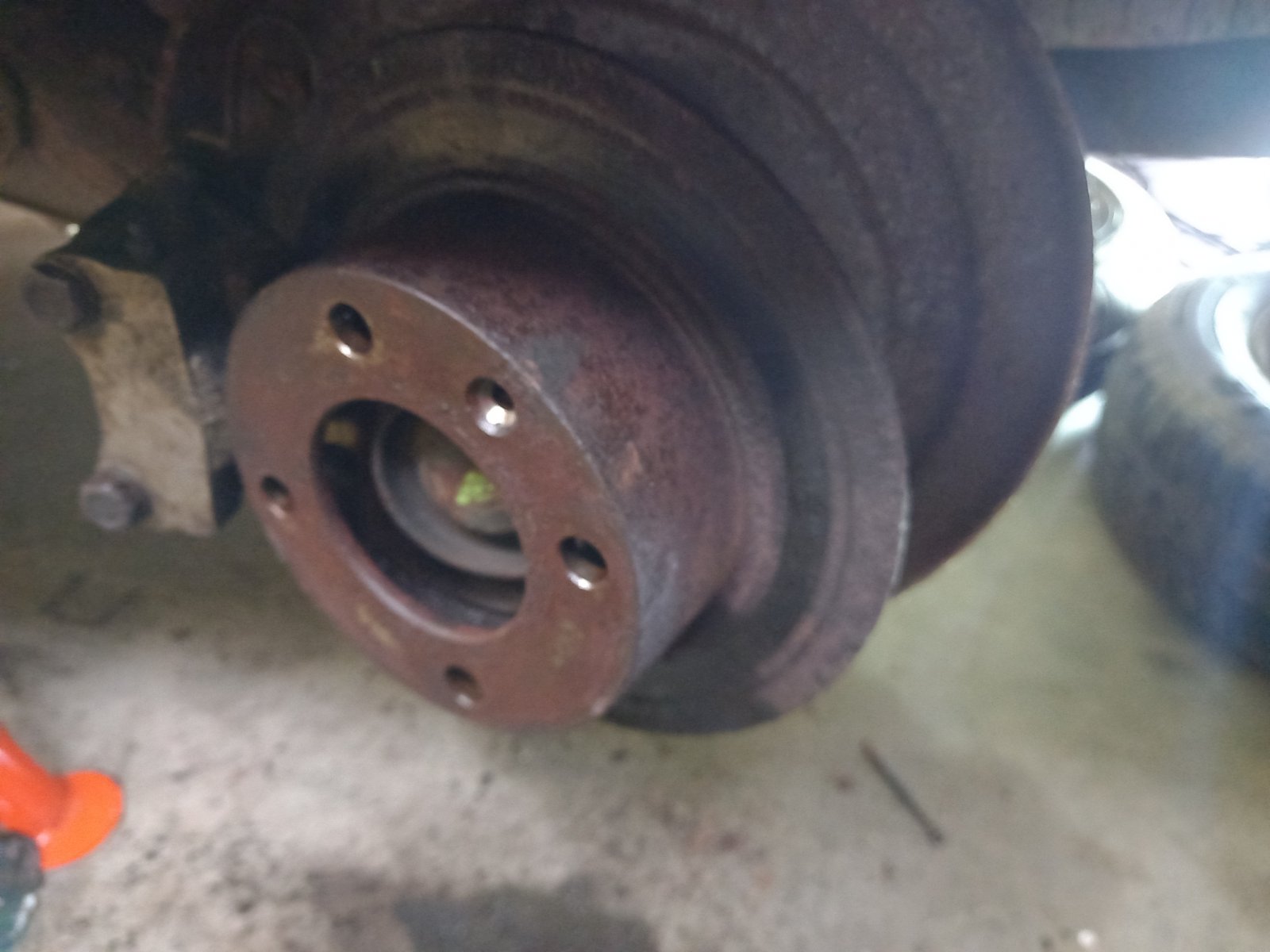

Supposedly because the disc appears to be rusted firmly to the hub; I've tried plenty of Wd40, some heat and mallet whacks to no avail before having to call it a day. Photos attached.
Any ideas? Am I missing something? Current plan is to try the same tactic tomorrow, perhaps the heat and contract method will have loosened them up a bit. Optimistic!

Yep, that's rusted on nicely, they do that , it's probably never been off the car as the rear brakes are very frugle and the liners coming away is quite common as yours have.
As for removal a 10lb sledge hammer played some part in it, try to hit the back of the disc from the underside and away from the hub, some can be very stubborn.
I've had to cut one off with a grinder many years ago as it wouldn't budge.
A hub puller would work if you have one big enough.

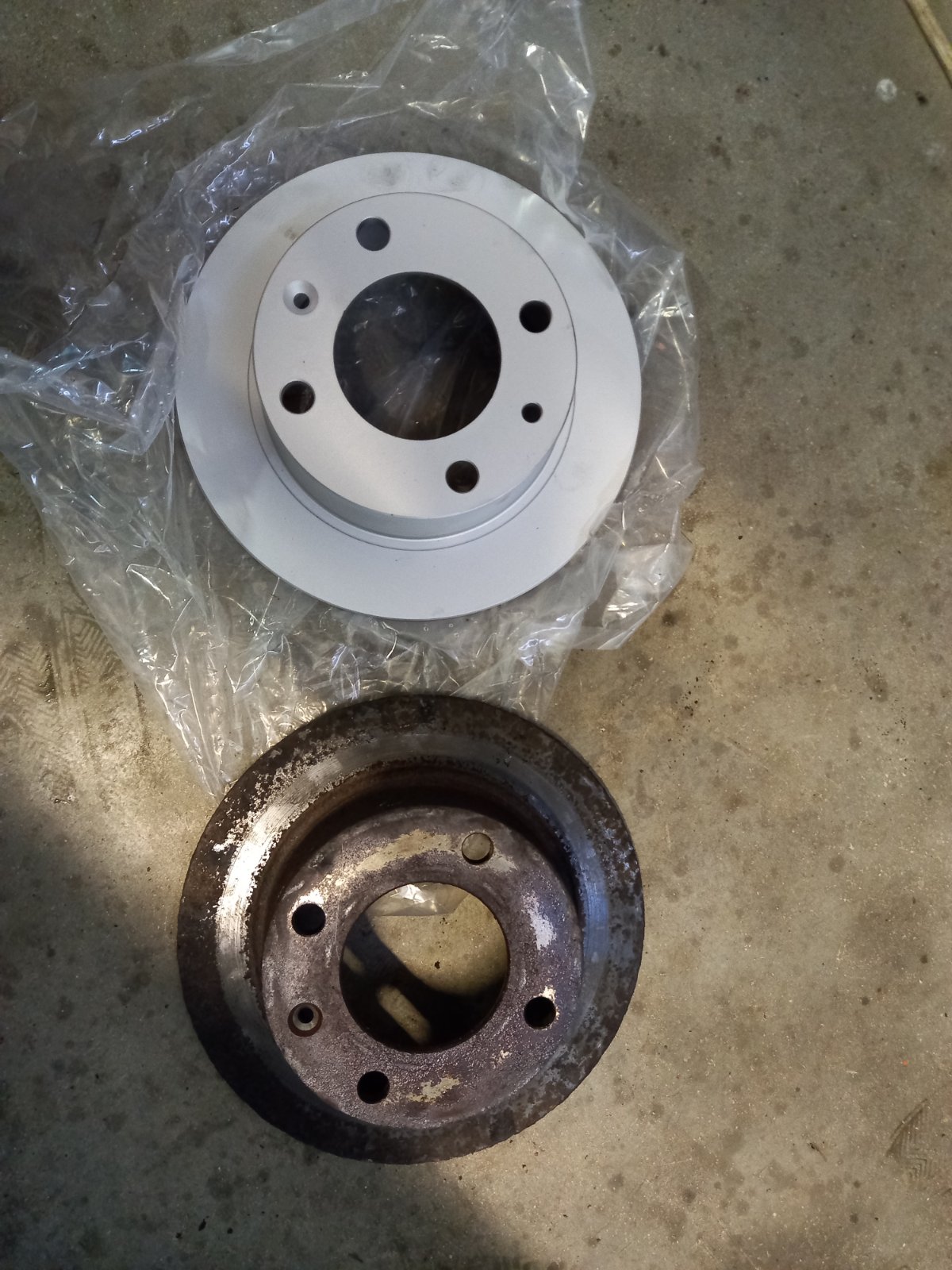

This afternoon I tried again with plenty of heat and whacks, heated both sides twice, no joy. I was about to give up when I thought of using my heaviest hammer again and smacked the disc at an angle and hey presto! off it came. Went immediately around to the other one and did the same with the same result. To say I was chuffed about that is putting it mildly. This weekend I'll clean it all up and fit the new discs and pads then take her for a test.

Well, fitted the new discs, cleaned up the calipers to be able to fit the new pads and was also able to push the piston calipers back. Only puzzle was how to fit the wire spring but I think I figured it out, it seems to tension the pads in position - always surprises me a little how primitive some of these things are! Anyway tested the car and it appear to brake a little better than before. (small note photos were taken before I degreased the new discs).
