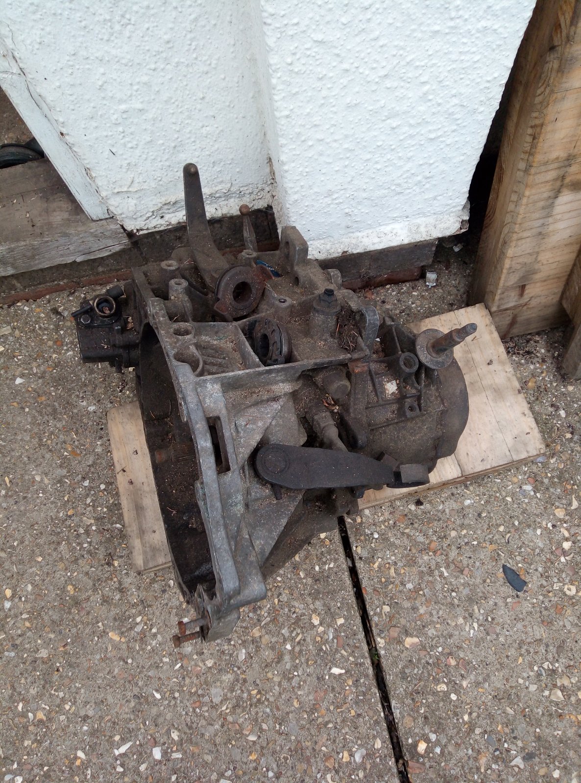

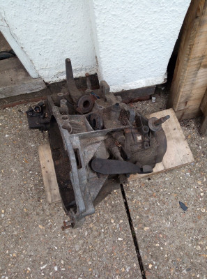

5sp BE3 from a 91 car circa 85k miles good sound box no whines, needs a good clean, speedo drive pinion and clutch arm ok, ideal for gti 5th gear conversion or TD type clutch cable conversion (as opposed to the awful push rod type 1.9d)
Offers
Collect pe12
Also very good cond TD bonnet liner/insulation panel, offers

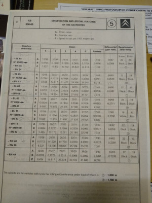

Here is the gearbox ratio table. However the tables do not show 4x4 box ratios but if it has the standard 8v GTi ratios then the TD 5th gear would be impossibly high so you would have to swap the final drive as well from the TD box.
I have a spreadsheet calculator I used in 2004 which takes the work out of the maths. I could send if that would help.

That table is a great help Jaba!
From what I can gather from it, I think that mine has the gear ratios for the 16TRI or 16V. The final drive is a 14/62, & the other speeds sound about right. That'd explain why it seems so low geared.

Just to let you know Jaba, there's an error on that gear table. It could be that the gearboxes were modified after it was made, but the gear ratio for 1st gear in the TD box is 11/38; not 12/39. The rest are correct. (For the TD box anyway).
I'll post the gear ratios for the 4x4 box when I pull all of the gears out so that you can add it to the table. It might come in useful in future.
Currently, I'm inclined to think that it's essentially a 16v box, but with a lower ratio 1st; as I remember it being exactly the same as the 1.7 diesel, but I'll confirm my suspicions when I've dismantled it again.

Alright, I have some answers on these gearboxes! I had a Peugeot 405 mi16x4 gearbox which I've just disassembled; That had the gear ratios for the 6th or 7th one down in your table (that you wrote 16tri & 16V next to), only 1st gear is an 11/38, the same as the TD box I've just dissassembled, and 5th is an 35/28. Everything else is the same.
The Citroen BX GTi 4x4 gearbox is the same as the top one on your table, only 1st is an 11/38 again, so the ratio for 1st must've been changed in later production cars. You've wrote 17 diesel next to that one, so that explains why I found it to be exactly the same as the diesel gearbox that I disassembled years ago!
Oh, the 4x4 transfer box drive cog fits nicely on the 14/62, 16/67 & 16/63 final drives that I've tried, so I assume that it'll fit on any of them!
