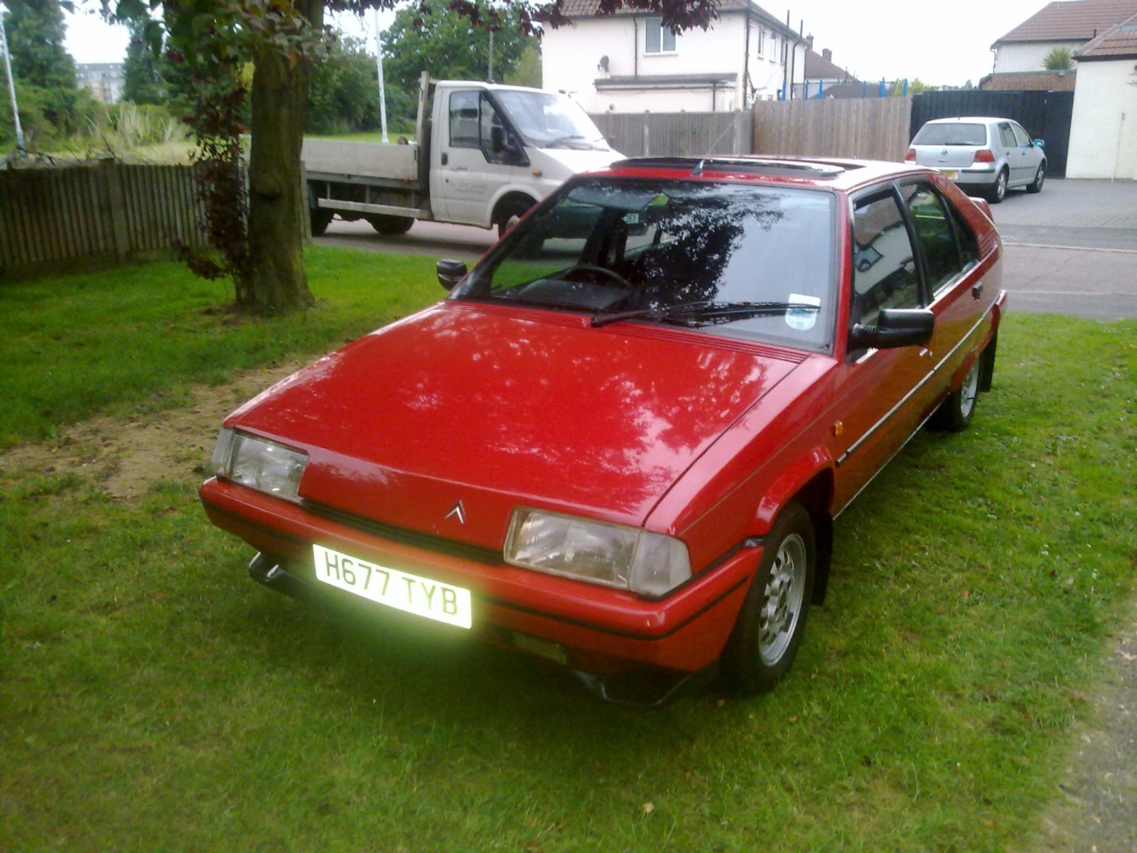

this is my tzd turbo with some pug 205 gti alloys on, picked them up locally off ebay for about £50 for 5 rims they were in quite good condition just needing a little attention and a coat of Wurth wheel paint. seem to be plenty about on the bay. you will need longer bolts for this type.

Could you put that picture up again of the tzd with the 205 alloys please.
