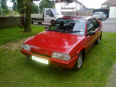

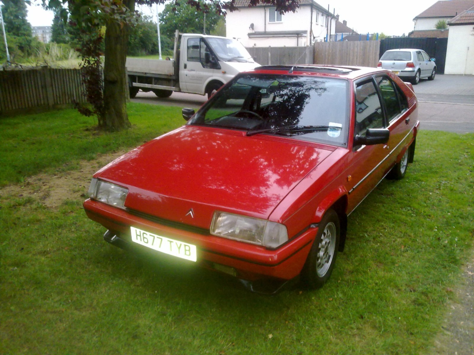

this is my tzd turbo with some pug 205 gti alloys on, picked them up locally off ebay for about £50 for 5 rims they were in quite good condition just needing a little attention and a coat of Wurth wheel paint. seem to be plenty about on the bay. you will need longer bolts for this type.
