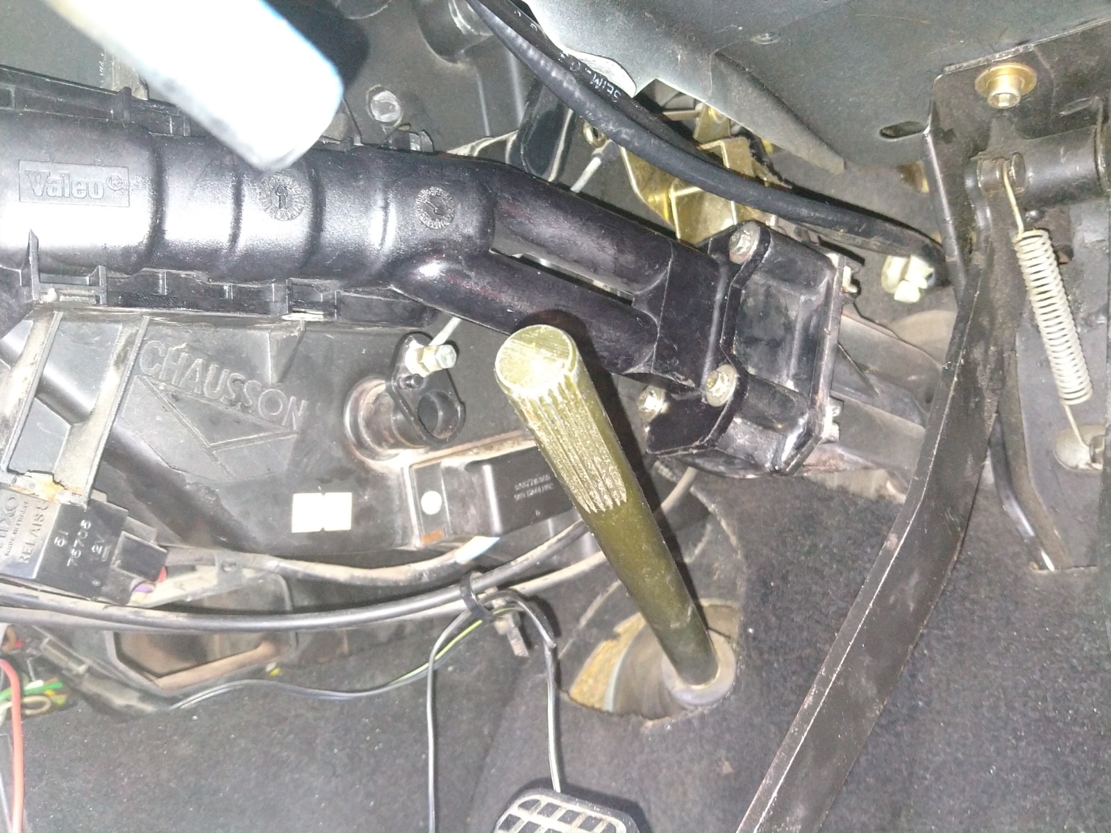

Trumpets sound and Angels cry for joy hallelujah hallelujah hallelujah hallelujahhhhhhhh - it's in and not leaking :D The seals had been displaced but luckily I'd bought two sets by mistake (thought they were sold in singles). So I shaved a couple of mm of each edge face and offered it back up. A lot less difference in the hight of the faces this time and so using the greasy scraper I prised them over each other easily and carefully drew the blade out ( which wasn't tight) and buttoned it back up. I made a platform to lie on this time made from a caravan step an a sheet of ply which made it a lot more comfortable.
Ran the engine at full temperature for twenty minutes and not a drop was dripped
Just need to put it all back together now.
