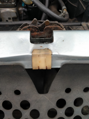

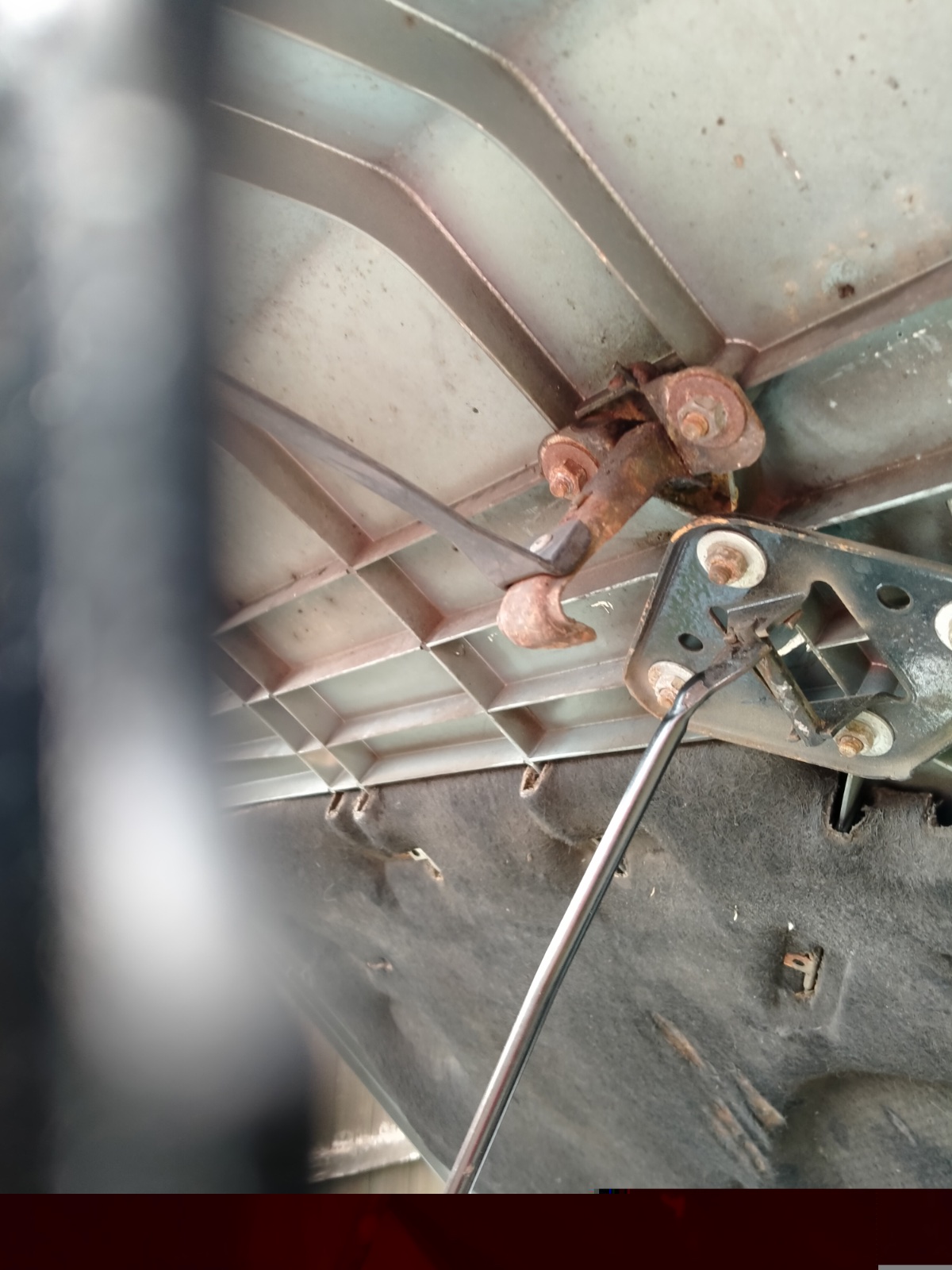

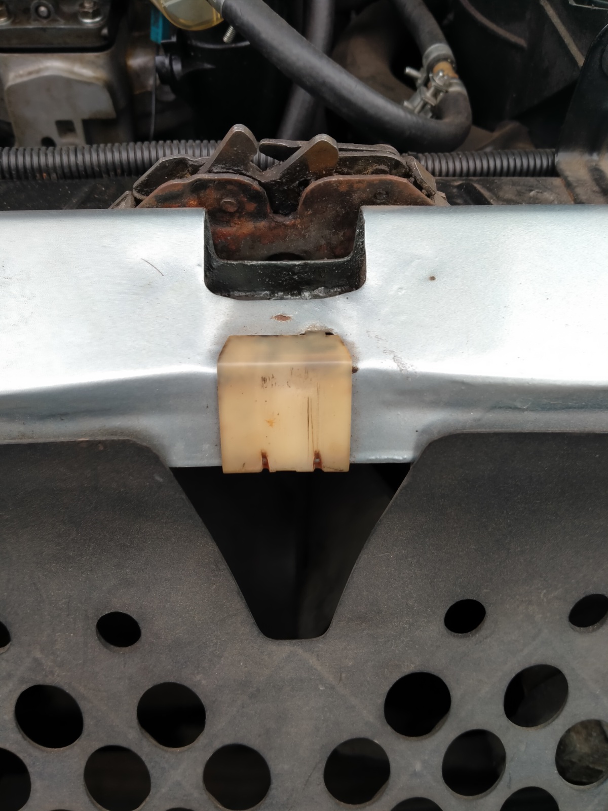

You should be able to grab the catch with a length of stiff wire bent into a hook. On my GT the safety catch hook slips over the plastic part in the second photo. Hopefully it's the same on a Mk 2.

In the absence of finding an open bonnet to see what I’m grovelling for those photos cover it nicely!
