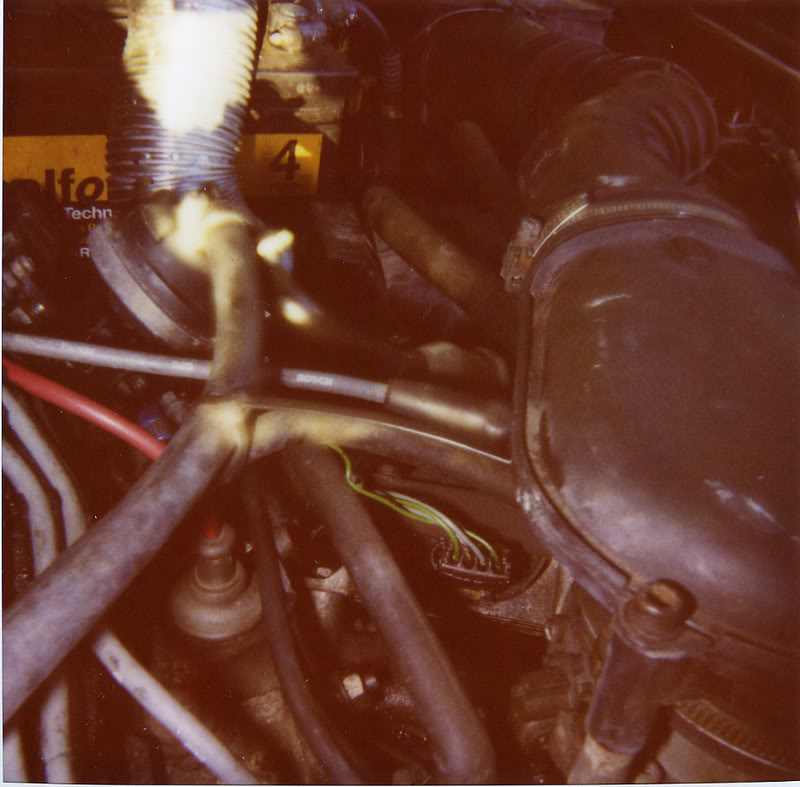

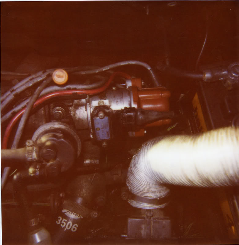

This is all good stuff, thanks guys
Ellevie: No the first guy to arrive from Westbourne recovery (sent by the AA) didn't verify the coil was good. In fact he didn't do any electrical tests whatsoever apart from the rudimentary spark test...
The difference between the ignition circuit pictured, and the set-up in my car is that mine has a small wedged shape coil mounted near the fuel filter, with a single multiplug connector instead of spade connectors, and the ignition module is bolted to the side of the distributor.
The wires from the ignition module hang perilously close to the wires from the engine temp sensor switches and the braided battery clamp earth lead, and they're partially wrapped in dirty old insulating tape. I'm not sure it's possible to dismantle this loom in the same way as the setup on your 19TRS.
There is a female spade connector on a wire sprouting from the coil multiplug that goes to nowhere. Anyone know why this wire exists? I remember finding a similar redundant wire on ren16tx's St Tropez.
Stu: Yeah I was slightly furious, considering the first guy to turn up and pronounce the car dead... was driving a flat bed truck. When he called back to base he was told by the AA that he couldn't take me away. I had to phone to upgrade to Relay and then they called out a second truck which was another 45 minutes.

I wonder if the orphan connector is intended to be a diagnostic test point. Perhaps it may be possible to measure the 12V supply at this point --- it's probably just connected to one of the low tension terminals on the coil.
Could you post some pictures of the ignition circuit from various viewpoints ?

Seem to recall that there are (at least) 2 ignition setups for 16/19s - Bosch and Ducellier.
My feeble memory suggests your is the Ducellier (working on the colour of the dizzy cap, which might be a red herrring). I'll have a quick look in the 15/16/19 Petrol Revue Technique manual and see if that has any more info as it often has some of those little things Haynes bypasses . It might also have some indication of your spare socket (not uncommon on petrol BXs AFAIR). I've seen the module in a slightly different position on other BXs but the installation is equally messy as it's always on a goodly bed of heat-sink.

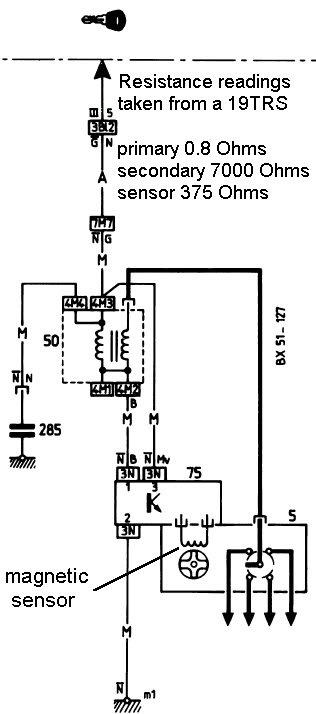

Thanks for the pics, it looks like the circuit you've got is something like this,
It's difficult to see from the pictures but I am guessing that in addition to the 3-way connector on the amplifier that there is a 2-way connection directly from the amplifier to the sensor in the distributor housing, just to the left of the 3-way connector. Can you confirm this ? If this is the case then it looks like there is even less to go wrong compared with my 19TRS which has two cables and 3 sockets between the sensor and the amplifier.
From the diagram, it looks like your spare connector is in fact the one shown going to the capacitor/suppressor/condenser.
You said something earlier about insulating tape on the cable. If this looks like a diy job then it's probably worth cutting this away to see if a wire is broken underneath.
You should be able to measure 12V on the 4-way connector on the coil with the ignition turned "on". It looks like you should be able to stick the meter probe down the back of the connector. The 12V should be available on all 4 contacts.
If you have not done so already, apply a squirt of WD40 or similar to the contacts in the 3-way connector at the amp and the 4-way connector on the coil and push them on and off 3 or 4 times to clean the contacts. Do the same for the connector between the amp and the sensor, if applicable.
Using the lowest resistance range you should be able to check for continuity of the two wires between the coil and amplifier connectors. Also verify that the third contact on the coil connector has good continuity to "earth". See if you can identify where this is bolted to.
The diagram shows some readings I have taken on my 19TRS. Hopefully you will be able to read something similar on the TGS. The 7000 Ohms reading was taken from the HT to LT connectors.
If the 12V supply and earth connection and cable connections check out ok, then it will be time to look at the individual components.
