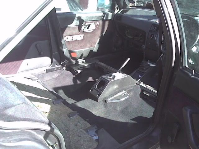

What it was worth doing though, was picking all the best bits from it to go on Mark's current meteor. Sunday afternoon, and it looks like this:

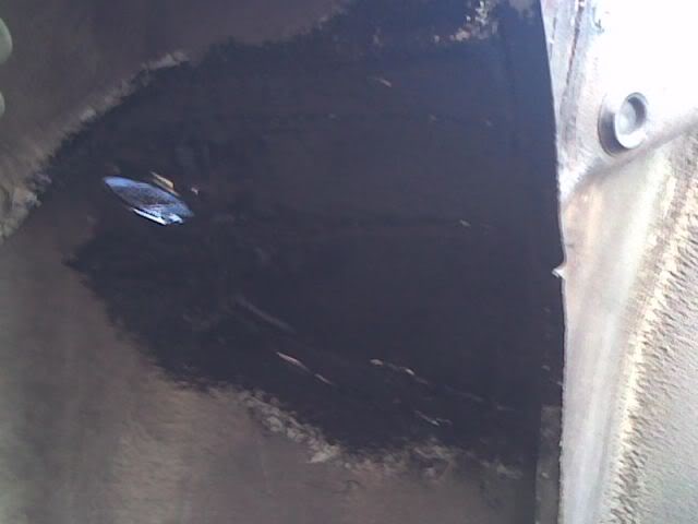

We start changing doors, front wings and bumpers, but then found this:

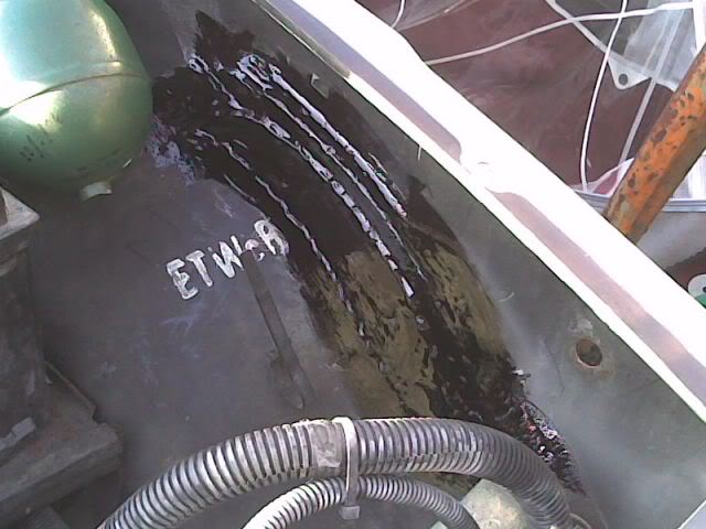

Which was a bit of a pain, as there was already the standard inner wing corrosion to sort. Hmm.. lets have a look and see if there's any more. Guess what, there was this, under the N/S screenwash tank.
and yes, that goes through to the car interior. Bummer. Hmm.. what about the other screenwash reservoir?
Surprise surprise. Right then, that's 4 areas of corrosion to sort.
Thankfully, I'd kept various other bits of the other meteor, one of which was the roof, so the metal I welded in was genuine BX meteor metal!

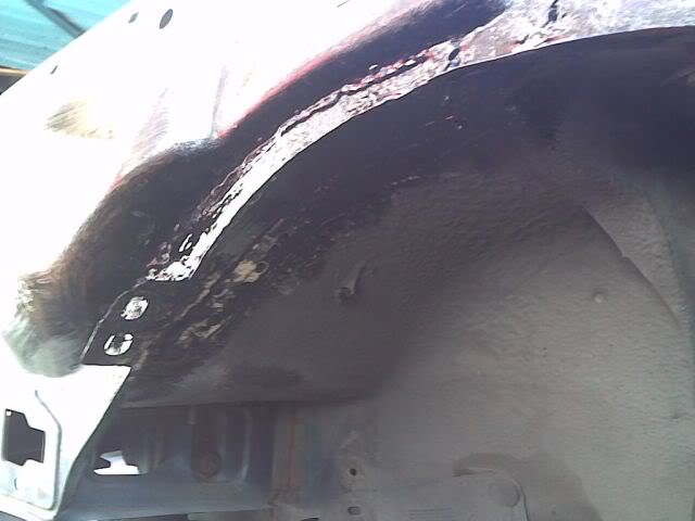

Inner wing welded:
Other inner wing welded and painted with black bitumastic paint:
Scuttle welded and painted too:
Along with the welding, we changed 3 of the 4 doors, the wings, bumpers and did an oil and filter change. Still some issues with the front suspension to sort, but at least the shell is now fairly solid.
The paint looks messy, but with a Zinc based undercoat and a bitumen based topcoat it should outlast the rest of the car.

Outside of inner wing:
Forming the lip that the wing liner clips onto was a little interesting, but a grinder and a hammer are surprisingly effective.
Inside after painting. Had to be careful not to cover up the paint code. Twas close.

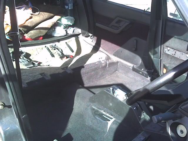

That was the welding, but the interior had come out too. It always amazes me how big the interior of any car is when it's got no seats in it:
That's where the interior which is currently in "for sale and wanted" came from.
