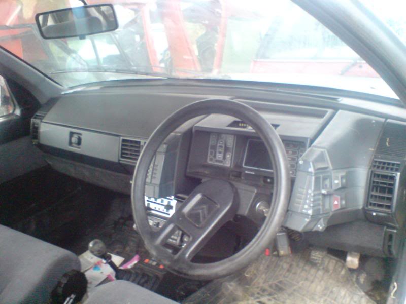

Mr. R. - you don't own loads of junk! I'd love to stay in a place like yours! and here's a quick snap of the legendary DIGIT dash for good measure
