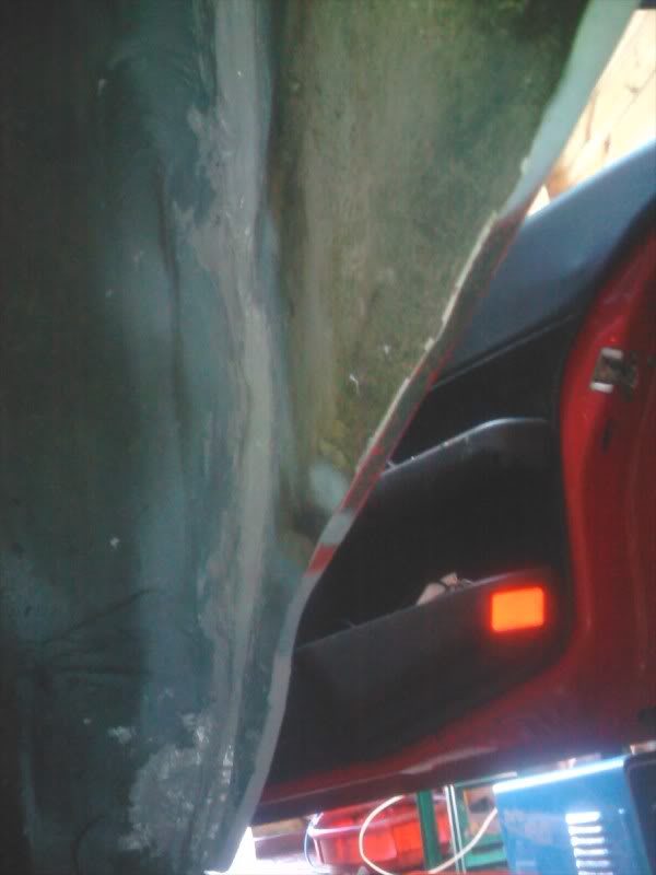

Paint was still a bit soft yesterday, so sealed the seam today although BX having to take second place behind house chores.
Starting to think the end is in sight though!

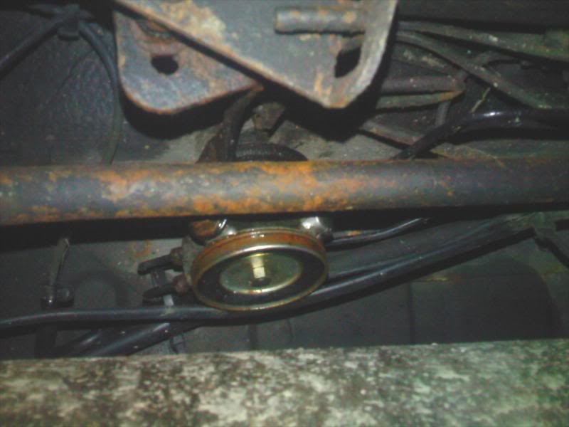

No progress on the red BX, but fixed the driver's mirror on the white one, and had a look underneath it. All looking good so far! The leak from the rear height corrector is so small as to be (IMO) insignificant, but seeing as I have a rebuild kit I'll strip it down anyway.

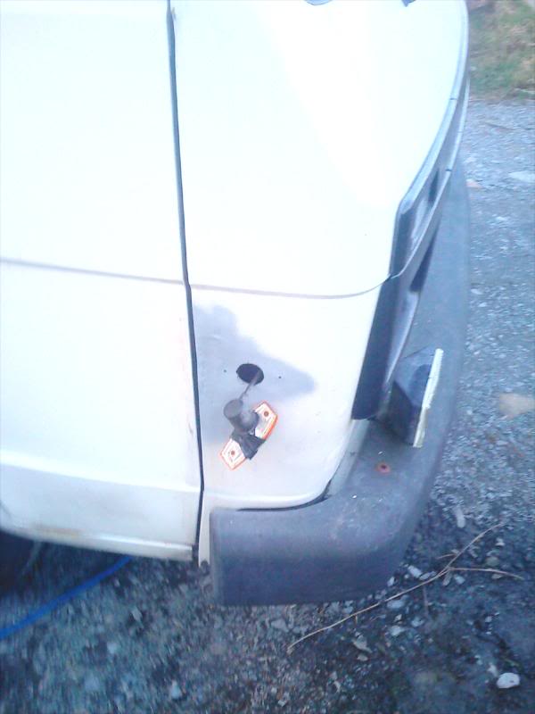

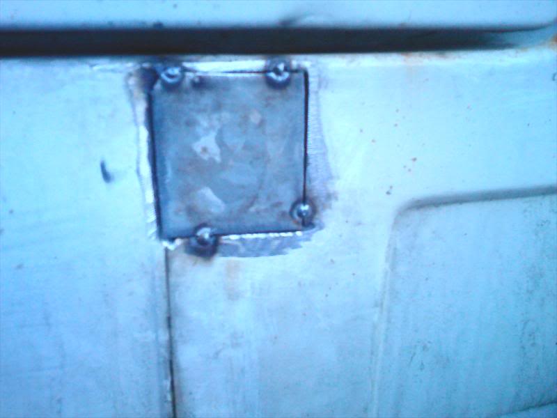

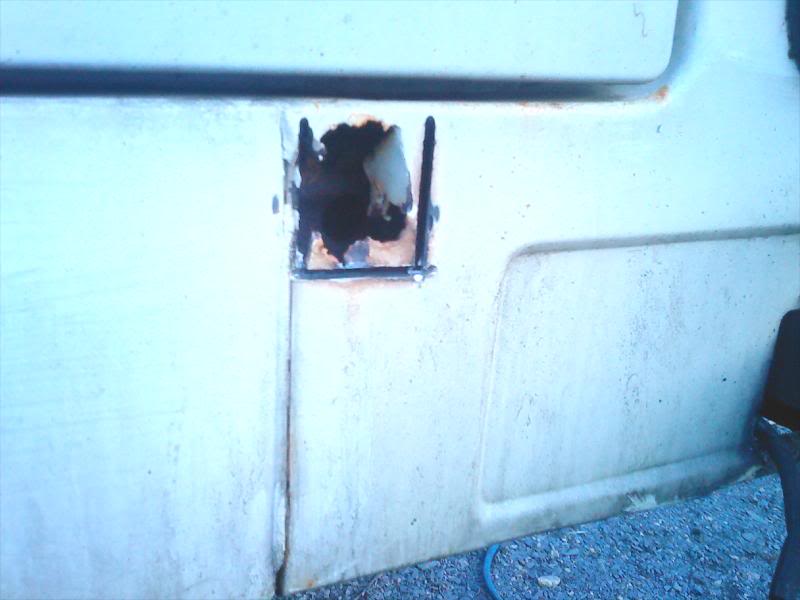

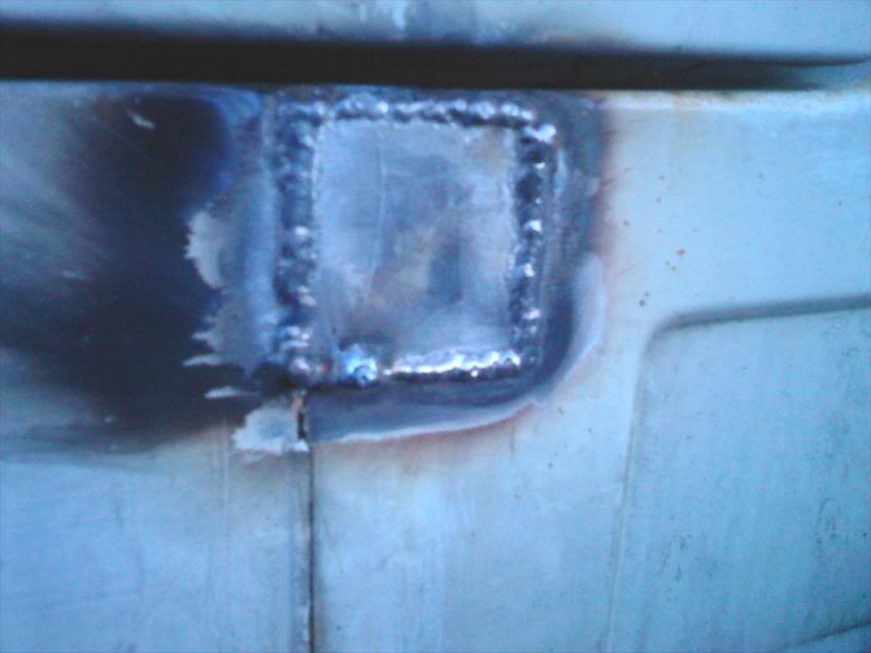

Also managed to do some work on the van this evening - it's not often that the weather is dry enough to weld outside so I have to make the most of it even though it is absolutely (literally!) freezing out there.
Still needs a skim of filler before a top coat, but solid at least now!

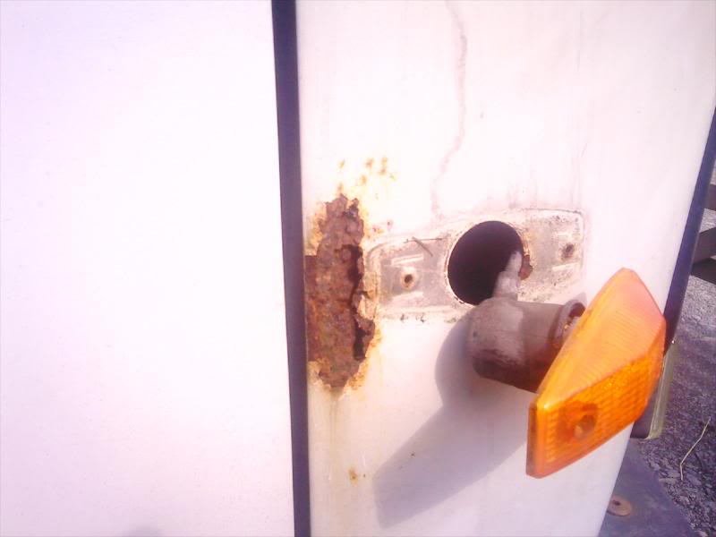

Plus lots of little patches like this one - quite satisfying to do as each one only took half an hour or so to do.
I'll probably get away without filler on this one, as it will be hidden behind the bumper anyway.

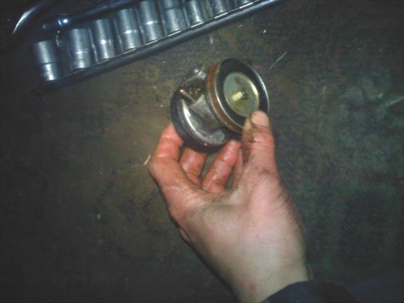

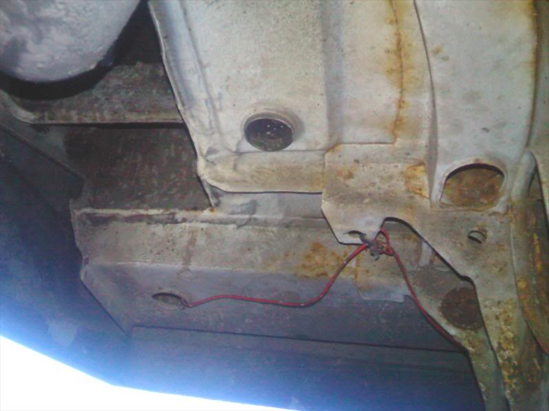

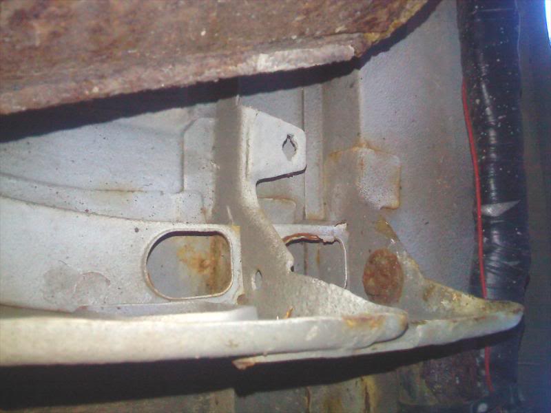

I took the height corrector off the white BX today in preparation for replacing the seals - pleasantly surprised both how easily it came off and at the condition of the boot floor and rear crossmember. Even the exhaust hanger has never been welded, and is still attached! Bad news is it needs 4 new tyres, but the fact it has Michellins all round suggests it was well cared for.
'Interesting' wiring for the towing electrics - if I leave the towbar on I'll have to sort that.
A slight weep is visible, but nothing to worry about IMO - I've been given advisories for bigger leaks than this!
Off in my greasy (and by this point frozen!) little mitts!
Will hopefully strip it this week, but a warm bed is now calling me...
