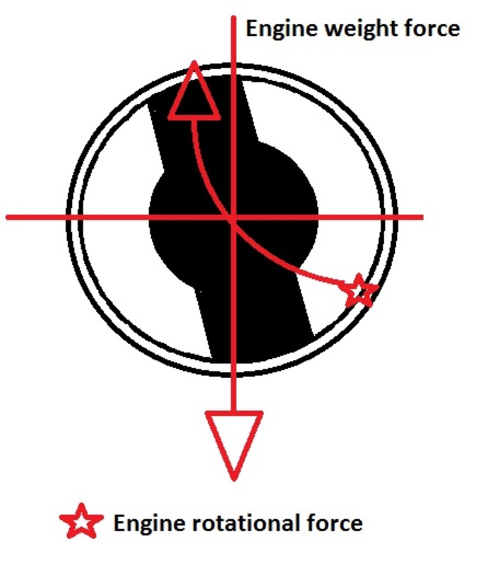

About its direction, i thought something like this, putting in a slightly angled position:
But i think the priority of this bush is countering the rotational force.

Reading again, i'm thinking about the movement that the bush housing makes when the engine rotates...
If its front rotates up, the bottom part rotates down, so it could be the opposite angle that i drew :roll:
