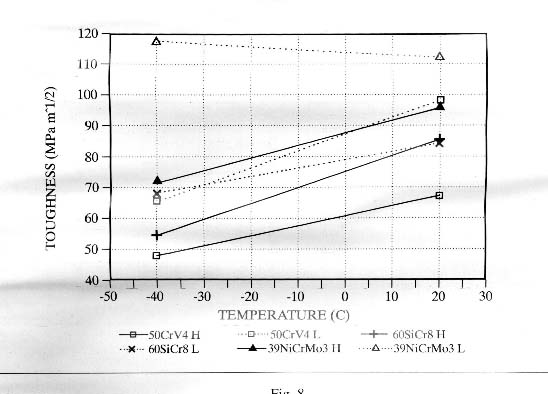

Ah, something I'm qualified to comment on! From the steels used for springs, Cr-V steel is probably the most susceptible to temperature effects. Going from +20 to -40 °C it will lose about 30% of its toughness whereas the 'best' (in this aspect) will be very similar.
I really can't see any significant difference in temperature with use, apart from the heat of the engine affecting the front springs, and we're only really looking at a small part of the graph. But if something is marginal, the weather may tip it over the edge...

That graph only shows a pretty narrow range of operating temperatures. It would not be too unreasonable to expect -50°C or colder in Europe in winter with wind chill, to over 50°C ambient in the shade. So you could cover say far east of Germany and Poland in the winter (or the Alps) to Sicily in the summer. Anti freeze goes to -36°C which you can get close to in the Alps but not southern England.
When selecting materials for some projects I have worked on the diurnal range or seasonal range can be very important. Hence on the mobile arial masts you can get 5-6mm movement on the outer front cover compared to the back part. In this case you don't seal fully and you let the cover travel from one end. Same time you let it drain properly.
