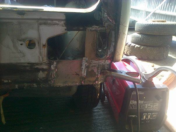

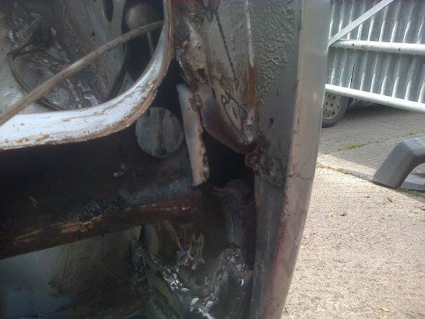

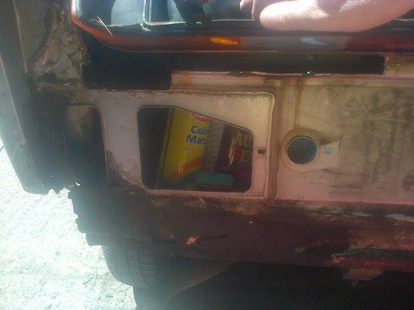

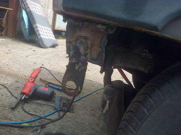

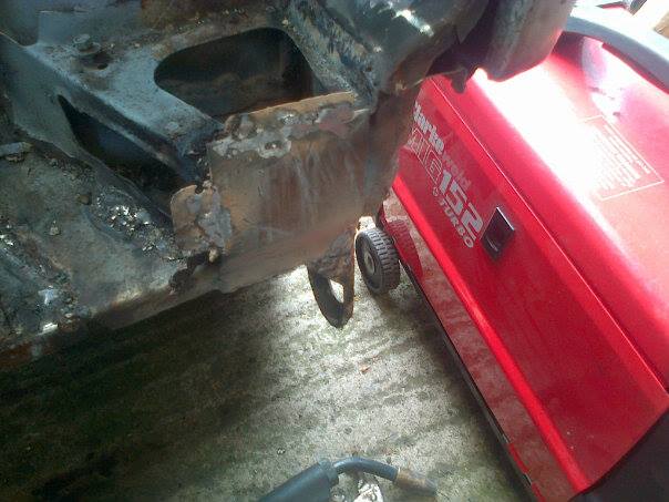

With the rot and bodges cut out it the hole just gets bigger and bigger

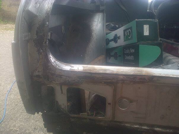

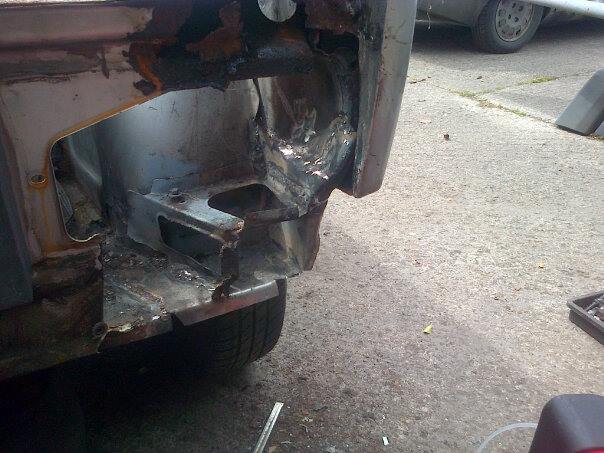

New metal welded into the trailing edge of the inner wing and the boot floor
Lower corner closed off with new metal
Same repair from the other side - I got the rear edge slightly wrong as I didn't have much to go on, but luckily had enough metal there to reshape it.

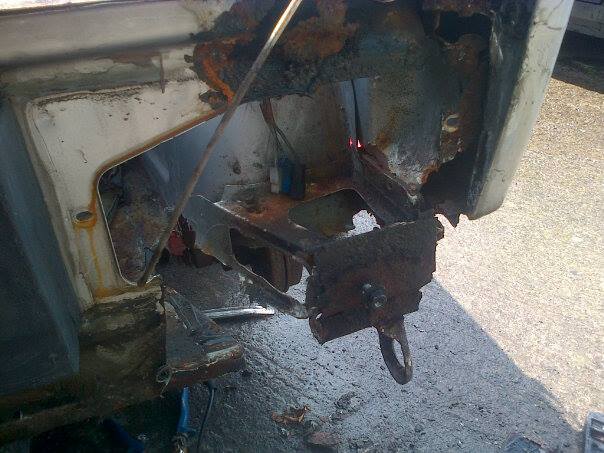

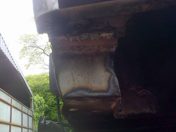

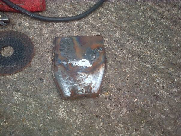

A new bumper mounting plate welded in - slightly smaller than the original but also slightly thicker

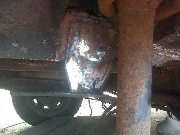

Towing eye welded in - it was originally on the other side of this panel, but this was easier

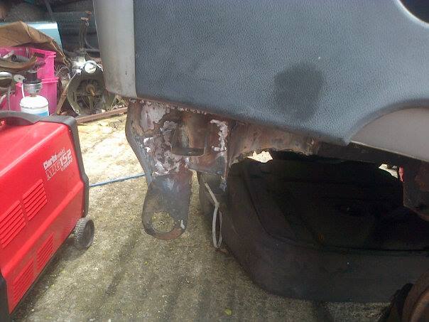

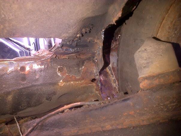

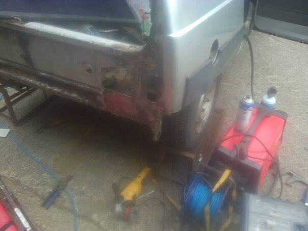

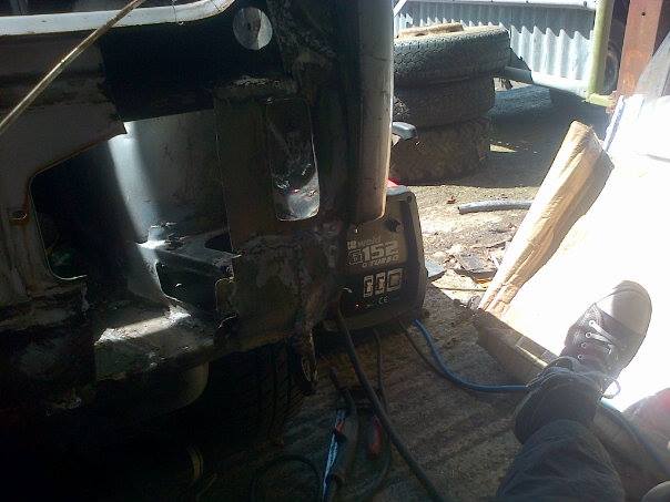

With all the rust cut out of this end of the back panel, this small repair was needed to the inner structure
Again made up the new metal piecemeal, this time so that I didn't scrap too much if I got it wrong
For some reason I don't have the completed back panel repair to hand, so I'll take that pic again when I next go down there
Bumper end mount made and fitted

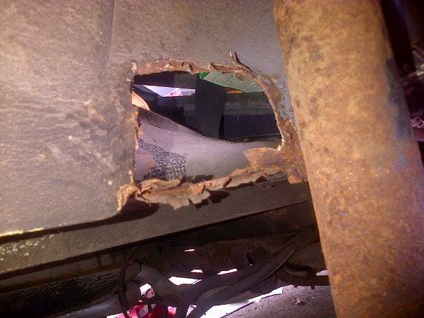

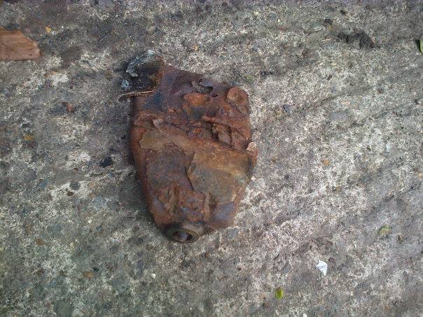

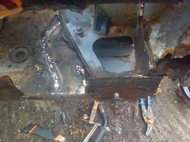

I decided to remove the fuel tank mount as it was holed and rusty
This is the hole it left

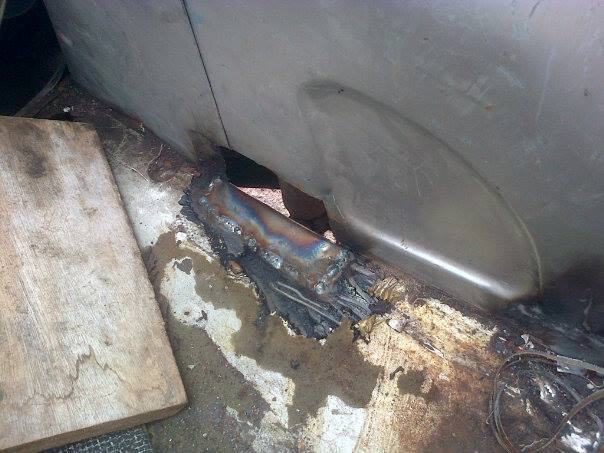

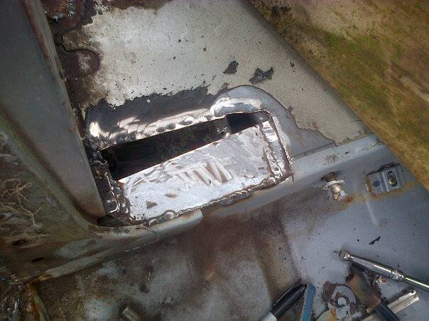

Mount with rust removed and a new section welded in
Repairs made to the boot floor and inner wing before the tank mount could be refitted
Tank mount back in place, fitted by a mix of plug and seam welding

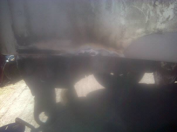

I bet you can't guess what I did on my days off last week - Welding the Visa!

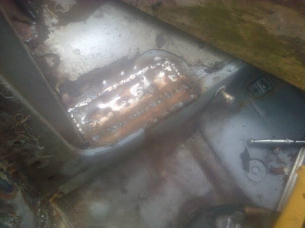

This is the front RH corner of the boot floor from underneath:
With the rust cut outI started putting it all back together again
This is the reinforcing angle repaired

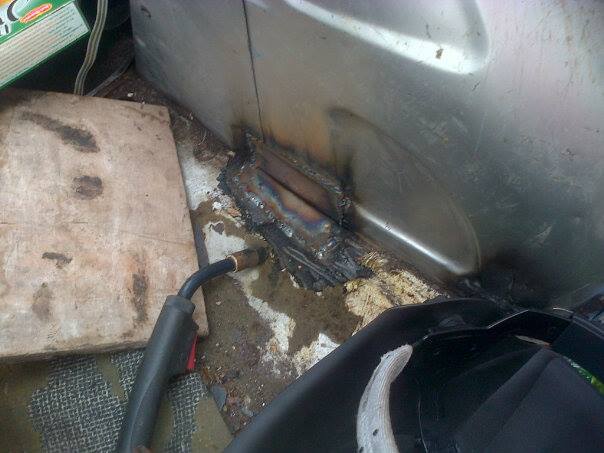

Then the boot floor and kick plate repairs were welded in
As I seemed to miss it last last time, here's the completed rear corner

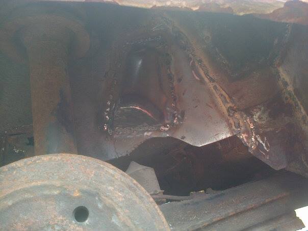

Excuse the poor quality of the next few pics (what I thought was poor screen was a dirty lens :oops: [-X ), but this was typical of the wing inner skin.
The rot was again cut out, the inner surfaces of the wing and repair sections painted, then the whole lot welded up

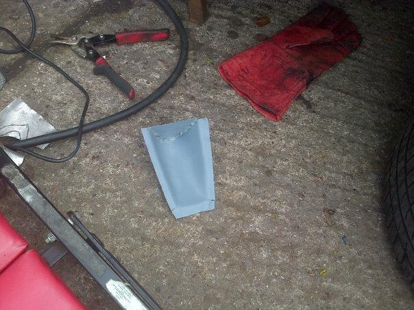

With a clean camera lens, I then started on the back panel under the tailgate aperture

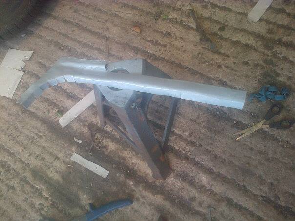

One of the repair sections I made
And the same section welded in

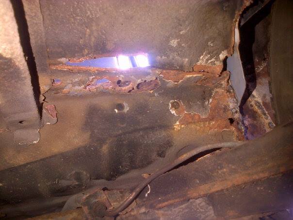

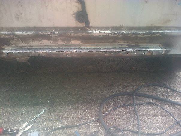

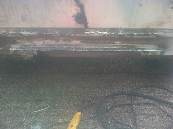

A wire wheel across the bottom of the panel revealed more rust, which was cut away to reveal a rearedge of the boot floor that wasn't much better
Everything trimmed back ready for new metal
And it all welded back up again

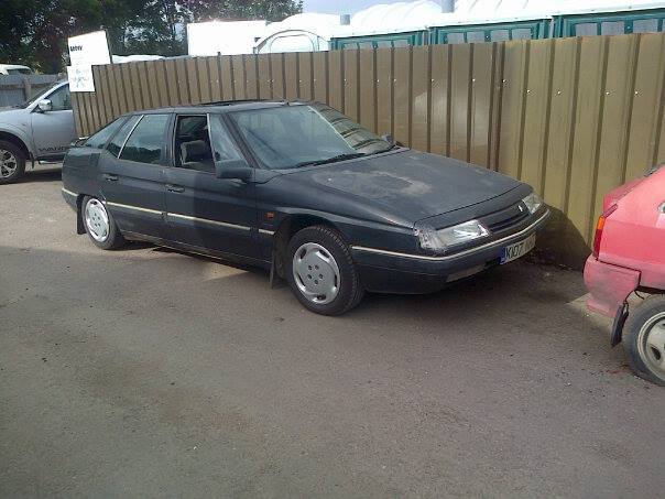

It's a 1992 XM Turbo SD, which for those who don't know is the mid range 2.1 TD, in this case with manual gearbox - unusually for me it has more than a few weeks MOT on it and it runs! mileage is just a few thousand less then Timex, but unlike Timex it has a very full history file with a scary amount of work done over the years. Work so far has been restricted to painting the bonnet (which still needs work), cleaning and polishing it and trying to keep everything working on the damn thing! It's a great drive but I suspect it'll be a love/hate relationship while it drives me to distraction as apparently only a Mk1 XM can! her it is looking slightly shinier:

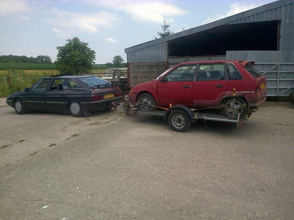

Took Timex out for the first time in a few weeks today, up to Gloucester to collect some paint for the XM, then to Tony Weston's place to collect some Visa bits - it's now loaded to the roof with the mortal remains of a C reg 10E. It was good to be behind the wheel again, much smoother ride than the XM, although the on/off brakes and the relatively low power took a few miles to adjust to again. After the XM it did bring home how bad the driver's seat is though, and it's leaking from the pressure regulator.
