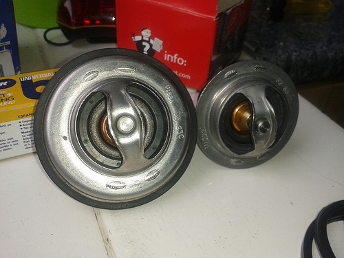

But in better news, actually managed to track down the correct thermostat! Who would have thought it would
be so hard? The correct one is on the right. Now, it didn't come with a gasket, just the ring seal. The parts shop
thought it would be fine to use some blue hylomar on the mating surfaces, and as there didn't seem to be any kind
of gasket there when I took it off, hmmm?

If it is the thermostat with the rubber ring seal then there isn't a gasket, both surfaces mate and seal on this rubber which fits over the edge of the stat. If either of the mating surfaces are badly pitted a small amount of blue hylomar can be used to assist the seal if required but not normally needed.
Ref. the brakes, they may just need the new pads to bed in?
