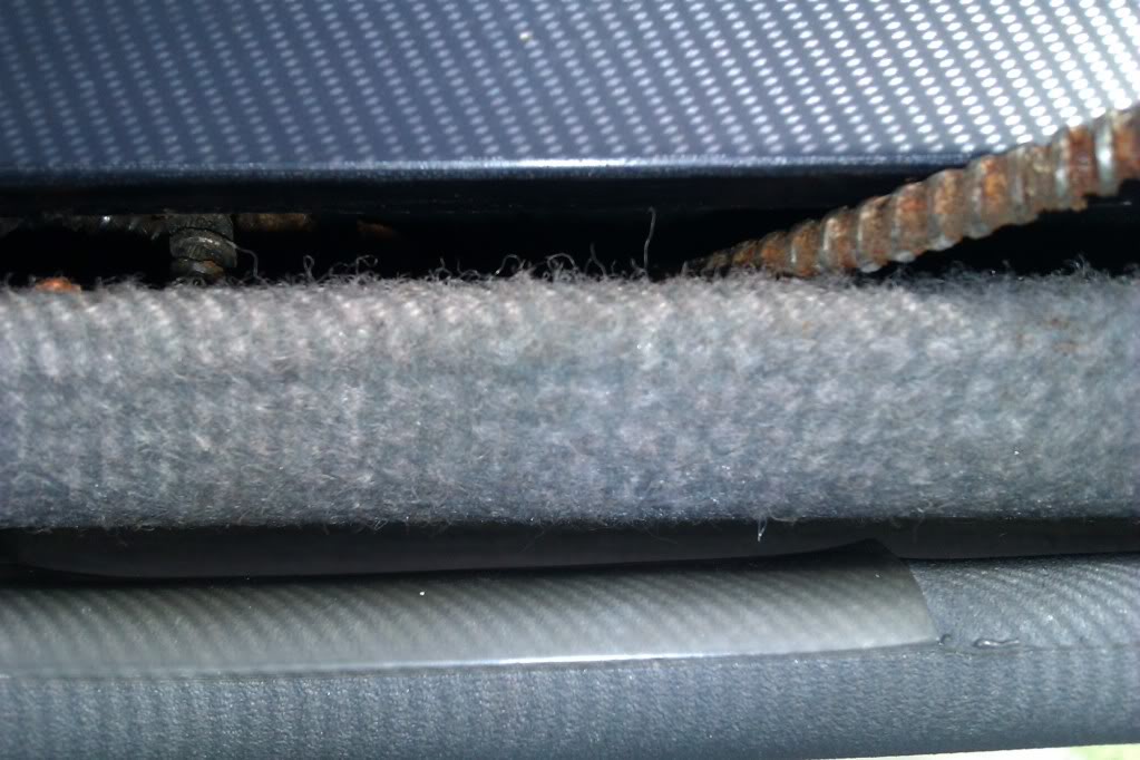

That's encouraging, 'cos after having a good peer and leaning a bit on the lining to see if I could see the cables, this happened:docchevron wrote:... even SMiffy's which had broken the steel top covers over the cables and jammed the roof. it's all about knowing where to hit it, and how hard!
They're all out of the runners by the looks of it

Re: Insert witty title here ...
ahh, that'll be broke then! I dont have a spare complete cassette, but I think I have some cables and lids...
