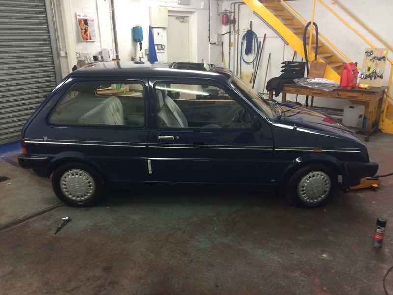

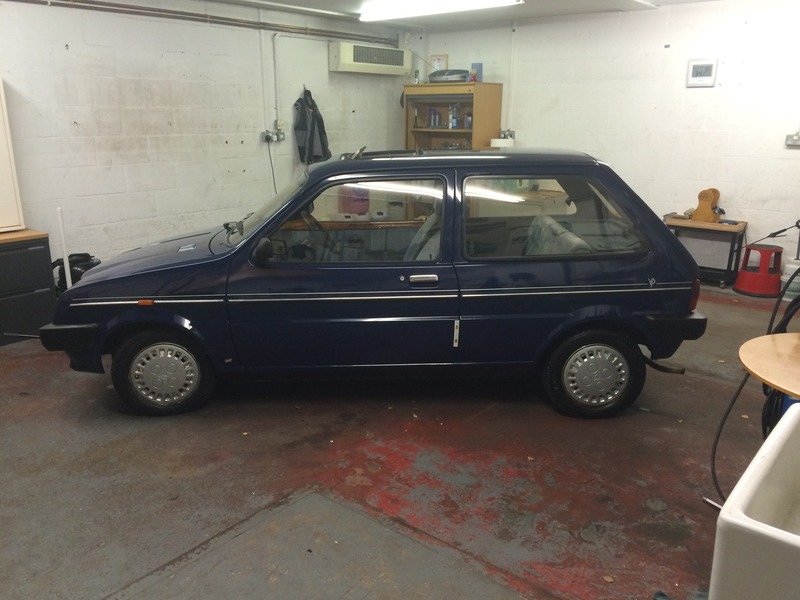

Well winter is very much here, effing cold this morning walking Jack, although he didn't seem at all bothered, progress on the metro is slow as I don't get week days off much now although working weekends are rare, but they are taken up doing family stuff/shopping etc!.
