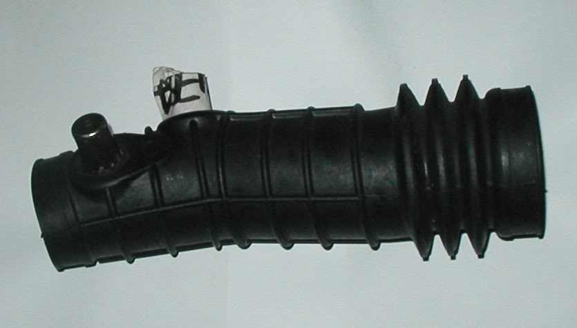

In my BX parts pile I've got what looks like an 8v GTi corrugated rubber air tube with two metal inserts. A sticky label on one of the metal inserts appears to show the part number 96631794.
Someone has suggested it may not be the standard GTi part - can anyone confirm what it is, from the part number or otherwise, please?
- Posts: 2030
- x 116
I don't recognise the p/no but what it looks like is the Mk1 GTi flowmeter intake. Also the TZi and 16v (I think) are similar, they have the Motronic 1.3 system.
It is deffo not for the later GTi with the Motronic 3.1.

DLM, I don't know how to make citroenservice search for a part number, but can confirm that the number does not match 8 valve 1.9 injection...

Sounds like I should have taken a peek under the bonnet of the E-reg Gti at Stratford... many thanks for the replies. Somebody did suggest it was for a 4x4 GTi as apparently there's a different setup on these. I may ask the local mechanic who's done a lot of work on a GTi 4x4 for one of his customers.
