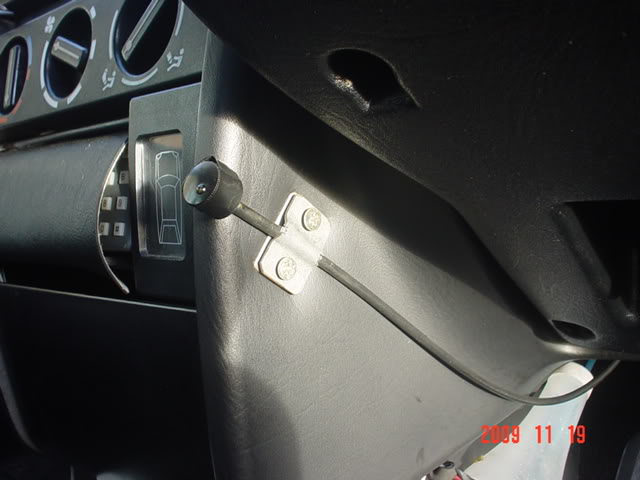

Hi Kiwi,
Some time ago now, when I replaced all the dash lamps "bulbs", I removed all the cables from the heater to lubricate --- Bad move.
No mater how I tried, I could not re engage one cable, it was just too short, so this is what I did.
Used an old radio knob from my junk box, bent a 90 degree on the cable end, used epoxy to fix it together.
Then made up a simple bracket and screwed to the dash.
Still working fine todate..

Looks like another modification to meMike E (uk) wrote:What's that unusual keypad for under a cover to the left of the door open indicator?
Mike
A scanner prehaps
1990 BX19 TZS Auto 06/11/1989
I reckon its one of those credit card cloning machines, pop in a card & up comes the pin details

"What's that unusual keypad for under a cover to the left of the door open indicator? "
Hmm,
I will have to stop posting pictures on my posts, you guys are too observant.
In fact it's the head unit of a converted pmr transceiver, working on the amateur band.
But you made no comment on the tomato sauce bottle.
I am not giving the reason for that away !!!...
Hmm,
