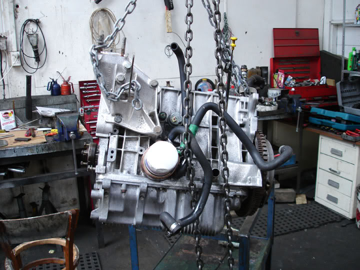

So here we are. Complete rebuild from the ground up-all gaskets, bearings,rings etc. Around $1500 worth of parts. Ouch. Plus engineers costs. No corrosion around gasket, little bit around the block, but all cleaned up.Valves were mint, as were pistons, liners, camshafts and crank. A bit of polishing here and there, but that was about it. Amazing for a 165000 mile engine. Liners re-honed no problems, everything went back together sweet as a nut. Thermostat ferked, radiator ferked, several hoses ferked,oil filler ferked-not anymore thanks to pete. Got mint set of rad hoses from OZ,and other stuff.Cleaned and repainted block, inlet manifolds,and other bits, and got cam cover sandblasted and powdercoated back to factory.
heres a few more earlier pics of reassembly....mostly thanks to my old man, who realised quite quickly that us workin on it only on weekends would result in gettin it finished around 2018! So he has reassembled bits and bobs during the week, after my frantic cleaning,polishing and reassembling in weekends
freshly rebuilt bottom end, all mint, bit of polishing, bit of measuring, all good with new bearings and seals
and cleaned and re-honed liners, with inspected and rebuilt pistons.choice

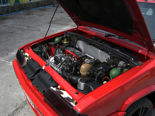

Heres the engine about to have camcover refitted
freshly sandblasted cam cover-magnesium rough as guts, was gonna grind 16v logo back, but gave up-coating got into the crappy casting and was gonna take forever, so went with good old silver pen!
Engine almost done...

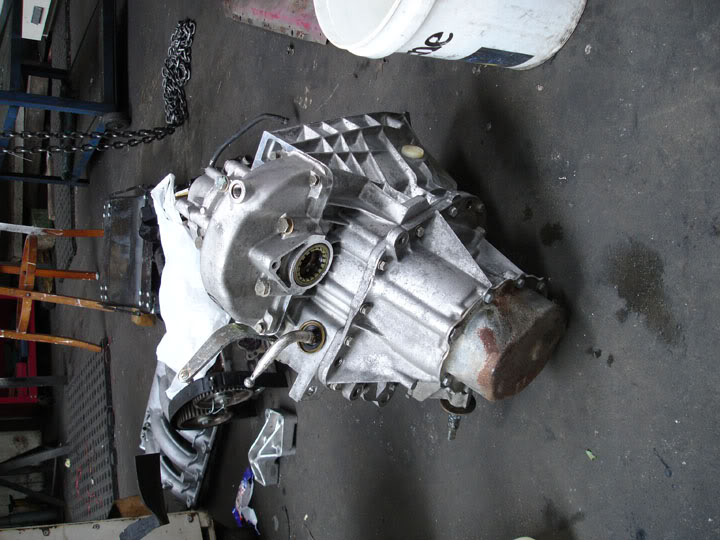

Painted ugly corroded gearbox end-will get everything plated on next one...

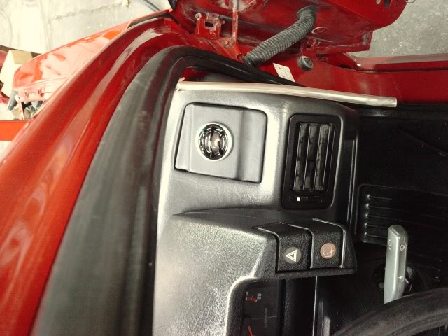

Here is the rooted heatertap.So clogged with crap it couldnt move more than 3mm.Lesson-keep water filled with antifreeze, use regular like, and dont let contaminants in.

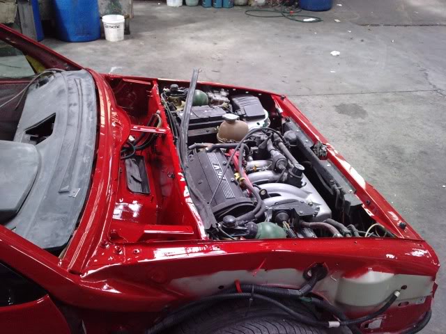

Engine 99% there, pretty much ready to go in....

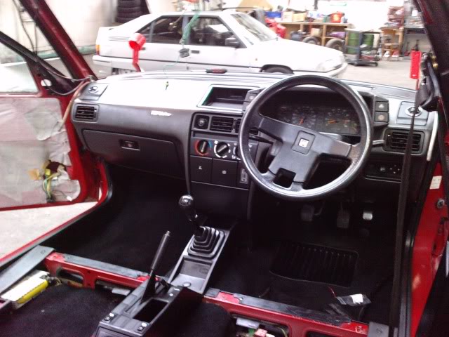

This is what you have to do to really get at the heater assembly-without removing dash.Might as well have in hindsight! Still wary as to whether
the dials actually work, so will put engine in and running,and get heater bits in to check it all before reassembling dash etc

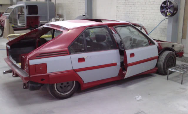

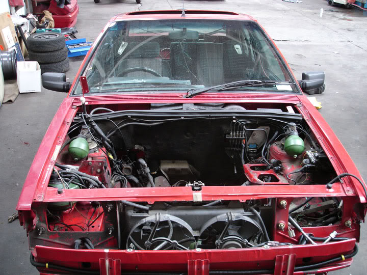

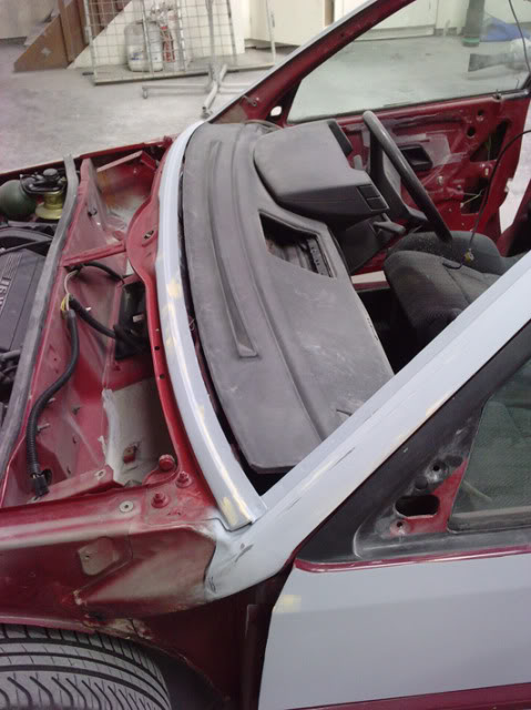

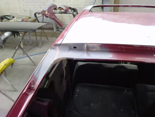

Well ,here she is at the shop, all the rust is out, shes blocked out, and ready for paint....needed left rear hinge and corner completely replaced due to massive rust from some monkey installing a roof rack incorrectly. And bad rust under water bottles, surprise surprise.
choice

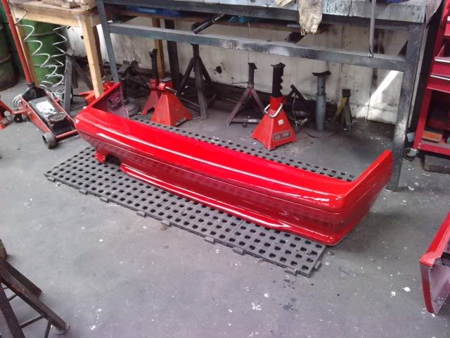

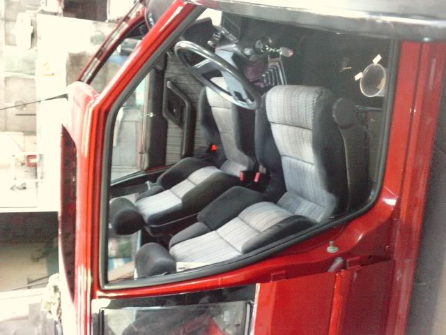

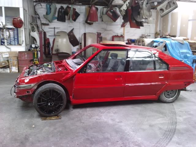

Cleaned her up a bit, still have a few bits to give a lick to, rear vents, heater vents, etc, but all good. Got the seats out,cleaned em up, will go back  and wetndry them next weekend.
here are the black 17s, should look beaut with them on. Looking at some tints too, and citroen centrecaps for the wheels-geeky i know,but want it just right
Sunroof is completely rebuilt, ready to go in, a few bits in bobs to take care of as she is put back together- Bluetooth headunit, all micced up etc
All speakers-building flush mount sub enclosure for bootfloor, as have got a shallow sub-no critics please, i know they have their shortfalls, but i dont want a massive box ruining my car!
New central locking system ala jaycar-works fine on my current whip,so in she goes
ipod dock hidden into clock tray-this is a maybe, might just stick with glovebox.tbc

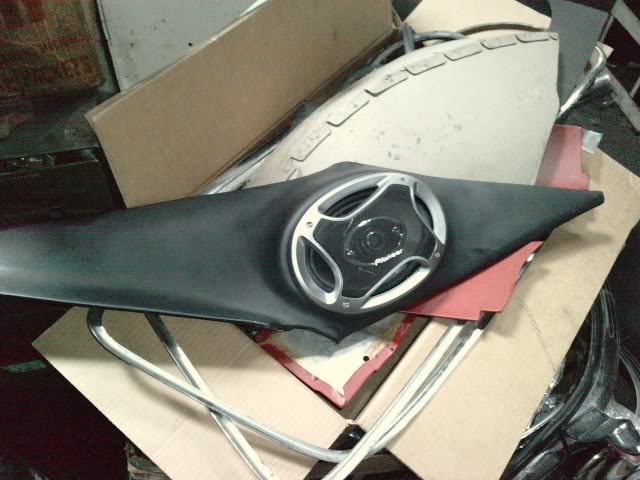

here are some pics, made up custom pods for the front splits and 6x9s, and the tweeters (out of spare covers). Ran untold wires too, for front two channel amp and rear four channel to run rears and flat sub.

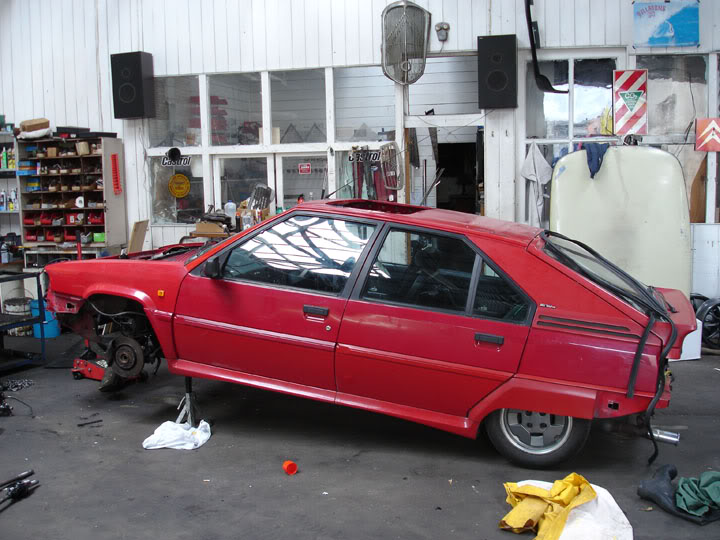

And the interior is pretty much in, got the roof in and on yesterday avo, sunroof works mint, drain hoses were a real prick to get back in. Dad has been UNBELIEVEABLE, and he will probably be pottering away during the week on it.

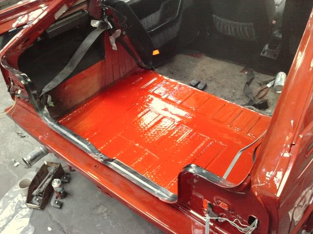

Just put a coat of rustoleum onto the bootfloor to tidy it up, had a rear shunt at some stage and was badly repaired/painted, all sorted now.
Bring on the bodywork! And lights! And windscreen in! And alloys...and painted calipers...and a full polish......and stereo installation.....feck still a bit to go.

here are some before pics, as she was being pulled down-only had the car a day before it blew up, so no pics of her as one piece. You get an idea of the paint etc though!
