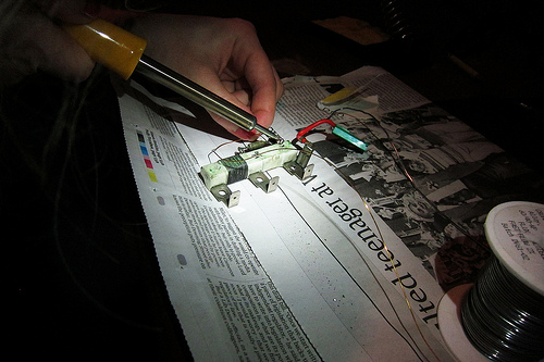

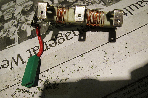

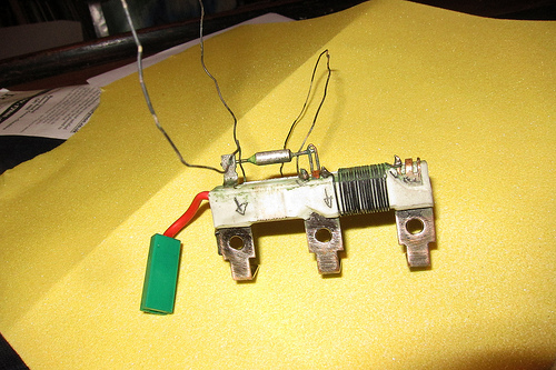

And the major success of last night was fixing the blower. It only worked on the fastest speed, traced the fault
back to the connector block/resistor on the blower housing.
IMG_3992b by Wooscary, on Flickr
Obvious break in the wire.
IMG_3993b by Wooscary, on Flickr
Holly solders the first new section of copper in.

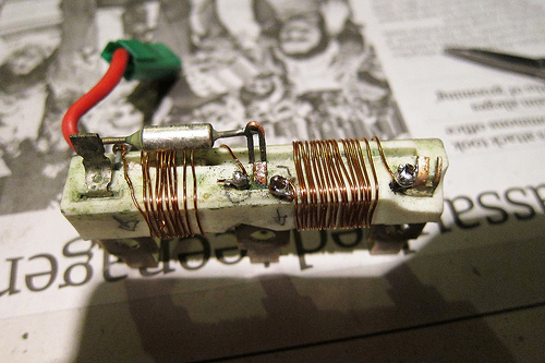

And all wound back up and soldered in place.
It now works perfectly. :D
