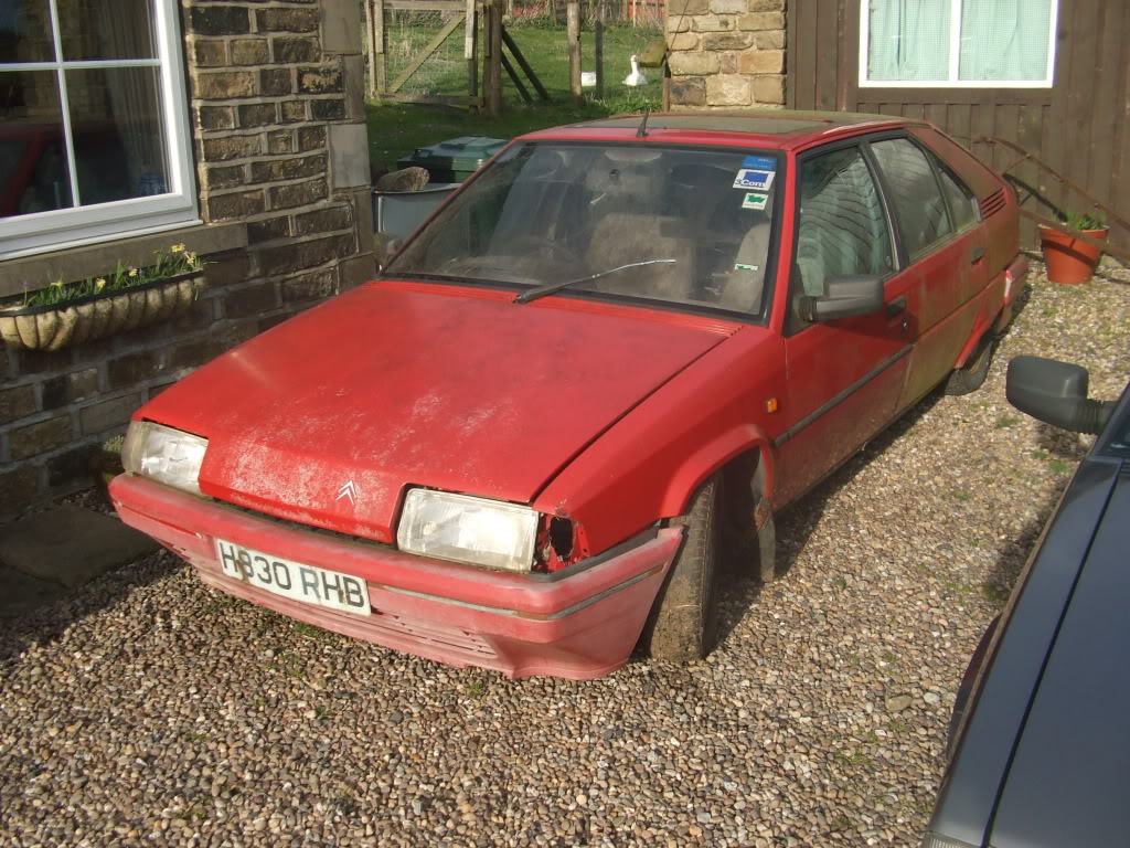

Its off to the crusher soon so anyone wanting parts please drop me a message. Up and running and at the moment can be heard so.Pumps up and drives. Been sat in an orchard/garden about 8 years after failing its test on rot so its well beyond saving. Im going to take the removable panels off. Interior is wrecked but may yield useful bits and bobs.
