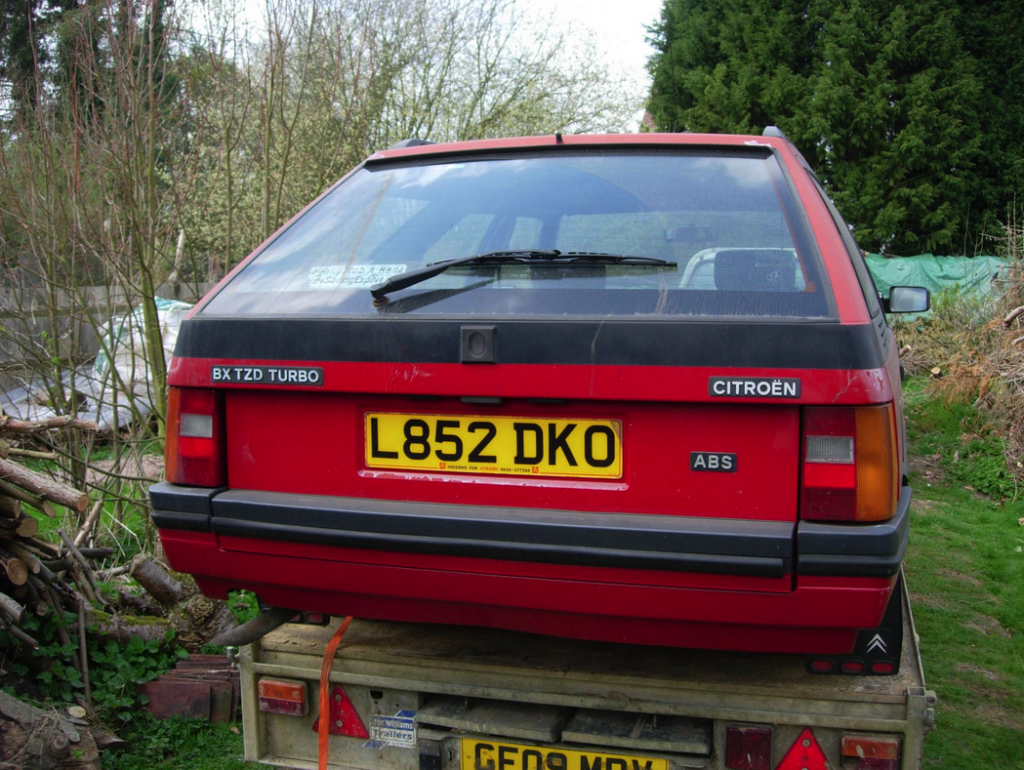

If it's any help, Andy here's the pic off Facebook:

Oh, and it's too good to kill.... isn't it? :)

its a bit tatty in places, some of the varnish coat or whatever its called is peeling in places but for 100 quid i think it may be worth saving. Tyres are good too, has new front disks and pads.
Has to be worth saving. It's even got rear mud flaps!

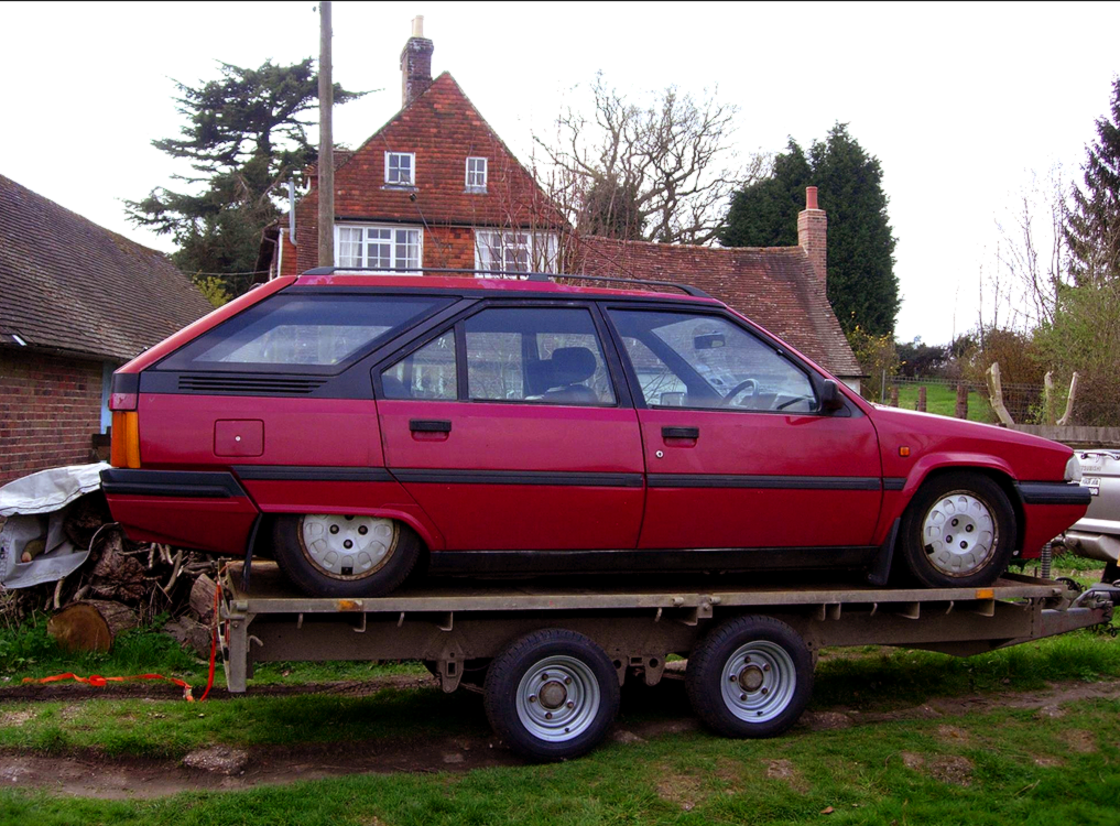

Here you go Andy - as requested:

Dollywobbler wrote:Has to be worth saving. It's even got rear mud flaps!
With values rising, now's the time to save the better ones while they still exist. The number of survivors is only going to diminish.
Its even got front mudflaps too so defo worth saving. :lol:
