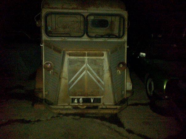

Finally, on a different note, the (partly) straightened nose now fits the H!
