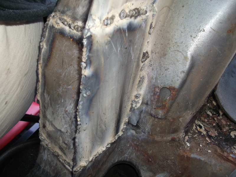

Managed to upload Thursday's pics at last!
Started with an easy one - finishing off the C post!

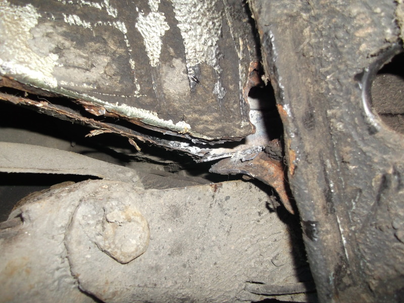

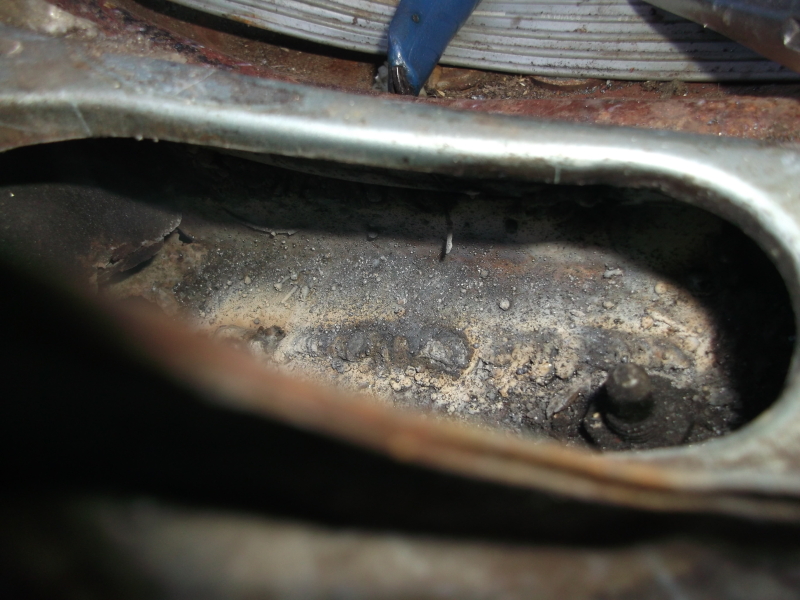

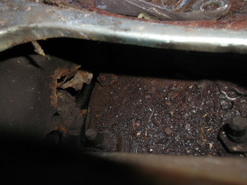

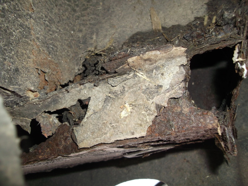

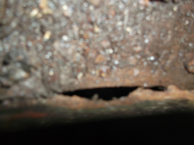

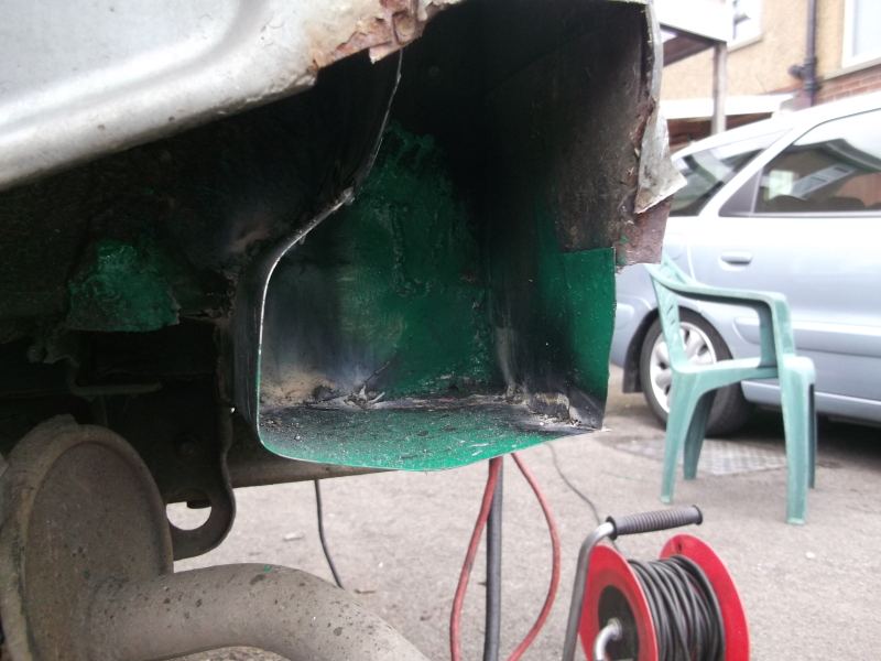

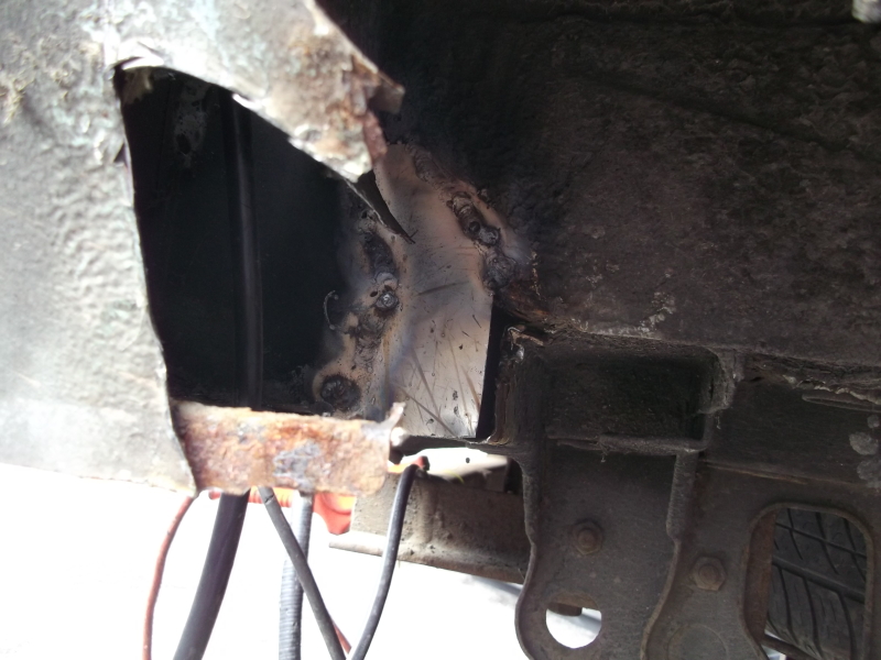

Then came the tricky bit - the metal surrounding the subframe mount was rotten, but I didn't have time to drop the subframe:

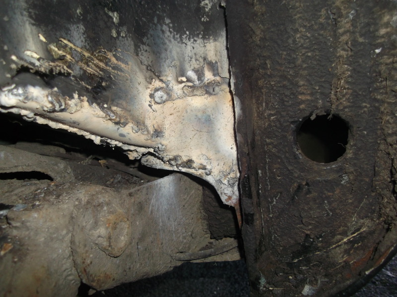

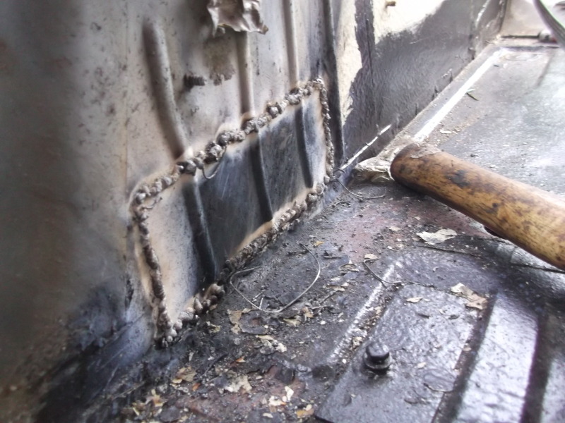

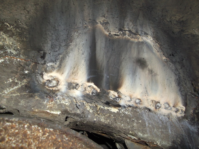

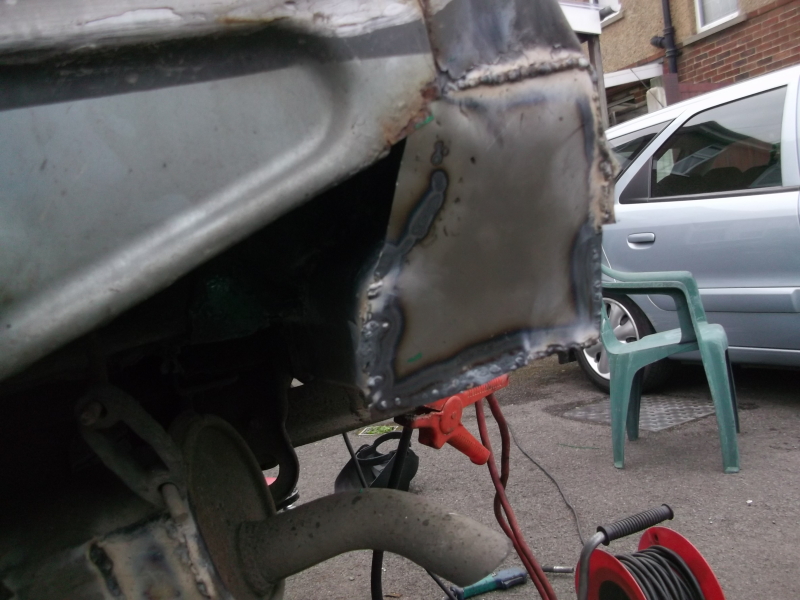

What I've ended up doing is what amounts to a semi temporary repair that should last until I take her off the road for some major work once I have the bodywork completed on the GS (hopefully early spring). First I slipped in an angled repair piece for the inner most face and 'keyhole welded it' from the access hole above and from inside the arch:
I then slid in and welded up a patch on the underside of the 'chassis rail'

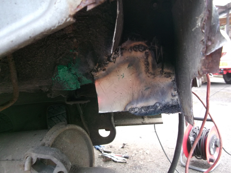

Before closing off the inner wing area:
Because of the restricted access, I couldn't remove all the rusty metal, so this comes under the heading 'MOT bodge' I'm afraid, but it should last as long as I need it to, after which it will all be cut out and done again properly.

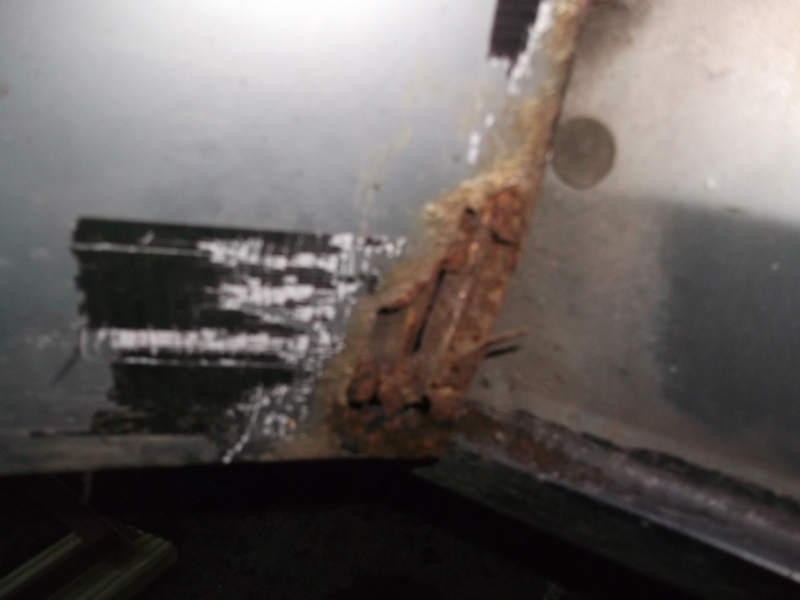

Next came repairs to the double skinned part of the inner wing, which I cut back to good metal:
A quick roller change on the swager enabled me to easily make up the inner section and weld it in:
The outer section was then repaired after the inner faces of each skin were painted:

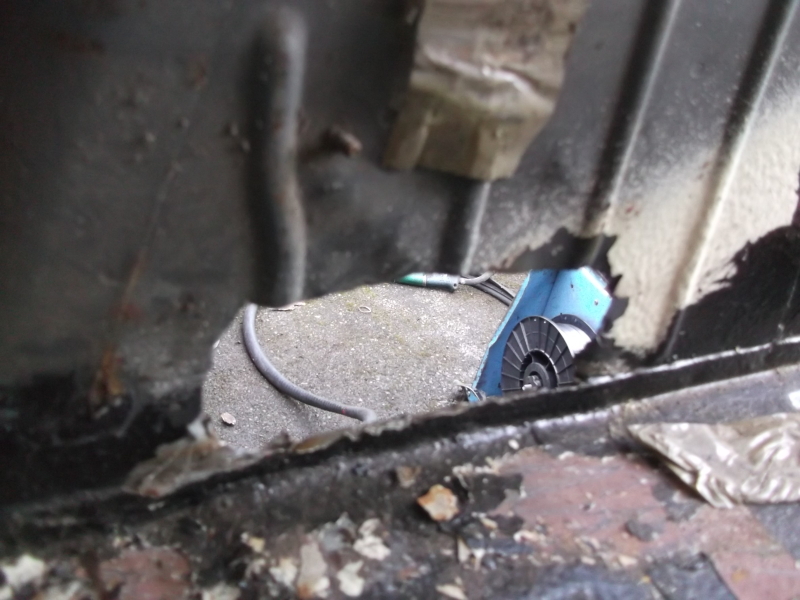

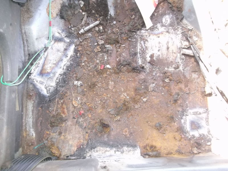

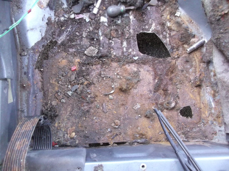

Final bit of welding for that day was the passenger side rear footwell, which was previously repaired, but in very poor condition. This is the area with the worst of the rust cut out:
I then simply plated over these holes, as this is another area I plan to revisit, cutting all the old repairs out and replacing it with new metal, shaped like the original section:

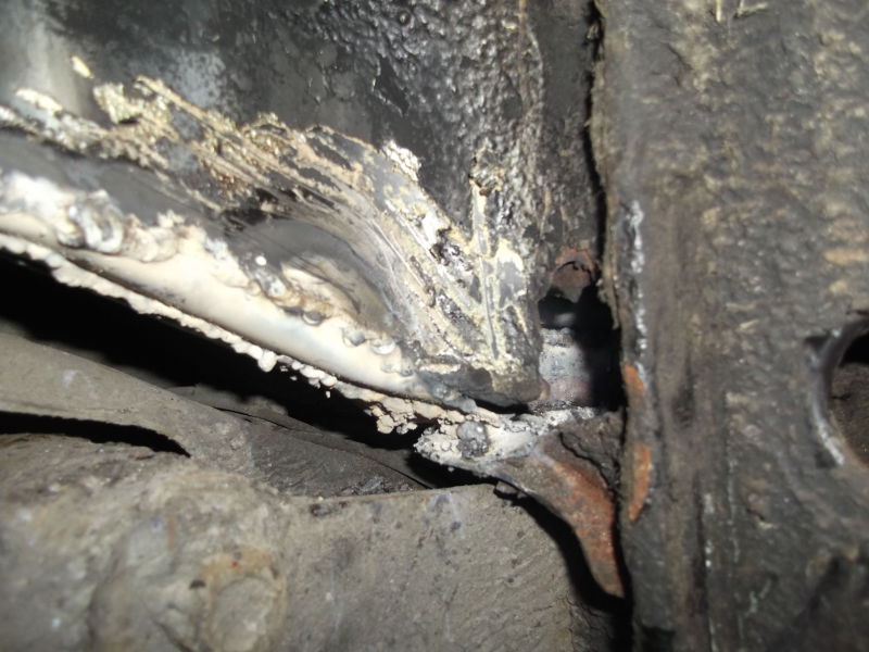

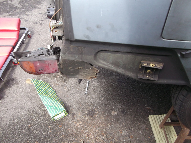

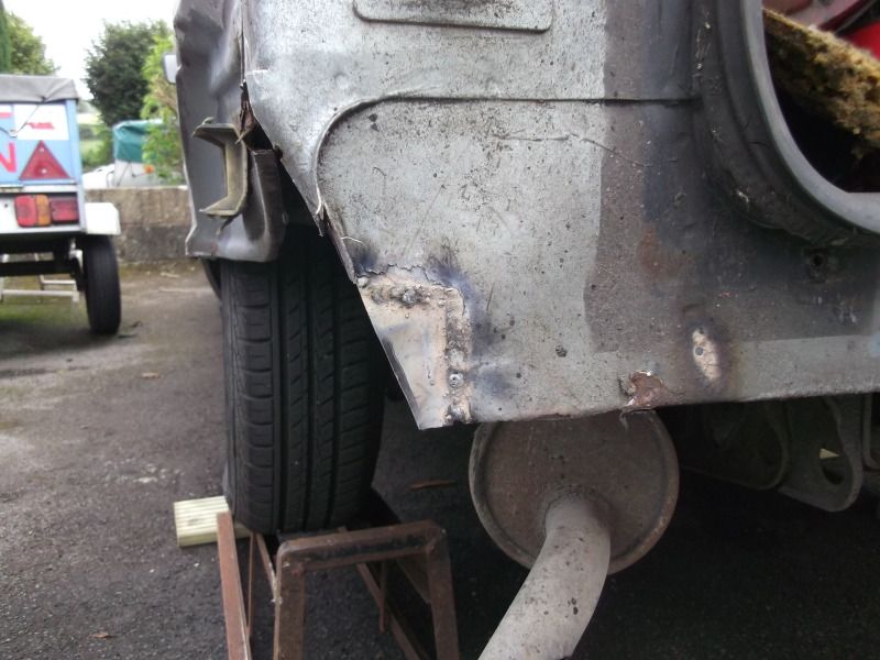

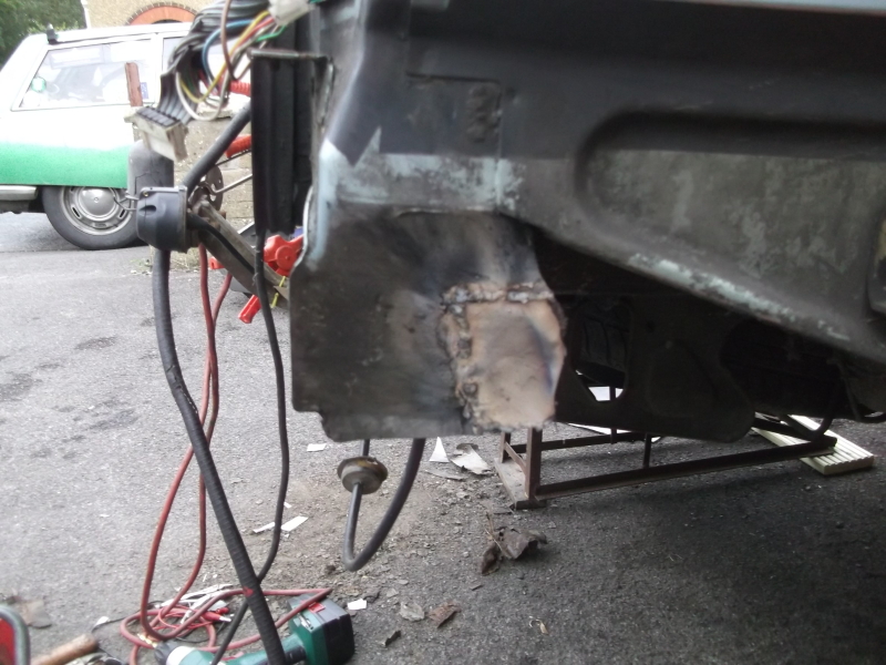

Sorted out a load of the MOT issues today, starting with the rear crossmember:

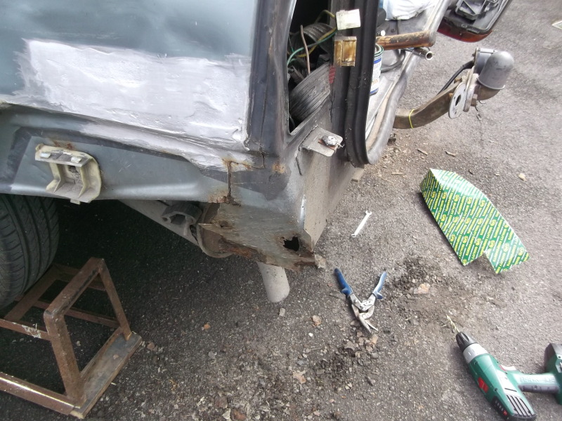

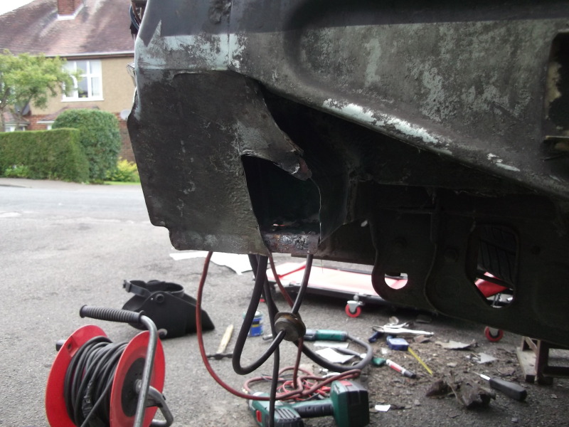

Removal of the rear bumper showed the full extent of the rot - not as bad as it could have been
After cutting all the rot out, I started by repairing the internal dividers:
The rear panel only needed a small repair:

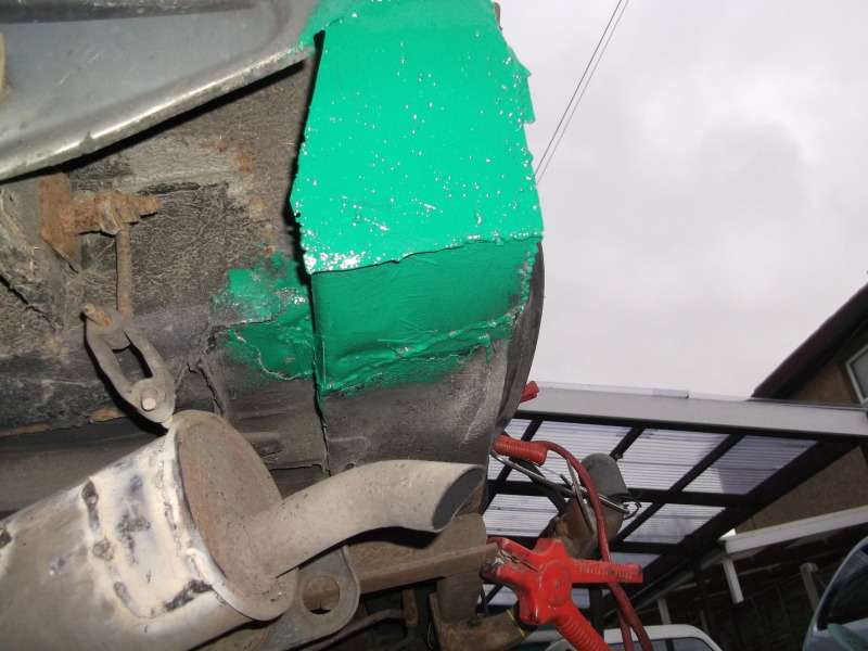

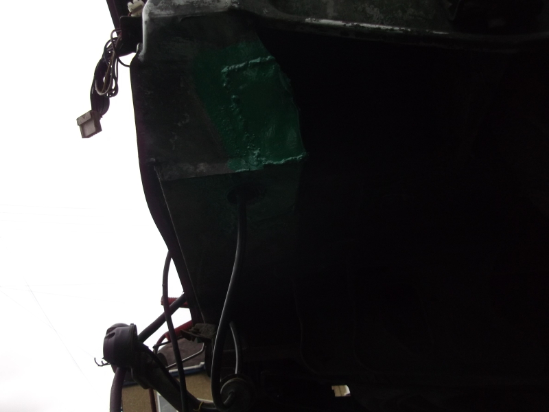

Then I made up and fitted repair pieces for the crossmember. I changed the design slightly, removing the horizontal joint flange that was a rust trap

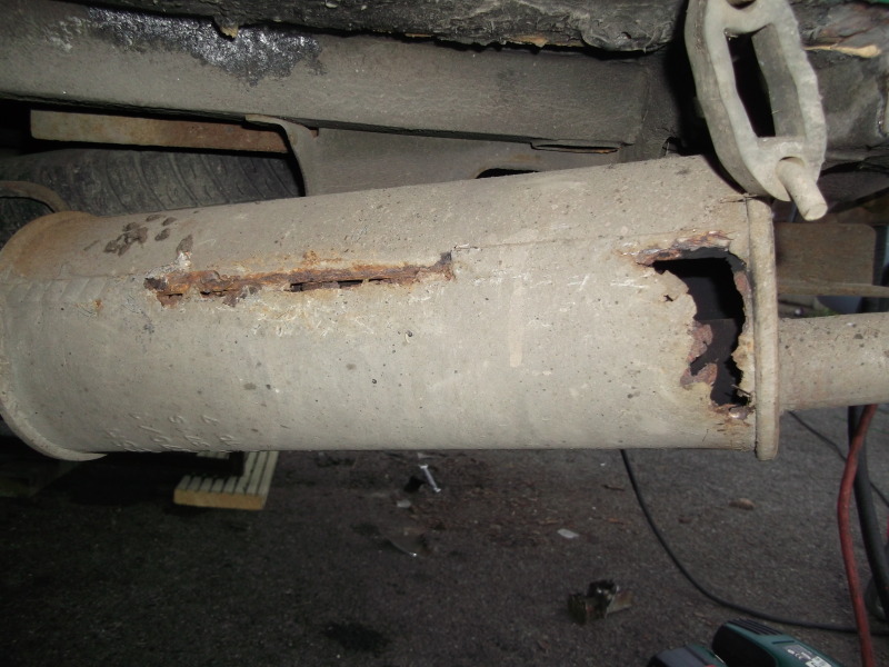

It was while doing this that I spotted that the back box needed repairs - a couple of quick plates sorted that out:
Making and fitting a new closing panel one side and repairing the panel the other finished this stage of the welding, which was then painted and undersealed:

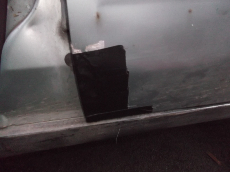

I then attacked the doors with a hammer and wire brush to get rid of the loose rust, then taped over them as a temporary fix for the MOT:

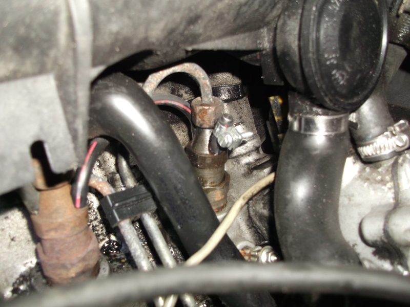

Finally the bolt capping off the fuel leakback pipe was replaced with a piece of bar and a clamp:
