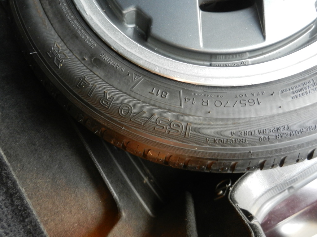

I've got a set of these with 165/70 on which are the same as the ones on my steelies, haven't fitted them yet so can't comment on the ride or grip

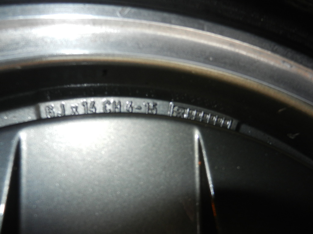

Are you saying you have 165 tyres on 6J rims?TizzyD wrote:I've got a set of these with 165/70 on which are the same as the ones on my steelies, haven't fitted them yet so can't comment on the ride or grip
If you haven't fitted these to your car yet there is only one word you need to remember... DON'T!
Those tyres are not wide enough for the rims.
Please for your own safety double check... there were other speedline rims which look exactly the same, but were 5½J, and only these are good to use with 165 tyres. On 6J rims, you need a minimum of 185 width.

What would happen if I fitted them ? As they came off an Athena.
smiffy1071 wrote:Are you saying you have 165 tyres on 6J rims?
- Posts: 11594
- x 25
Re: BX GTi Speedlines on eBay
165 profiles on a 6" rim? Not recommended AFAIK. Those tyres came off an Athena? They'll come off something else too

Hang on a sec chaps! Tizzy bought them off me, they came off the Athena and have the original tyres that Will had swapped from his steelies to them.
To say they are "Dangerous" is stupid, they are PERFECTLY fine and safe and they are NOT too narrow for the rims AT ALL! They are not Stretch-Fit or whatever the VW boys do theses days so do me a favour and stop scaremongering.
The minimum and maxumum tyre widths for a 6J rim are: 155mm to 215mm, although the accepted standard is 165mm to 205mm
