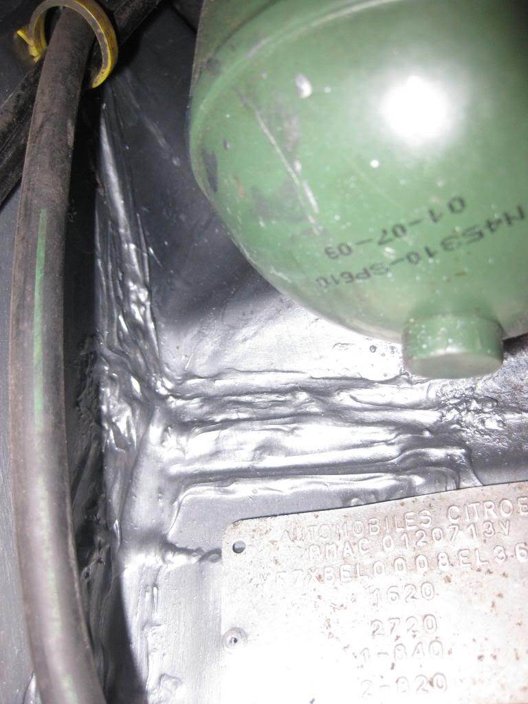

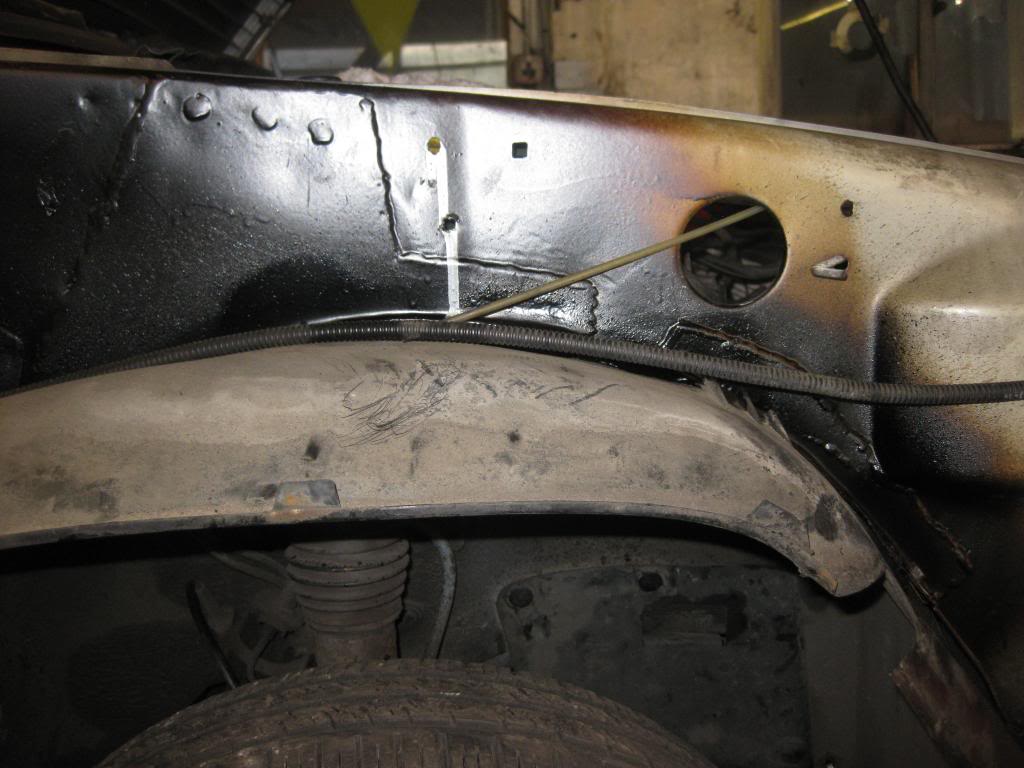

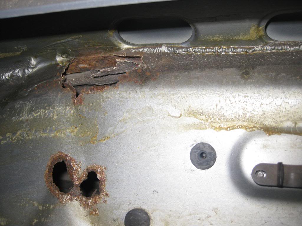

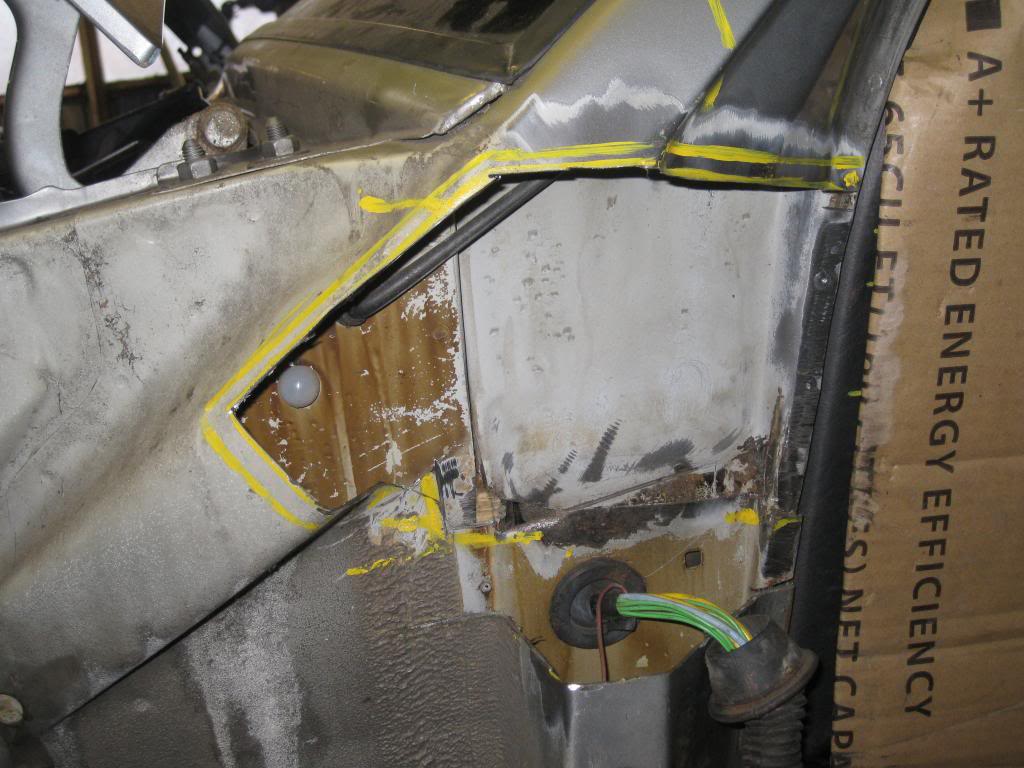

Thanks so much to everyone i've finally managed a picture . This is the repaired os inner wing.
The other side of the repair.

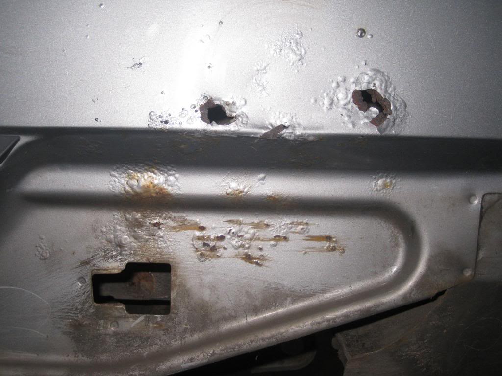

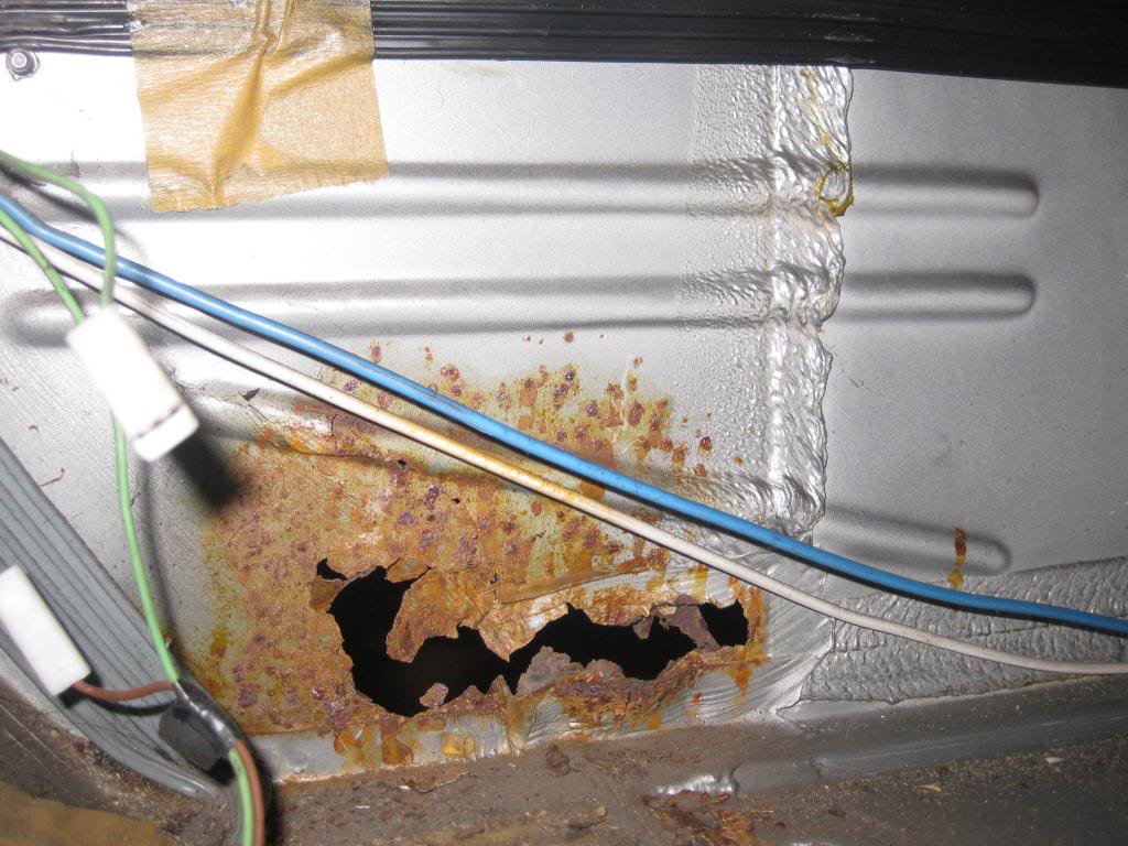

Os quarter panel perforated
Ns quarter panel perforated
Exhaust hanger
Nsr chassis leg
Osr inner wing

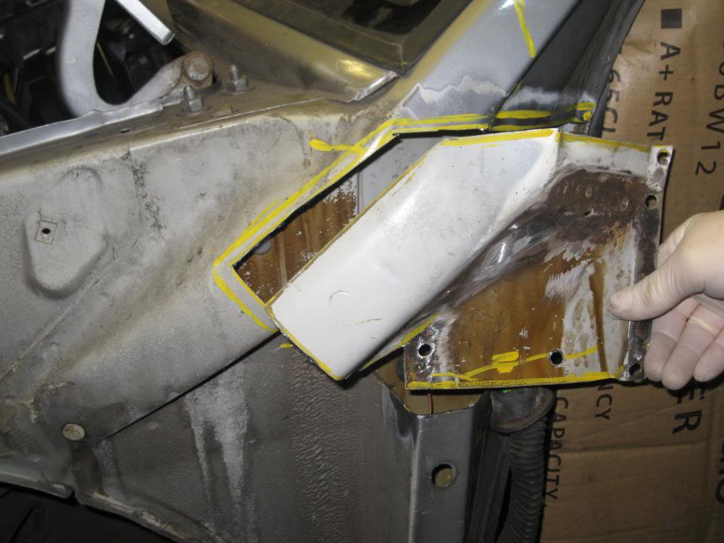

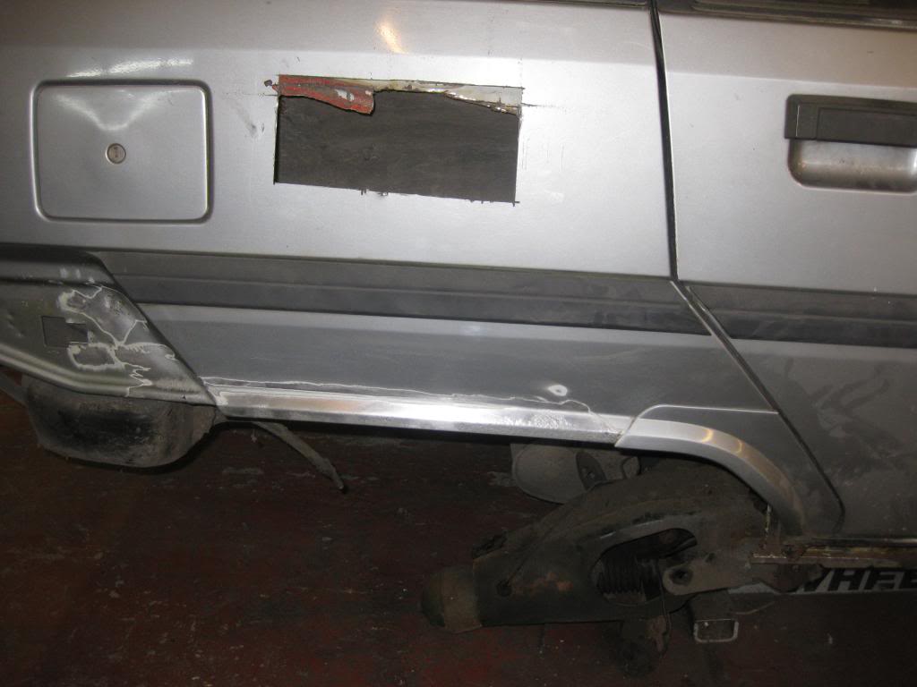

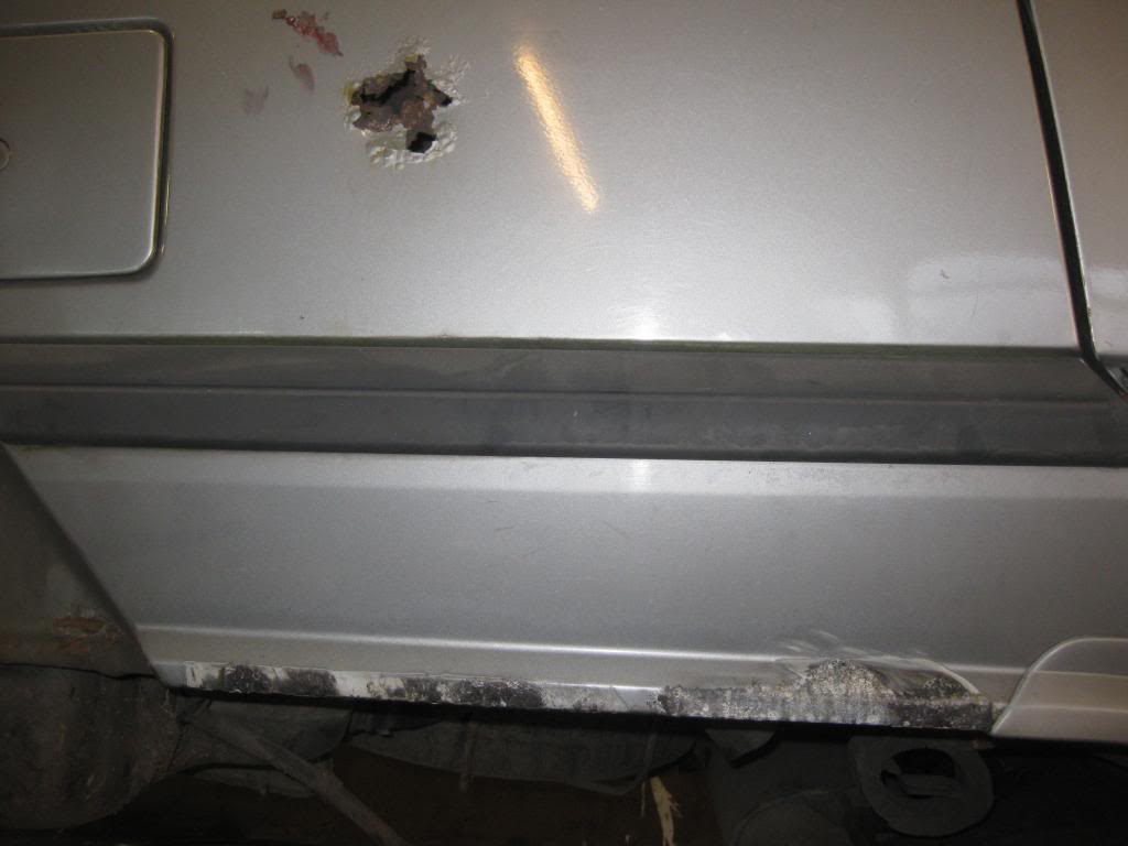

This is the osr quarter with a hole cut into it to repair the outer and gain access to repair the inside. The wheel arch has come up fairly well with deox

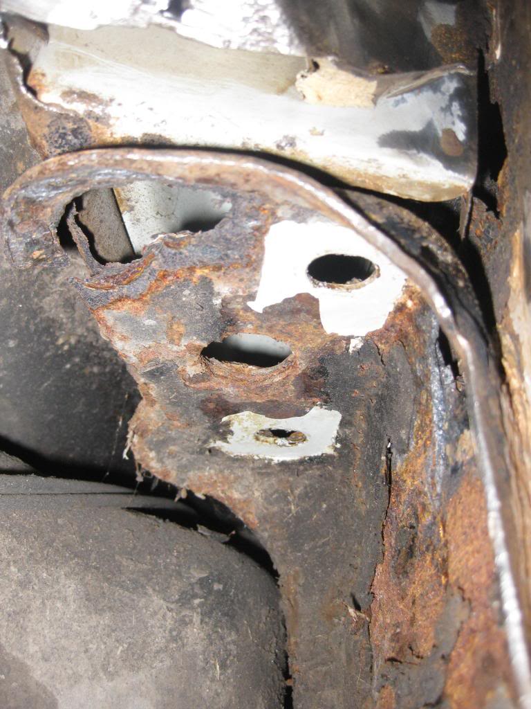

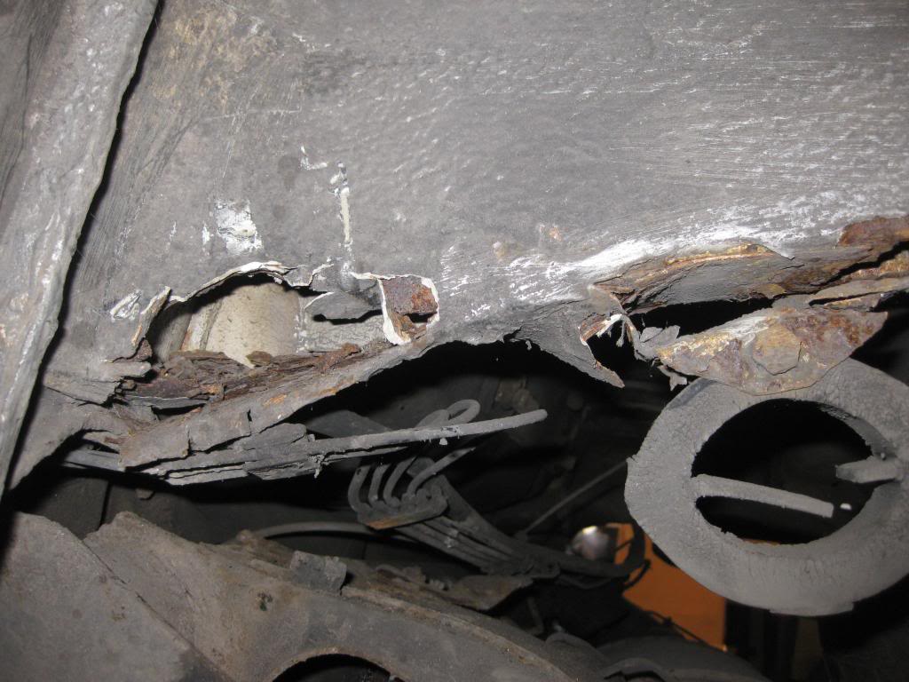

This is probably the worst single part, the rear subframe offside front mounting. If i'd seen this before i was so far into it i might have changed my mind about fixing it. A lot of this looks a lot different now having undergone a lot of cutting out and two weeks of daily applications of deox.

Amazing repairs, ironically the piccy that shows the bumper mounting point is in perfect nick, just the rest of that panel is bubbling up. Mine has the rusted up mount bit & thats why my rear bumper doesnt hang as well as it should, the rest of that panel on mine is in better nick than your piccy.
I suppose the way to look at it Barry is that once you've done all this graft, you'll have a car that'll be able to do another 20 years before it gets in it's current condition again, i take my hat off to you sir Great job.
Christ, those rear wings and chassis rails look worse than Timex . Some great pics there though - I have some similar jobs to do in the future. Well done
I've got a little bit of bubbling behind the filler flap - at least any repair can hopefully be hidden if it's not invisible! Looks like you're doing a good job; getting back to shiny steel is the only long term solution.
Yes, good work Barry. I just looked up that Deox stuff - looks quite good.
