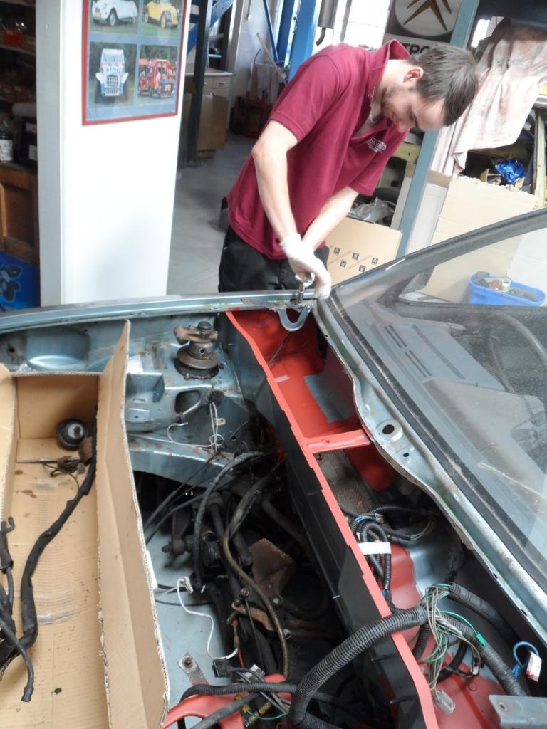

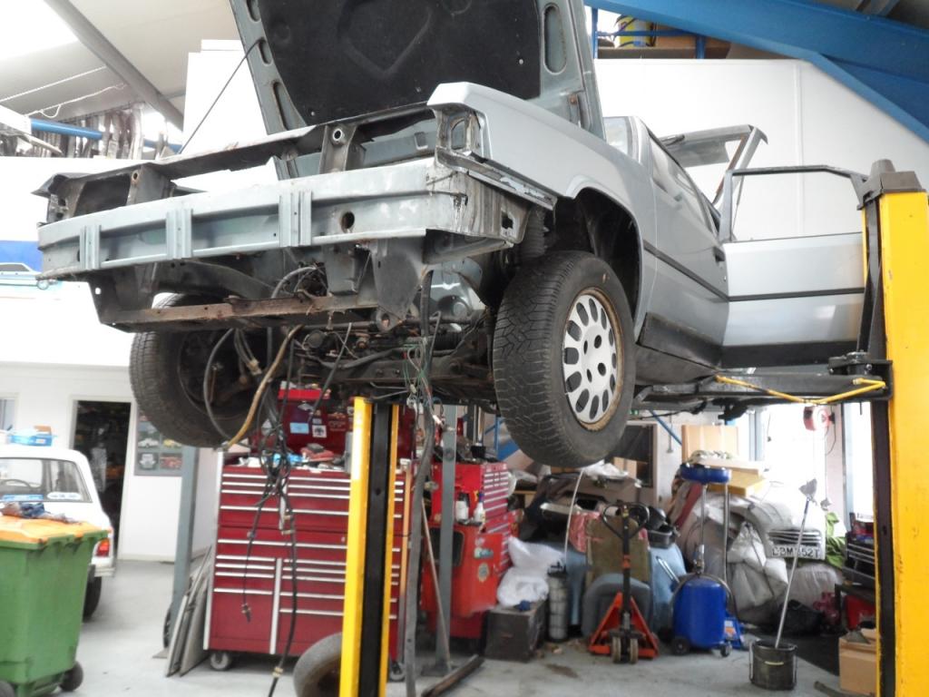

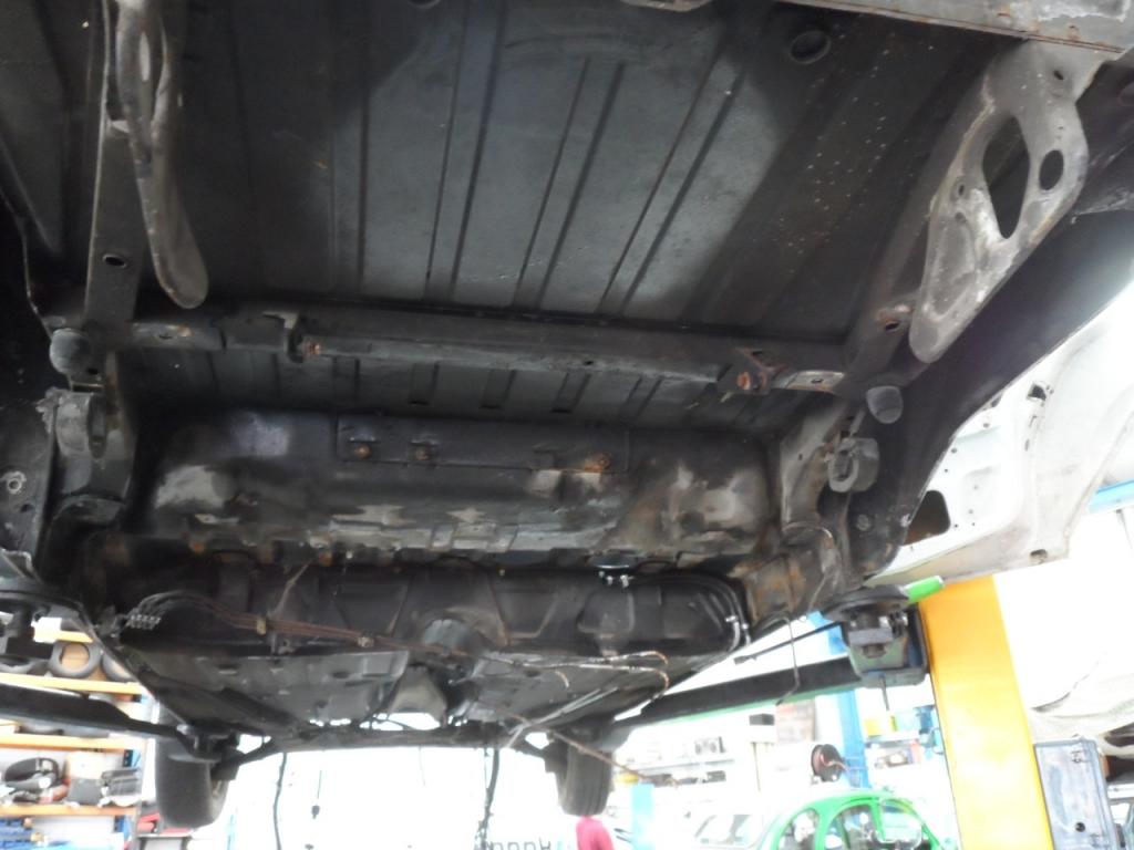

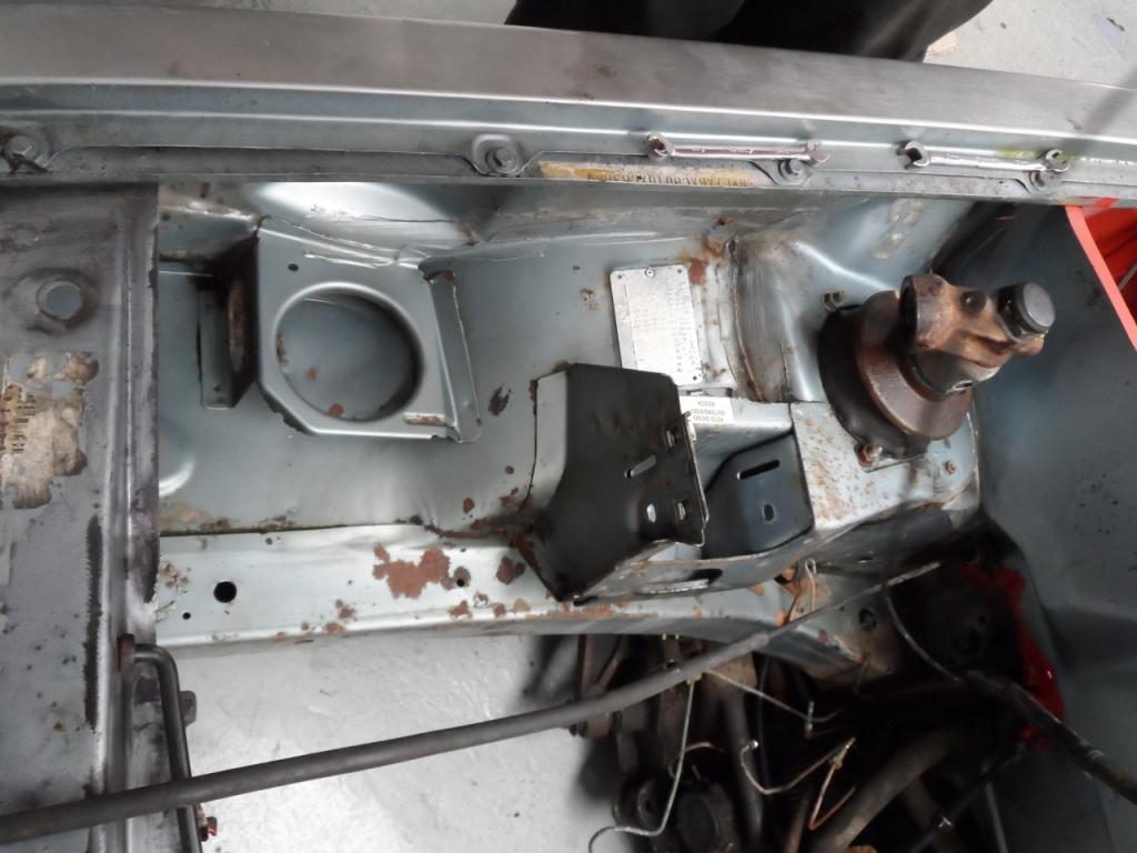

Work has now started on Mollie. Engine is now out. Front end looks pretty good for a 29 year old motor. Not bad for a motor that was given to me!!

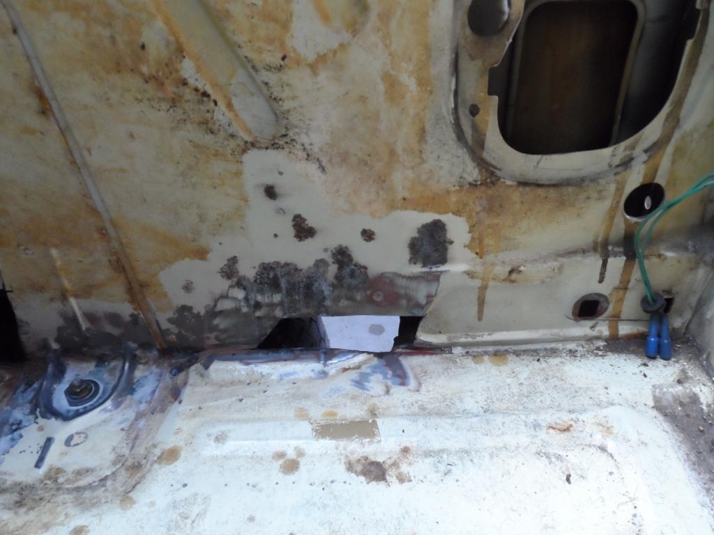

The underside looks amazing now that the rear subframe has been removed.

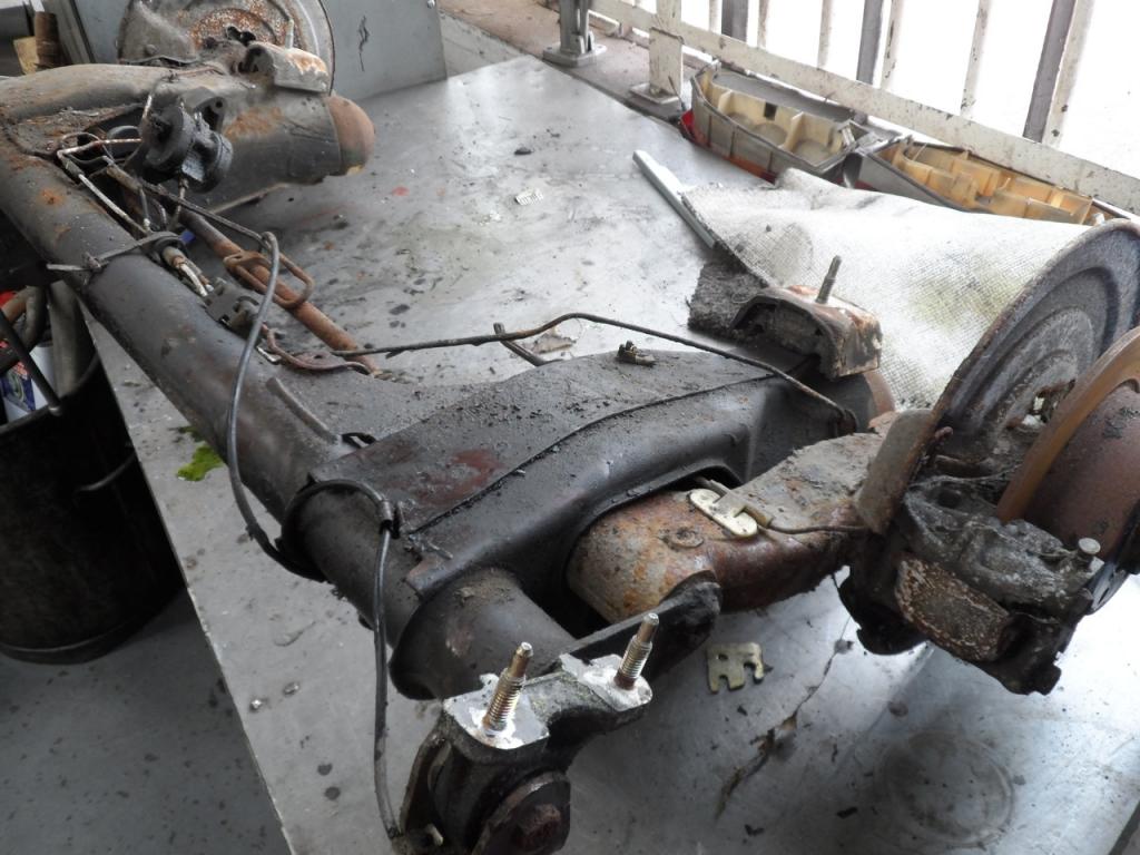

Rear subframe removed for cleaning.

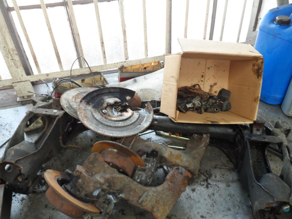

All the bits from the rear end now off.
Front subframe now being removed, all the bits will go away to be sand blasted and powder coated and the first welding will start on Elsie the GSA in the next day or so.

Wow! thats solid.

Don't get the subframes powdercoated Andy, it'll just all flake off again in a few years as there are so many rough edges on them. Go with POR15 or something. Or if you do go powdercoat, at least get it thermally zinc sprayed first.

I'd be more tempted to use a marine quality 2 pack epoxy paint. These are suitable for steel and aluminium substrates. If they keep the sea at bay, then that is much harsher than most roads, even with winter gritting.

A few more pictures, the work continues.

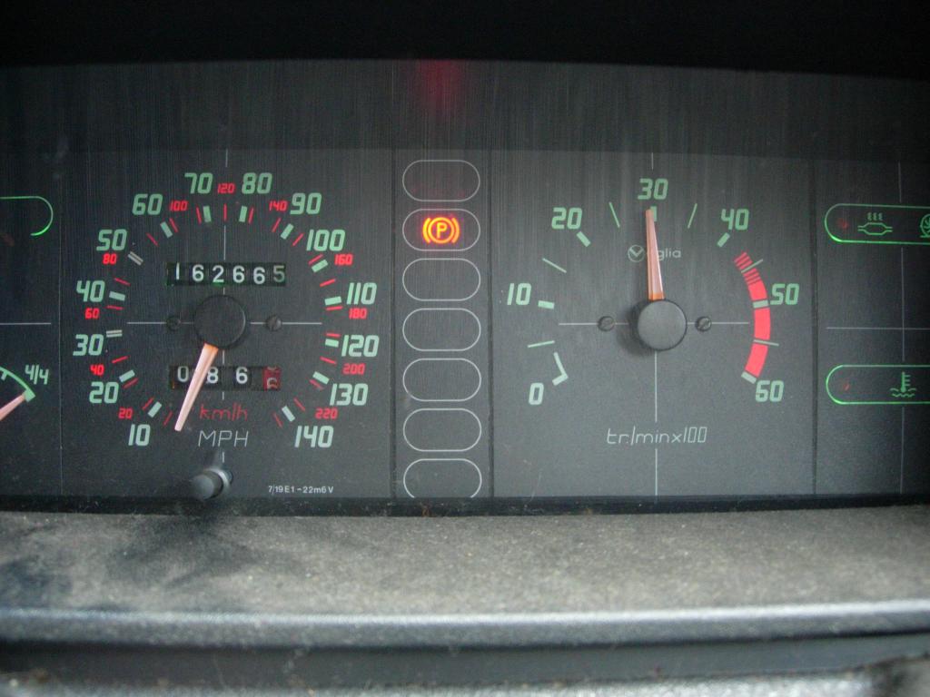

And the TZD has a fully working rev counter WOOOOOHOOOOOOO!!

Shes a solid old bus.

Yep, it looks good, and those arch repairs look nice and straight forward too.
